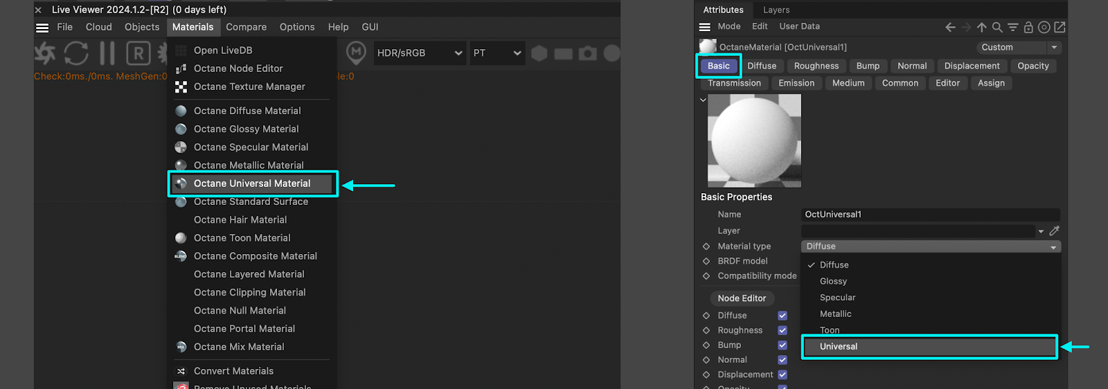

Octane has several different types of materials, all of which can be accessed from the Live Viewer window under Materials>Create. There are a lot of them, and most of them are still there for compatibility with scene files built in earlier versions of Octane.
The Universal Material is one of the more recent-ish additions, and it replaces the need for just about every other material type in Octane moving forward. This guide, and most of the others will focus on this material type because it’s extremely versatile - we can make any type of material with it quickly and efficiently.
We can convert most other types of materials (Metallic, Glossy, Specular) to a Universal material by selecting it in the dropdown in the Basic tab of the material (or at the top left of the material properties in the node editor).

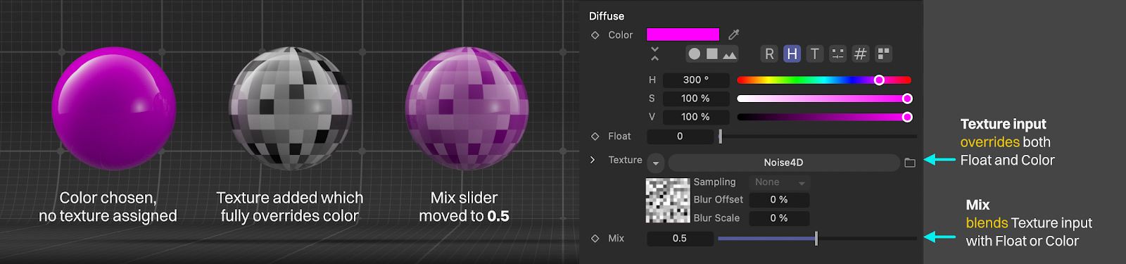

Channel Contribution
All channels have one or more possible inputs that describe how much that particular channel contributes to the overall material. The UI across all channels usually boils down to three types of controls, and there’s a strict hierarchy of what overrides what when all three are in the same channel.
At the top of the hierarchy is the Texture Input. If an external texture (image or procedural pattern or something like that) is hooked up to a channel that supports it, that will override everything else.
If the Texture Input section has a Mix slider, then we can do a simple blend (think Opacity slider) between the texture and the color or float under it. For more complex mixing and layering, check out this guide.
Below the Texture in the hierarchy is the Color Picker. The picker is overridden by the texture, but it overrides the Float value.

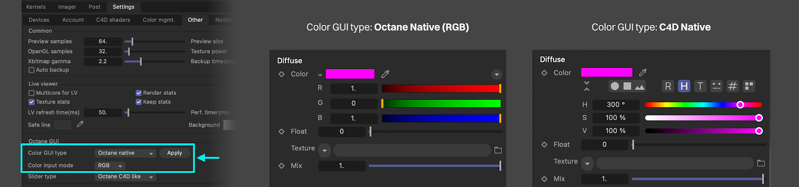

The Color Picker assigns an RGB color to the channel’s contribution to the material. What the picker looks like depends on whether we have it set to Cinema 4D Native or Octane Native . This option is found in the Octane Settings, in the Settings tab, in the Other subtab.
Bottom of the list is the Float value, and this is where things can be confusing.
If there’s no texture input, and the color picker is set to 0,0,0 (or #000000, or the equivalent of pure black in whatever mode we’re in), then the Float slider acts as a linear 0-1 slider with 0 being no contribution, and 1 being full contribution. This isn’t super useful in the Diffuse/Albedo channel because we usually want nonlinear visual color values, but it’s good in the Specular channel if we want to make the material more or less glossy.
Important: If the Color Picker is set to ANYTHING other than black, and/or there’s a texture input, the float slider will do absolutely nothing. There’s no blending between the Color Picker and the Float value - it’s an either/or situation.

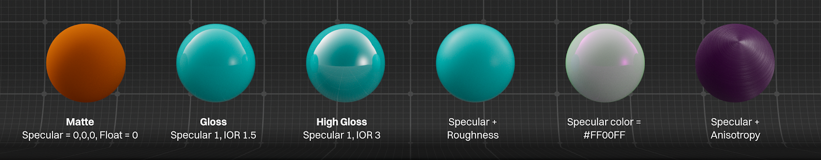

Step 2: Is the Material Opaque, but Not Metallic?
Matte and glossy materials include wood, plaster, opaque plastic, fabric, etc.
For these types of materials, we need to make sure the Metallic Channel is set to have no contribution (metallic=0). Then adjust the Albedo and Specular channels to determine the color, pattern, and how glossy the material is.
If we’re making a fully matte material, we need to set the Specular to 0, 0, 0, float 0.
Important: The float of 0 is key - The specular channel defaults to 1, so if we’re not used to looking at the float it, we may end up changing the color to black and still wonder why the material is glossy.
If we’re making a glossy or semigloss material, the IOR (Dielectric), Roughness and Anisotropy channels will control the look of the reflection. The Specular channel can either be white to just have a clear gloss, or be tinted by adjusting the color. A texture can also be fed into specular to break up the glossy look (like for wear and tear or patterning).
Important: The color impacts how glossy the material is. Colors with a high Value (V in HSV) are shinier than ones with a lower V, and certain colors like yellow appear shinier than others like indigo.

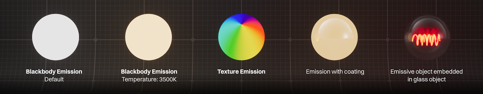

Step 3: Is the Material Emissive?
Does it generate light? If so, we’ll want to start by bringing the Albedo, Metallic, and Specular channels to 0,0,0, and make sure the floats are also at 0. Those channels can muck up emissive materials, and most of the time we want them to have no contribution.
After that, we need to decide how we want to control the color and other properties of the light. We do this by adding either a Blackbody Emission or Texture Emission node into this channel and adjust the settings in the Emission channel.
Emissive materials in Octane usually look pretty nice with Bloom/Glare, so we’ll want to be sure to set that up in the Imager.
If we want the material to look like a frosted light bulb or glowing plastic, we can add a Coating (Step 9) or embed the object with the emissive material in another piece of geometry with a glass texture.
Important: Emission is one of the main causes of fireflies, artifacts, and overall stress and rage in 3D. It’d be worth reviewing the lighting and emission guide to understand how that all works.

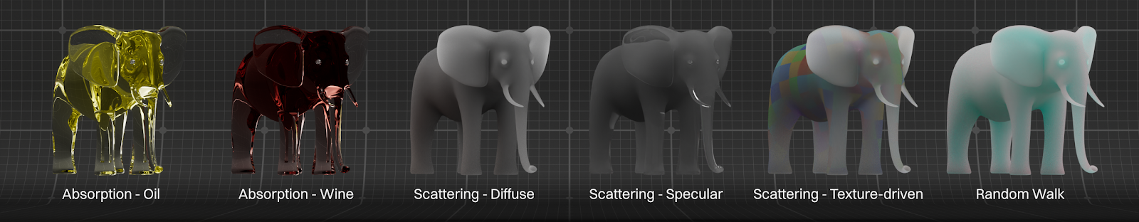

Step 5: Does it Need a Medium?
The Medium Channel works in conjunction with the Transmission channel to create Subsurface Scattering and Absorption effects. These are good for plastics, liquids, skin, and anything else that’s semi translucent. Scattering in particular really beats on the GPU, so make sure we want to be absolutely sure that we need these effects and our scene will show them off. More on that in the Channels Deep Dive and Volumetrics Overview guides.

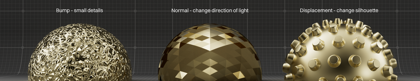

Step 7: Does The Surface Have Depth?
The Bump, Normal, and Displacement channels all determine what the surface of the object looks like. These seem straightforward, but there’s a lot that goes into them. Check out the bump and normal guide & displacement guide series for more.

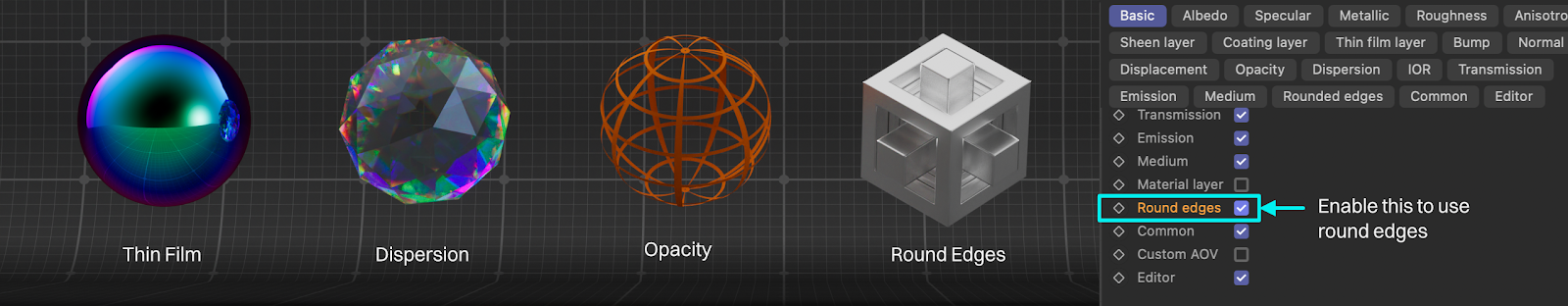

The Thin Film, Dispersion, Opacity & Round Edges channels produce specific effects on the material or geometry.
Thin Film is responsible for iridescence, and works best with metallic or very glossy non-metals.
Dispersion gives a rainbow effect caused by imperfect refraction.
Opacity is for fade in/out effects like a transporter, holes in a thin surface like paper, or intangible objects like a hologram. It is NOT for glass - that’s what the Transmission channel is for.
Rounded Edges is a render-time effect that rounds sharp edges and is good for adding just a bit of realism to overly sharp geometry. This channel is hidden by default and needs to be enabled in the basic channel if we want to use it.

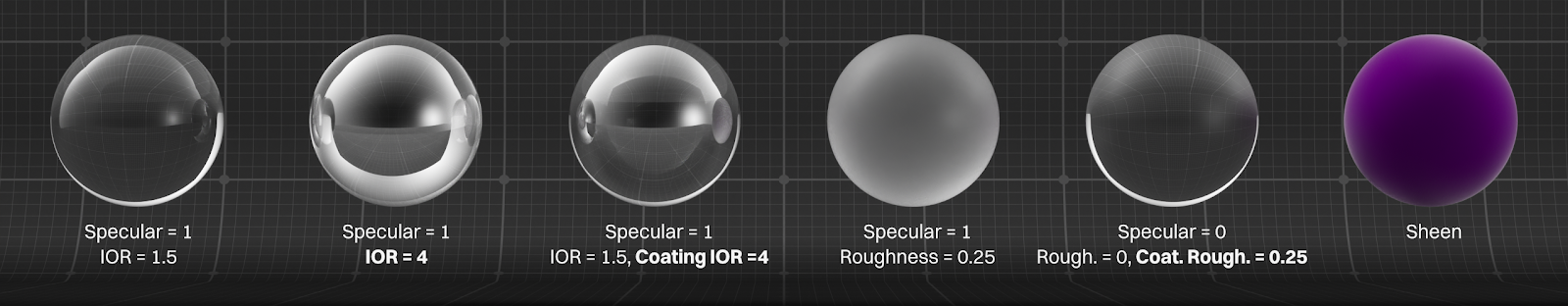

Step 9: Does the Material Need a Top Coat?
The Sheen and Coating channels go over the top of everything else to give the material an extra glossy look or a fresnel-like sheen.
The Coating channel puts a thin gloss layer over the top of the material. The overall Roughness and IOR channels affect both specular and transmission, but if we use the Coating channel - which has its own roughness and IOR - we can separate that out so we’re only roughening and changing the glossiness of the reflections without messing with the transmission properties as well (as seen above).
Sheen is good for fabrics and other materials where the reflection falls off toward the areas of the object that we’re seeing flat-on. Sheen can take a texture input into its bump parameter to break the effect up.

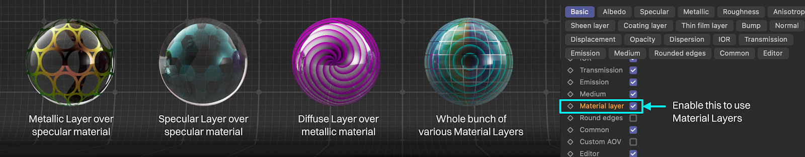

Step 10: Does the Material Need Layers?
Most material types support Material Layers, which can create some very complex multi-surface materials. The mixing and layering deep dive guide covers this in exhaustive detail.
Important: As of this writing, the material layer pin is hidden by default - we can enable it in the Basic tab of the material properties.
