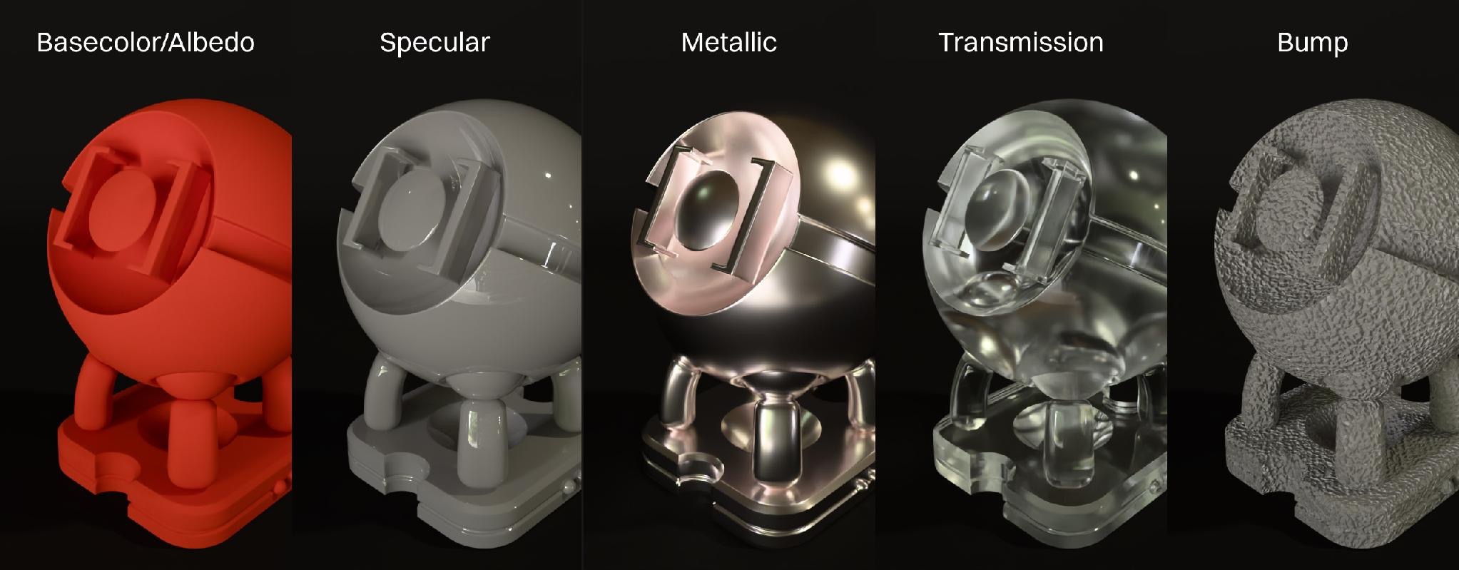

Materials in Octane are broken down into buckets of settings called "channels", each of which controls a specific type of material property. There's one for the overall base color, one for how shiny it is, one for how much light passes through the surface (transmission), etc. Each material type has a unique combination of channels, but in any two that have the same channel, it works the same way under the hood.

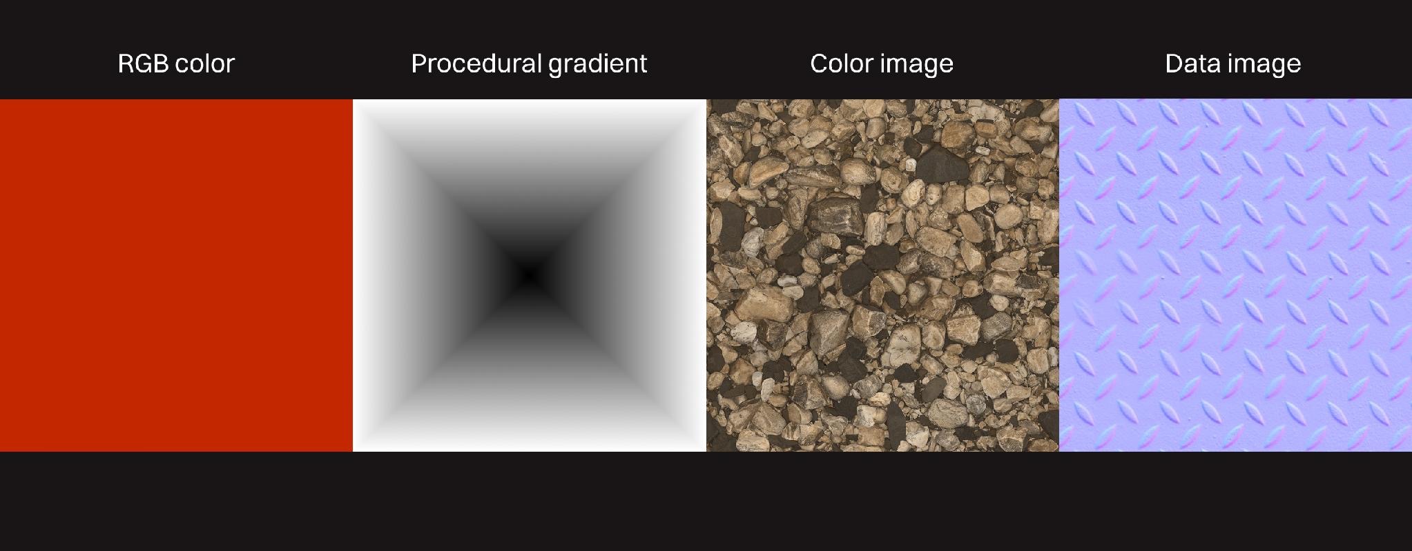

Textures are chunks of data that are fed into the channels of a material to control how they are expressed in the material. These are simple things like an RGB color or a grayscale value, or complex things like procedurally generated patterns or bitmap images in the form of TIFFs and JPEGs that you have lying around on your computer.
| Important: Every channel that is contributing anything to the appearance of a material has a texture driving it. |
Nearly all channels can have textures fed into them directly. These channels also come with default textures built in (usually either an RGB or grayscale color). A few of them require intermediate steps to further process the textures (notably displacement and emission).
Textures can be mixed, layered, and modified by other nodes prior to hitting the channel, making for a nearly infinite number of combinations to create unique effects.

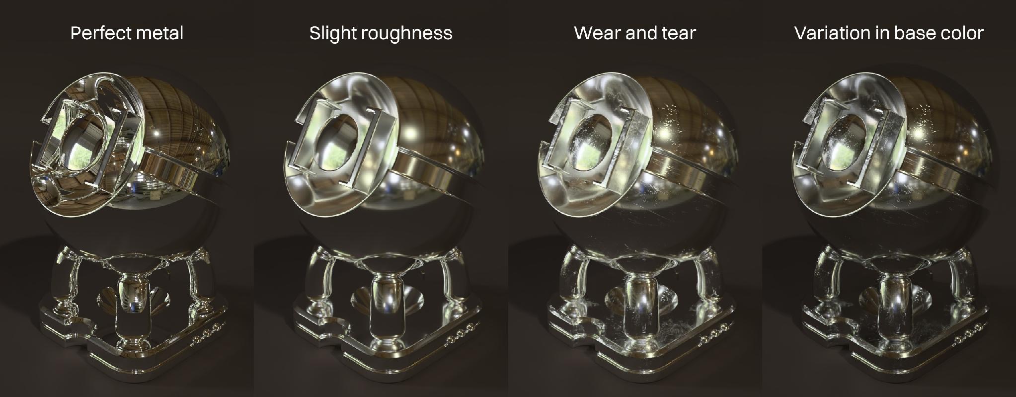

This is a good place to reference Tenet #3 - Perfection is the enemy. Perfect textures are one of the most common barriers to realistic-looking renders. Nothing in the real world is perfect, so when the brain processes something that is, it causes dissonance. There are plenty of strategies for beating up and randomizing them, and it's definitely something to think about when making each and every one.

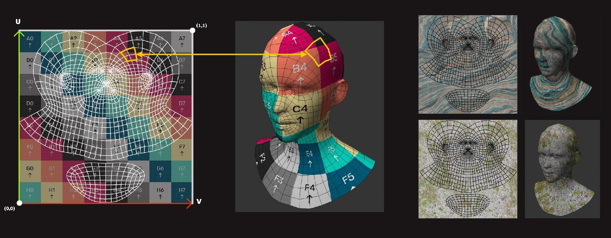

Mesh UV is the most common. This involves creating a flat map (called a UV map) of all the polygons and overlaying the texture on top. An area of the texture that intersects one of the polygons in the 2D map will also do so in the 3D model.
Of course this isn't as easy as it sounds, and there are entire guides on this site written on why that is and how to work with it, but here we're just going to be made aware that this is a thing.
