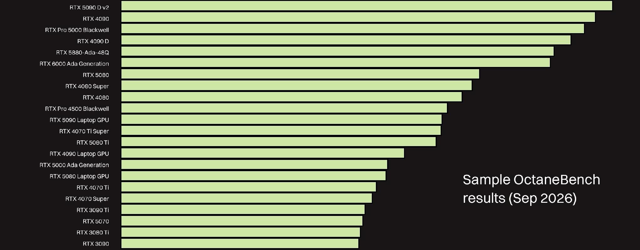

Hardware
<a href="https://render.otoy.com/octanebench/results.php?v=&sort_by=&scale_by=&filter=&singleGPU=0&showRTXOff=0" target="_blank">OctaneBench Results</a> - Shows relative power of GPUs running the same task
OctaneRender only works on a supported NVIDIA GPU, or any newer Mac that's using Apple Silicon. A faster GPU will render faster than a slower one, but that's only a very small part of the story. It's only possible to buy your way out of bad habits to a point.
There are dozens of factors to consider when speccing out a computer for Octane, many of which are covered in the hardware guide on the site.
Prices for good hardware can be heart-stopping, but just know that great results can be had on cheaper or older hardware if you get good at optimizing each scene.

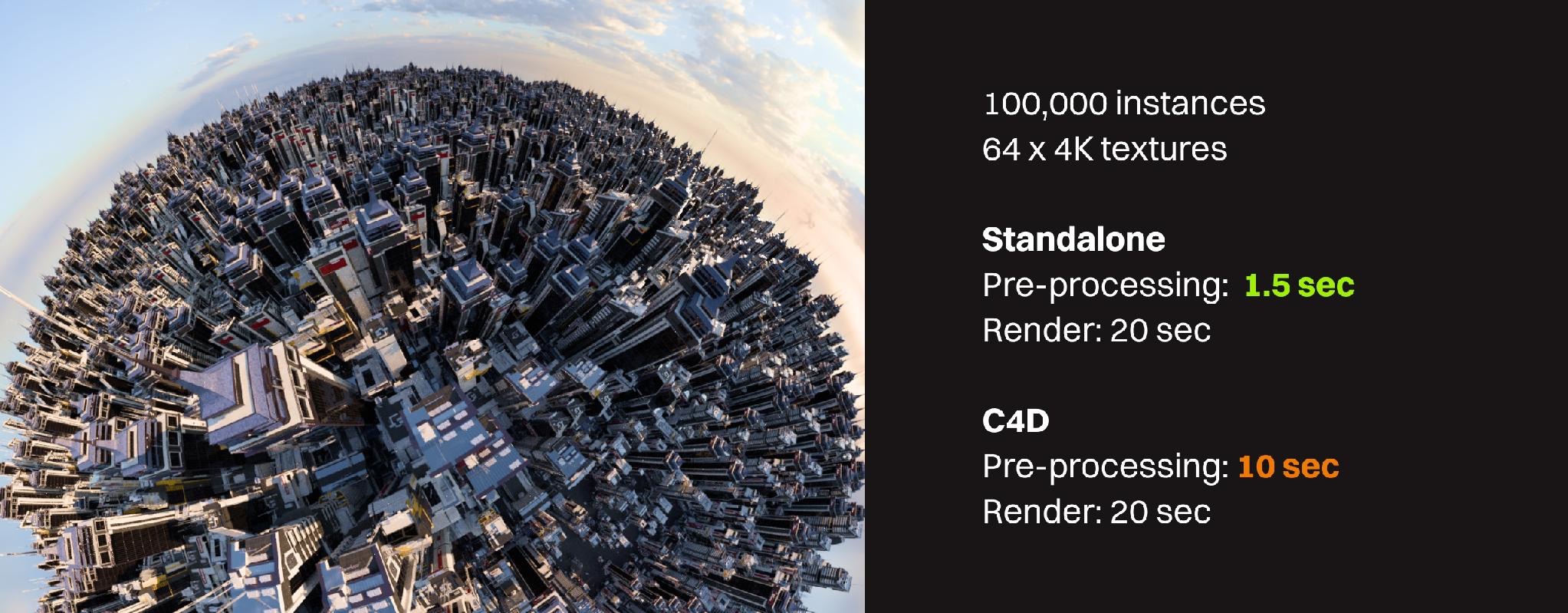

Standalone vs. Plugins
HDRI by Poly Haven, Neo Shanghai by Kitbash.
Octane Standalone is Otoy's DCC (of sorts) that runs OctaneRender. It's included with every paid subscription, but not free tier ones.
In most situations, Standalone is going to feel faster overall than any DCC plugin (Octane for C4D/Blender/Houdini/etc.). The actual render calculations themselves aren't different unless the DCC itself is hogging GPU cycles, but the overall experience is going to feel more responsive because it doesn't have to deal with all the conversion and handshaking the plug-ins are subjected to just by their nature. Things like loading in geometry, switching up material properties, altering lighting values, and tweaking kernel settings just feels a lot snappier.
Where it's not faster is when you're building out the scene. Standalone doesn't have much in the way of modeling or precision placement tools, and almost nothing in the way of animation capabilities. Other DCCs are usually custom-built for this purpose, so they'll let you iterate far more quickly. Since the Live Viewer is available in the plug-in, you'll be able to position and animate things just so to get the reflections and refractions right without having to keep re-exporting and re-importing into Standalone.
When or if to use Standalone in your workflow is very dependent on the type of work you do. If you're spending 80% of the time modeling and animating, it may not make sense to use it. If you're spending 80% of your time working on materials, it might be.

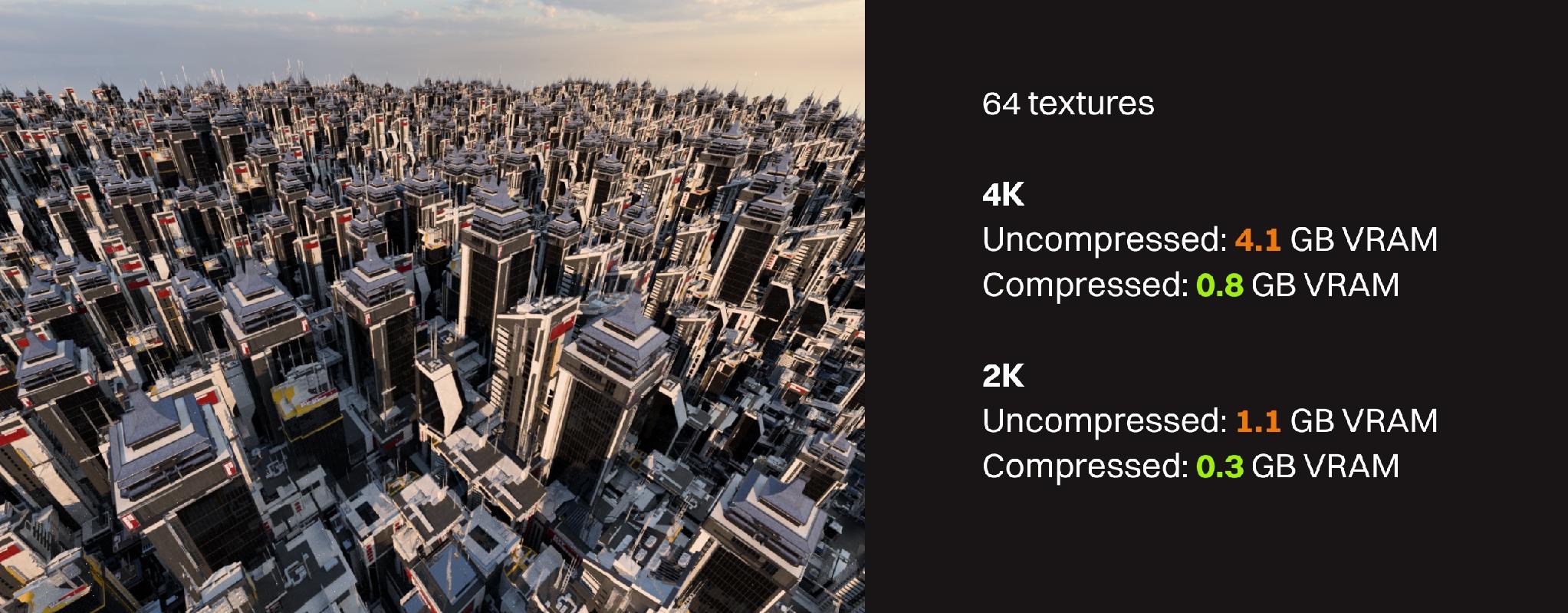

VRAM is the single most important commodity for OctaneRender. All the geometry, textures, and everything else in the scene need to fit into it. If there's too much stuff for the amount of VRAM, OctaneRender will fall back on system RAM which is far slower and takes more time to push back and forth to the GPU, slowing everything way down. The system RAM is also used to temporarily store things in the DCC, so if that runs out, it falls back on the hard disk which puts everything into super slow motion.
The biggest culprits here are the number of polygons and instances (if there are a lot of them), and the number and quality (pixel dimensions and bits per channel/# of channels) of the textures. Reducing both of these can help fit all the data into memory. Octane also features different methods of texture compression that can go a long way toward optimizing a scene.

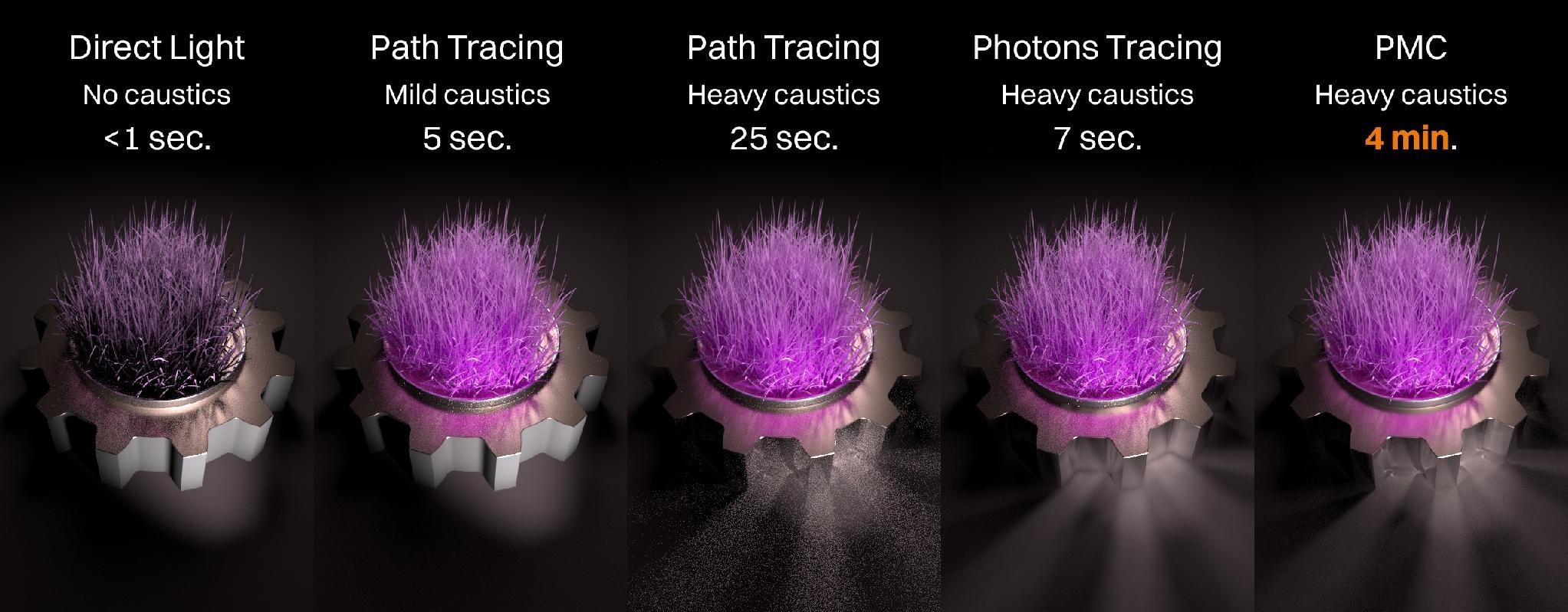

Picking a Kernel
The kernel is the main chunk of code that OctaneRender uses to render scenes.
- Direct Light is the fastest, but least realistic. Use it when starting a scene to get a quick response time while placing objects, or in a non-photoreal scene.
- Move to Path Tracing when it's time to see what the light is really going to do (assuming you're after realism).
- For scenes where caustics aren't a large contributor, it's usually better to stick with Path Tracing or DL. If caustics are a key part of the look, Photon Tracing will speed up the scene dramatically. Photon Tracing's caustics are biased, so there will be some tradeoff in realism, but the enormous speed gain is usually worth the tradeoff.
- PMC is for those times where only the absolute best unbiased caustics calculations will do, and you have a few seasons of your favorite show to catch up on while you're waiting for it to finish.

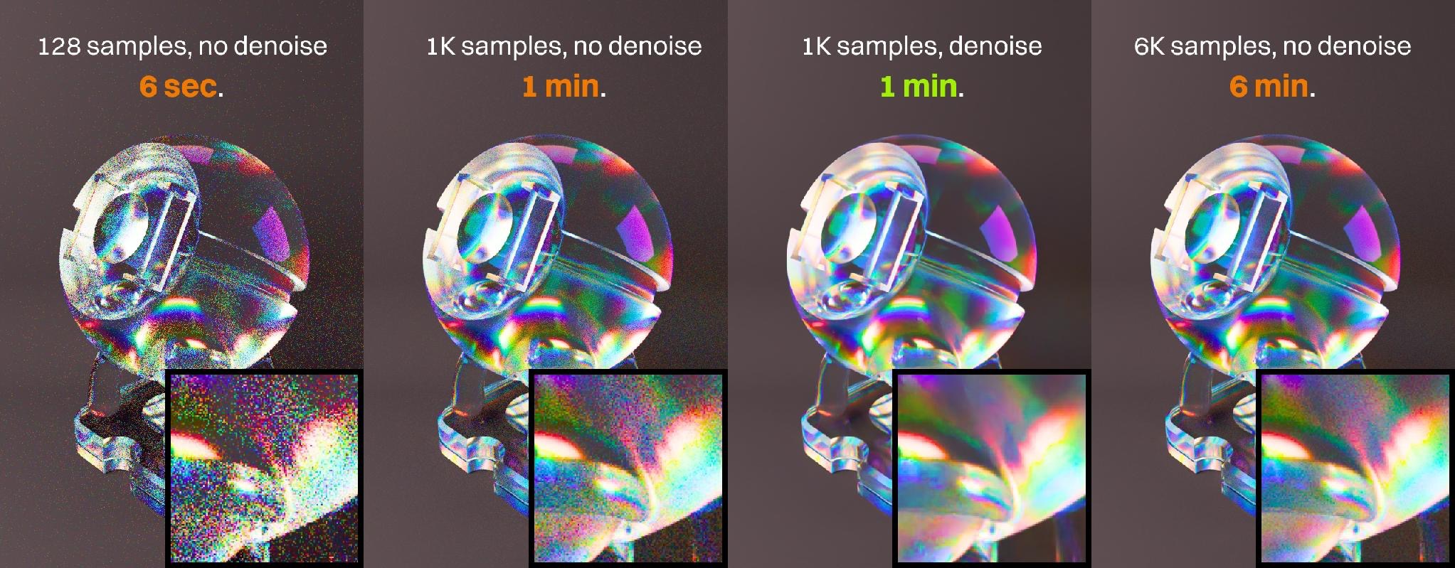

Denoising
Noise is one of the biggest issues to contend with in any render engine. It happens for two reasons:
First is render errors, and those can be mostly dealt with by simply not mistreating the engine. Use Tenet #1, put in plausible values, and most of the really bad stuff will magically go away.
The second issue is that when light and material calculations are particularly difficult (though still plausible), the engine simply needs more time to resolve them cleanly. Since Octane renders progressively, each pass (or sample) will clean up the scene a bit more.
There are things we can do to guide the engine toward spending more time on difficult areas (Adaptive Sampling is a big one), but at some point there are just going to be areas of a render that are going to take forever to resolve.
Denoising was an incredible breakthrough for all areas of digital imaging, and it's quite good now. It takes the rendered pixels and cleans the noise up using an algorithm, and then gives us a second, denoised version of whichever AOV we asked for. We can feasibly shave minutes off certain renders without a noticeable loss in quality.
It has its limitations though - tight patterns can get wrecked, and smeary blotchy artifacts can occur if we don't have enough initial samples prior to hitting it with the denoiser. It's not a silver bullet - more like a push-and-pull thing to figure out how many samples we need before the denoised version is acceptable. There are other tricks we can use like only denoising certain AOVs or masking out the parts that don't need it in post.
