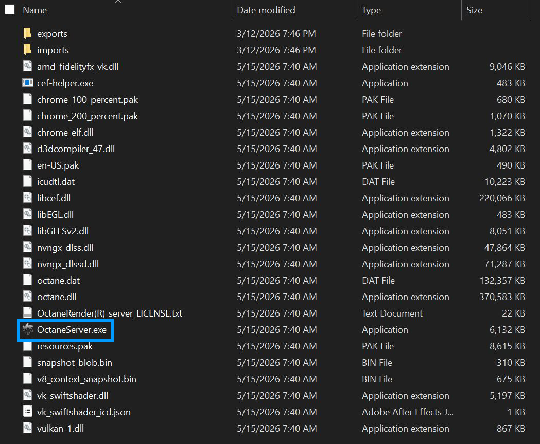

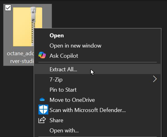

Step 1) Download the version OctaneServer, and the Blender Addon, that matches your License type. You can find these in the Downloads section (Prime License Users should instead go here). Extract the contents from the OctaneServer zipped file.
Step 2) The extracted Octane Server folder, will contain the OctaneServer.exe file. Run this file, before opening Blender.
***Please make sure that any active instances of OctaneServer are closed, prior to Step 2***

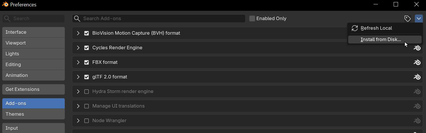

Step 3) Once OctaneServer is running, open Blender and go to the Add-ons section of the Preferences window. Choose "Install from Disk", and select the zipped Blender Add-on file. (Please note: The Blender Addon file must remain zipped - do not extract this zipped file. Otherwise, it will not install properly).

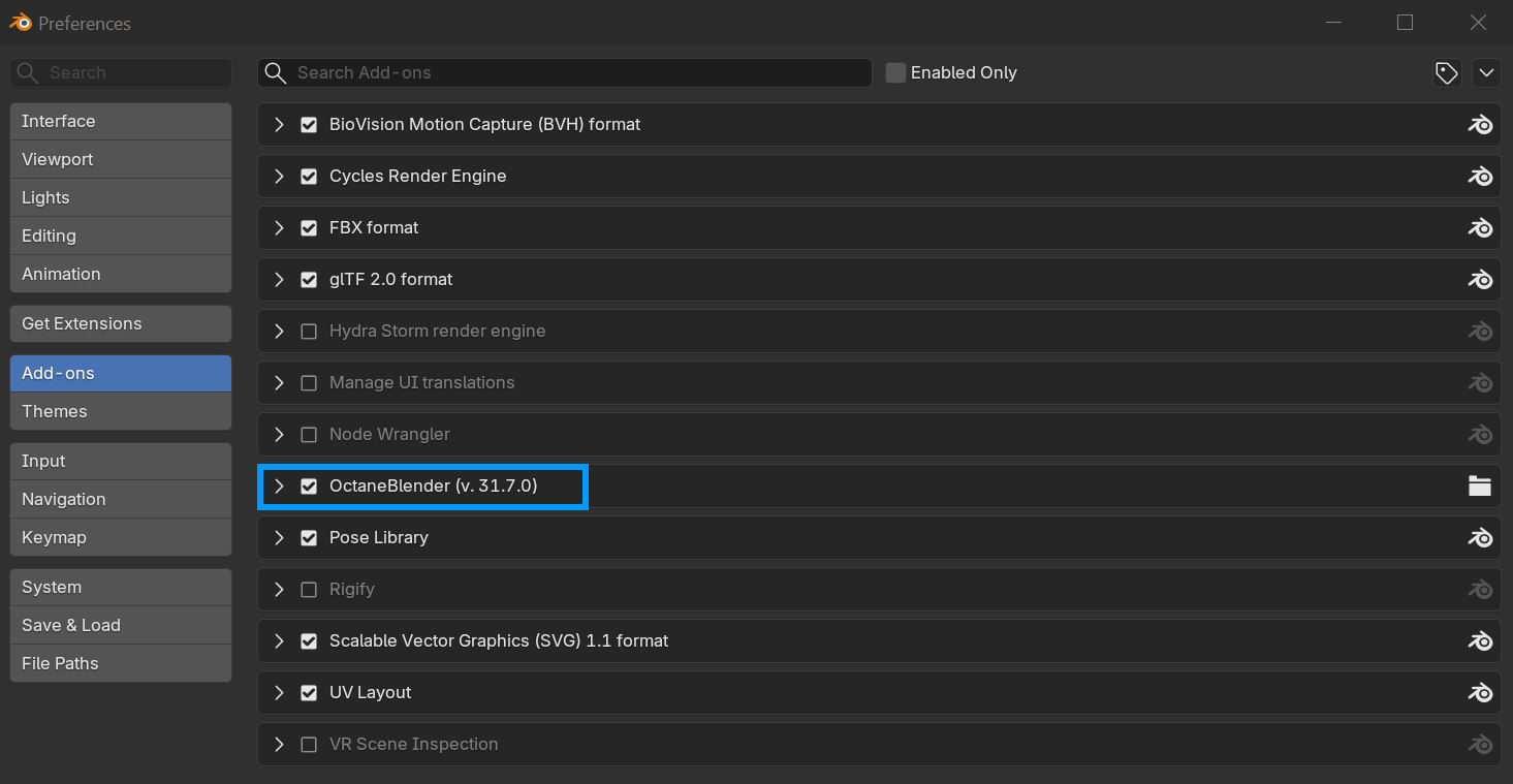

Step 4) The Blender Add-on will now be visible in the Add-ons window. Click the the checkbox, next to the "OctaneBlender" entry, to enable the OctaneRender for Blender Addon.

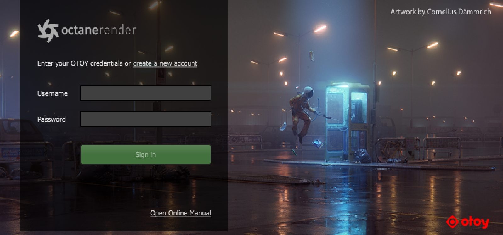

If you are not signed in to your OTOY Account, you will be prompted by a Sign-in screen (like the one below). Enter your OTOY Account Username and Password, then click the "Sign in" button. At this point, the single sign-on and licensing system pulls a valid license key from your account on OTOY’s secure server.
OctaneRender keeps the active session alive, as long you run your Addon-enabled Blender application on a regular basis. In most cases, you should not have to sign in to the OctaneRender licensing system again.

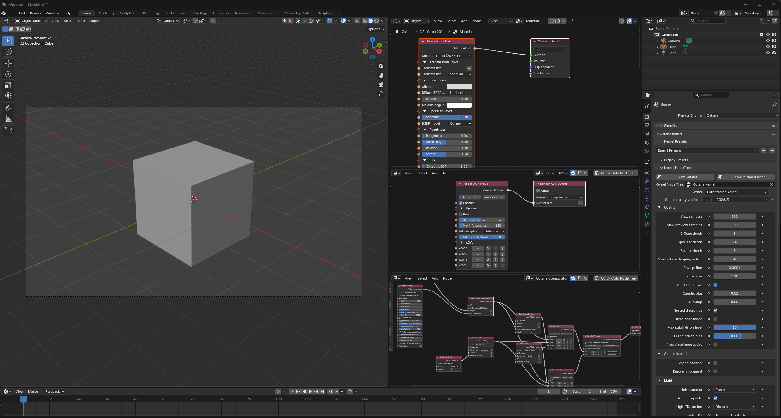

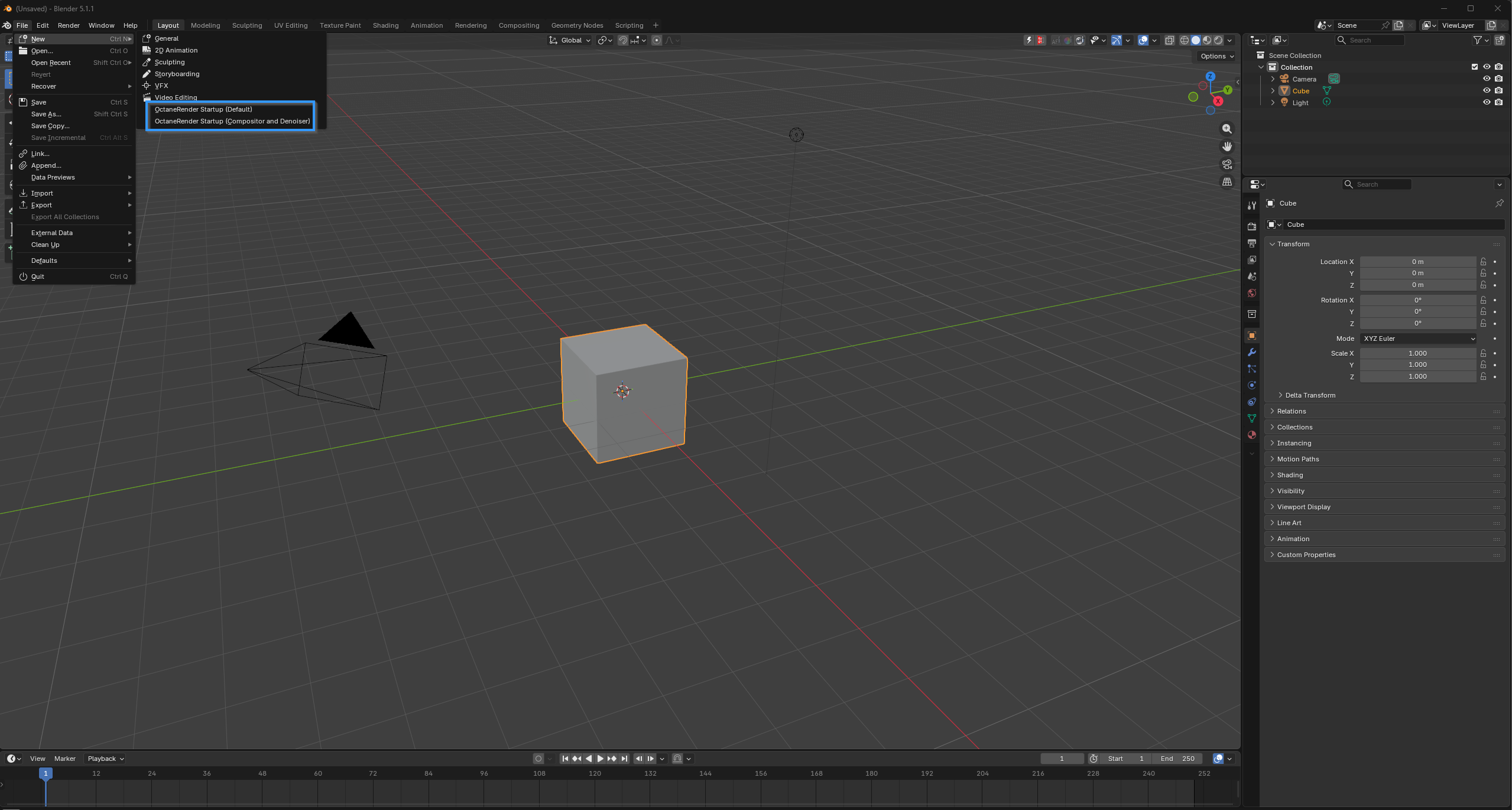

Once you have enabled your OctaneRender for Blender Addon, and activated your License, you will now have two new options under "File > New" that can create a new Octane-enabled scene for you.
Select either of the above options, to open a new scene. The new scene will be similar to the default Startup File, except it will be fully configured for immediate use with OctaneRender.
You are now ready to get started, with OctaneRender for Blender.
