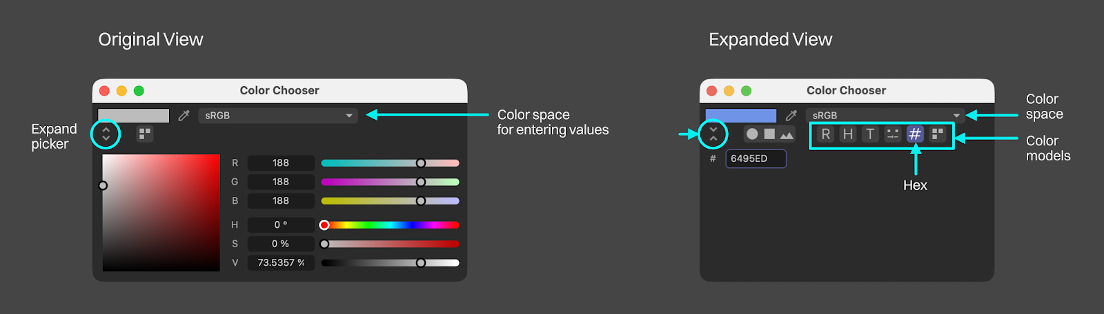

If we click the material, we’ll see the color channel pop up. It has a color UI there that lets us choose a color (currently light gray). If we click the color chip next to the word “color”, C4D’s Color Chooser (picker) will pop up.
This shows us another chip that has our color on it, an eyedropper, and a color space dropdown which we’ll look at in a sec. Below it are two models: 8-bit RGB and HSV. There’s also a button for saved swatches, and one that expands out the picker to show us other models - this is where the hex model will be.
Let’s hit the little uppy-downy arrows to expand the model view, and then choose the # icon to get a hex input.

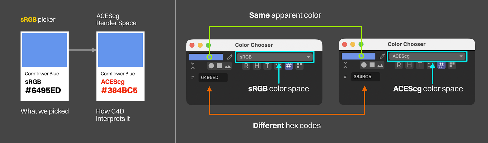

Time to imbue our cube with the legendary sRGB #6495ED Cornflower Blue value! We do that by typing it into the box. Cue heavenly “wahhh” sound effect. Great, that looks right in the color chip.
By default, we had sRGB chosen as our color space, which is good, because Cornflower Blue #6495ED is an sRGB color. C4D had other plans for it though, and immediately converted it to the ACEScg working color space and stored it internally as ACEScg #384BC5.
Fear not, though! ACEScg, being a working color space, will preserve our value just fine without shifting it, as we’ll soon see.
The color space dropdown we see there is actually the input color space dropdown. This allows us to input a color using any color space we want, not just the one Cinema 4D is working in.
If we change the color space dropdown in the picker from sRGB to ACEScg, we’ll see the hex value change. It’s visually the same color, but it has a new designation now. If we knew the ACES cg value of Cornflower Blue going in to this (#384BC5) instead of the sRGB one (#6495ED), we could have just changed the input color space to ACEScg, put in that value, and ended up with the same color.
We didn’t though, because hex is a weird color model for a working color space. Let’s change that back to sRGB, since most of the color values we know are in sRGB.
So this begs the question: Why did it convert it to ACEScg in the first place?

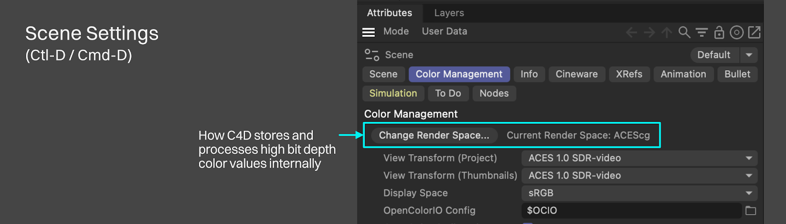

If we go into the Scene settings (Ctl-D or Cmd-D on the Mac), and go to the Color Management tab, we’ll see most of C4D’s color settings. We’ll be visiting this area a lot, so it’s worth burning the Ctl-D / Cmd-D shortcut into muscle memory.
By default, as of version 2026, Cinema 4D uses ACEScg as its default working color space. Prior to 2026, it used Linear sRGB (which is still just as good, but Redshift had already moved to ACES so C4D had to follow suit). This change caused some havoc with Octane in earlier builds of the plugin, but has since been resolved since the 1.8.4 build.
Being a working color space, ACEScg can handle every value in a display color space, and nearly infinitely more to boot.
When we convert an sRGB value to a linear-encoded working color space, the name changes, but the actual _color_ itself does not. When we convert it back, it can remain intact if it’s set up that way (which we’ll look at soon).
So our Cornflower Blue survived its first conversion. It got a new nickname out of the deal (ACEScg #384BC5 which we’re going to immediately forget and not need again), but it’s still the same beautiful color. Sweet.
Terminology note: Maxon probably had their reasons, but they call it a “Render Space” instead of the industry-standard term “Working Color Space”. In this guide we’re going to try to always use “Render Space” when talking about C4D’s working color space, but if we slip up, just know we’re talking about the same thing.

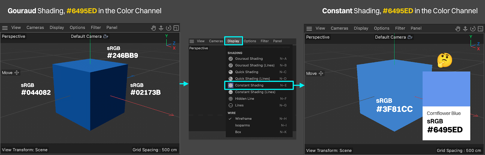

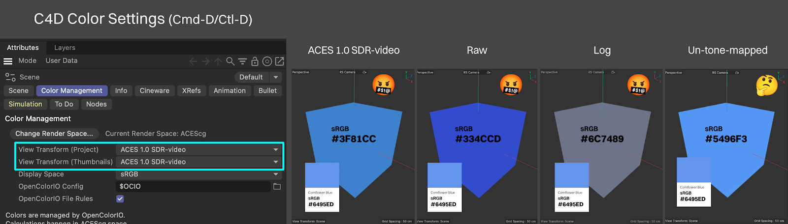

In the C4D perspective viewport, we see three different blues, none of which are Cornflower Blue. That’s to be expected though, the default shading in the viewport (Gouraud) does a quick simulation of what the light and shadow would look like in the scene to help us visualize it better. This is what we’re usually after in 3D - variation in values means things look 3D to us.
If we want to see what the base color looks like, we can kill the shading so we can just see just the flat color value. We do this by setting the Display in the viewport to Constant Shading. So now our cube is a flat color that just picks up what’s in the Color channel. Problem is, It’s #3F81CC, not #6495ED.
That’s weird.
Is it the default reflection in the material? No, removing that doesn’t change anything. Nor does putting #6495ED in the Luminance channel instead of the Color Channel. It’s still shifting by about the same amount.
So what’s going on? ACES “Tone Mapping”, that’s what!

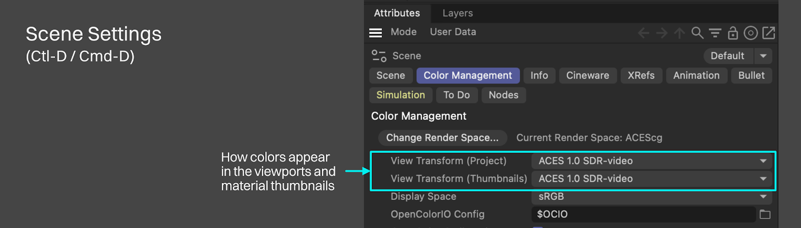

If we head back over to the Project Management settings (Ctl-D / Cmd-D on Mac), and go into the Color Management tab, we’ll see that both View Transforms (Project & Thumbnails) are set to ACES 1.0 SDR-video.
What’s happening here is that our sRGB #6495ED was converted to ACEScg, which is fine and didn’t disrupt anything, but now that C4D needs to actually display the value somewhere, it has to be converted back to sRGB since that’s what our monitors are expecting.
This conversion is also called a transform, and it takes all the values from one color space, processes them, and then fits them into another color space. So in this case, it’s taking the ACEScg (working space) values and transforming them so they can be displayed on our sRGB monitors.
By default, C4D is set to use an ACES transform to do this, which applies “tone mapping”, which… right… shifts all the colors.
C4D has two dropdowns for transforms here: View Transform (Project) refers to the colors seen in the viewport and other areas of the UI, and View Transform (Thumbnails), which refers to the material thumbnails. They should generally be set to the same thing unless there’s some compelling reason not to.
Important:This isn’t actually changing any of our color values themselves, it’s just displaying them according to the processing scheme selected. Being an ACES shop, Maxon decided that an ACES transform was a good default for this, and it should better match the final render if ACES tone mapping is being used.
Our hero doesn’t agree with this though. It wants its legendary Cornflower Blue suit to remain so. Let’s take a look at our options here:
There’s ACES 1.0 SDR-video. That’s what it was set to by default, and it was using ACES tone mapping (different concept from ACEScg). Like all tone mapping, the method found in this ACES view transform shifts colors - it’s why our color went from #6495ED Cornflower Blue to #3F81CC Not Cornflower Blue (and made our hero cube cranky).
There’s RAW, which apparently is supposed to show the Render Space (ACEScg). This is pretty ridiculous with ACEScg because no monitor in existence can possibly show all that, so a lot of clipping will occur and it’ll just look like a dark mess. In our case, the blue will just go really moody (#334CCD).
There’s Log, which is a baseline used in film grading that’s not meant to be viewed as-is and probably won’t be super useful. If we set this now, our blue will turn into a dusky blue-gray (#6C7489).
Finally, there’s un-tone-mapped which is just the straight transfer function that matches the Display Space dropdown right below the transforms. We haven’t discussed this because it’s always sRGB unless we have some fancy OCIO setup. Anyway, this is what we’d choose if we’re not using any tone mapping in our project. If we set it to un-tone-mapped right now, our Cornflower Blue color in the viewport should sample correctly as sRGB #6495ED.
Should.

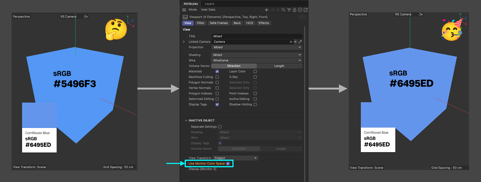

Wait… no, for some of us, it’s still off on the author’s MacBook Pro! It’s #5496F3, not #6495ED! WTAF?
Oh right, the monitor…
The last piece of the puzzle is our display, which is also using a color space (yay.).
There actually is a chance that Cornflower Blue will be appearing correctly if our monitor is set to (or only capable of) sRGB, but many modern ones - especially laptop screens - are natively a somewhat larger color space like Display P3. If that’s the case (it definitely will be for us Mac users, and probably will be for most Windows users in 2026), then we need to tell C4D to take our monitor’s color settings into account if we want everything all matchy-matchy.
This option is in a totally different place. It’s hidden in the Viewport settings (not the Scene Settings), but instead of Shift-V which shows us settings for the current viewport, we want Alt-V (Option-V on the Mac) to give us the settings for ALL viewports.
At the very bottom of the View tab is an option for Use Monitor Color Space, which is off by default (why, Maxon, why.) When we turn this on, C4D will run the colors through one last conversion, and our beloved Cornflower Blue color will FINALLY appear as #6495ED in the C4D viewports.
[Add fireworks and cheering in post]

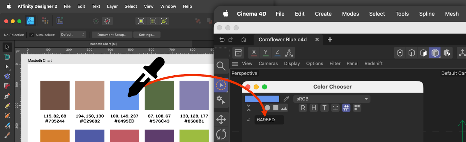

Another thing we may want to do is use the eyedropper tool in the color picker to sample Cornflower Blue (or some other lesser, inferior color) from a different app, or from something in the OS’s UI.
Important: If absolute precision is needed, most of the time eyedroppering a color from an external app is a Very Bad Idea®. The only way to get an exact color into the color picker 100% of the time without fail is by manually entering the RGB / HSV / Hex /etc values for that color space.
