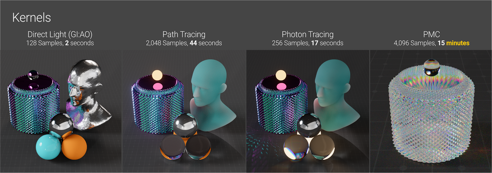

Step 1: The Kernel

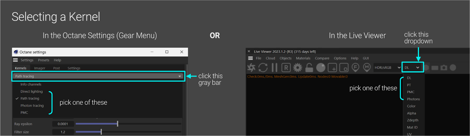

The kernel is the main chunk of code that Octane uses to render scenes. It can be selected in the Octane Settings (gear menu, Kernel tab, gray dropdown at the top), or via a dropdown in the Live Viewer that defaults to “DL” in C4D. This is implemented in different locations in different plug-ins and Standalone.
There are currently four of them: Direct Light, Path Tracing, PMC, and Photon Tracing. (There’s an Info Channels kernel too, but that’s for looking at AOVs and other special use things that we’re going to ignore in this guide).
For the most part, the default kernel settings are good as a baseline, and then depending on the scene they can be altered to optimize for the types of lights, materials, and effects we’re after.
Which kernel to pick?
Direct Light (DL)
DL is the oldest and most basic kernel, but is still useful in certain scenes and situations. It has three types of Global Illumination modes which offer different levels of realism and render speed. It doesn’t do caustics, and scattering is very limited, so if we have either of those, we’ll want to move straight to Path Tracing.
Path Tracing (PT)
PT builds on DL by adding better secondary bounce calculations (including caustics) and upping some settings that make most scenes even more realistic than anything DL can achieve. Because of the older methods of calculating secondary bounces, it’s difficult to achieve tight caustic patterns and is very prone to noise and fireflies if the settings aren’t set just so. It’s still a great choice if caustics aren’t an important part of the scene.

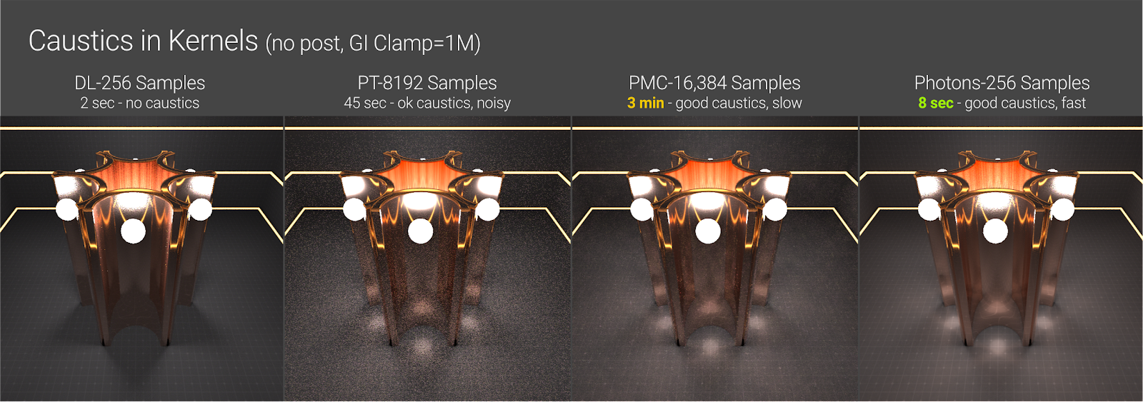

Photon Tracing
Photon Tracing builds on Path Tracing by adding a faster, more efficient, and better looking method of calculating caustics. It’s quick and easy to get pretty caustic patterns, plus it has all the same advantages as Path Tracing when it comes to realism. If caustics are important and not resolving well in PT, this is the solution. There’s a whole guide on this topic. One caveat: it creates a bit of overhead and can cause issues in multi-GPU or network rendering setups, so we really should only consider it in cases that have tricky lighting, and/or where caustics is important or causing issues in Path Tracing that can’t be resolved in other ways.
PMC
PMC is kind of the odd kernel out. It can do better caustics than PT (not as good at Photon Tracing), but is FAR slower than the others, and isn’t compatible with Octane’s AI denoiser (2023 and earlier) or adaptive sampling. PMC uses a different algorithm to calculate rays than the other three, and has its own “look” because of this. Occasionally this will be the best path forward if there’s a scene with tons of lights and refractions or from an artistic point of view, but at the expense of waiting a good long time for it to finish. PMC is also not as predictable as PT and Photon Tracing from frame to frame, so it’s not great for animation. As of this writing, Octane 2024 is still in its Alpha stages, but it does support the Intel Open Image Denoiser which is compatible with PMC.
If we’re considering PMC, It may be a smart idea to start the lookdev process in Path Tracing or Photon Tracing, and then move to PMC once we have most of it settled and want to see whether PMC does a better job with our scene (typically only if there’s very complex lighting and refraction).

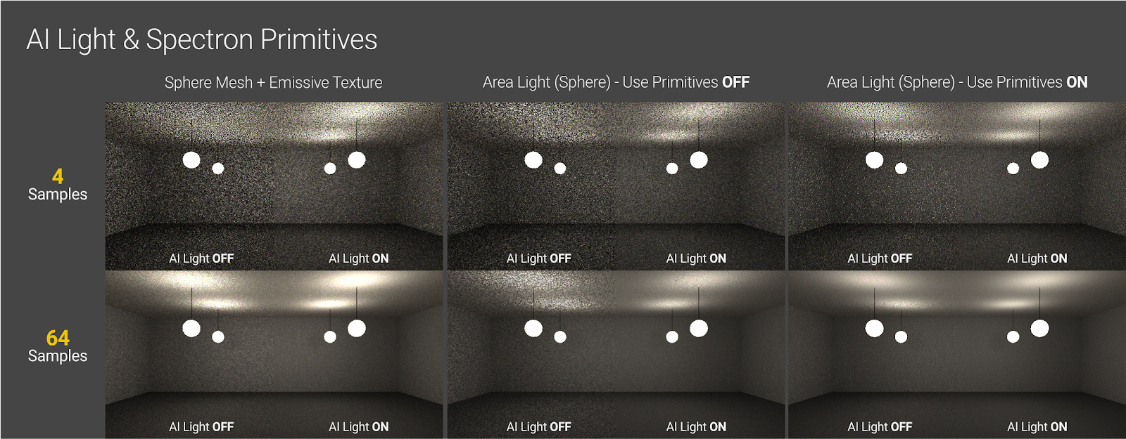

AI Light should be on if we’re using physical lights (which need to be set to use primitives or analytic).

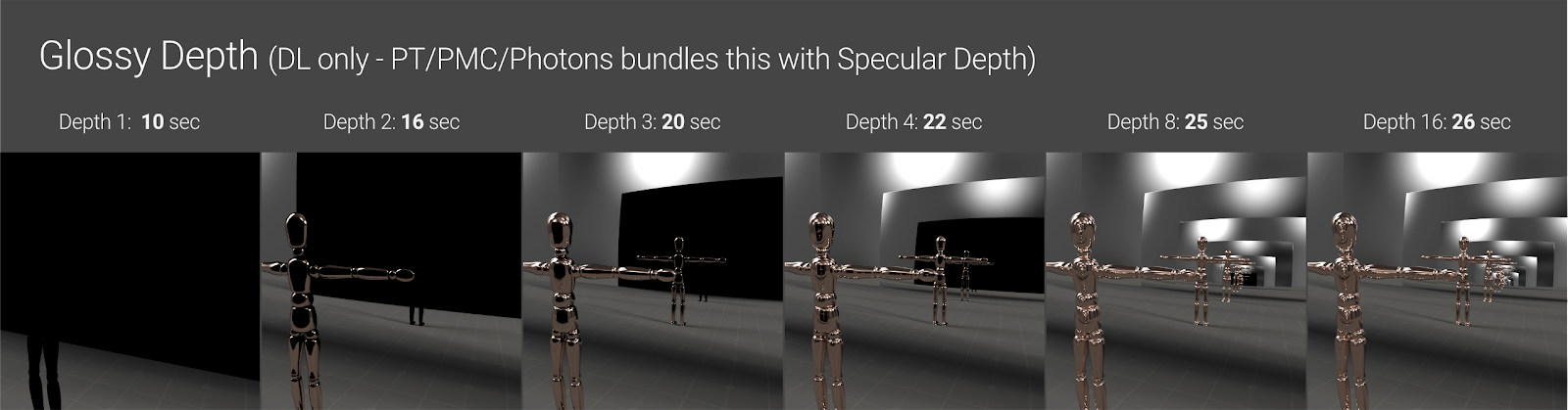

Glossy Depth
Glossy Depth is only found in the Direct Light (DL) kernel. The other kernels calculate reflection rays using Specular depth. Glossy affects bounces off of reflective materials that have Specular or Metallic contribution. It has no effect on transmissive (glass/liquids/etc.) materials.
The easiest way to visualize this is with a hall of mirrors setup like in the illustration above. When we run out of bounces, whatever would be reflected again shows as black. We need at least two bounces to see anything reflective. At lower values, we quickly end up with blacked out patches, but at higher ones, the patches become so small they don’t register (just like in real life). 16 is usually plenty for most scenes unless the whole thing is made up of objects that keep reflecting each other.
The DL kernel defaults to 2, which is probably too low for any scene with metals or glossy materials - we’ll probably want to up it to at least 5, if not 8, and then back it down to get the look we’re after.

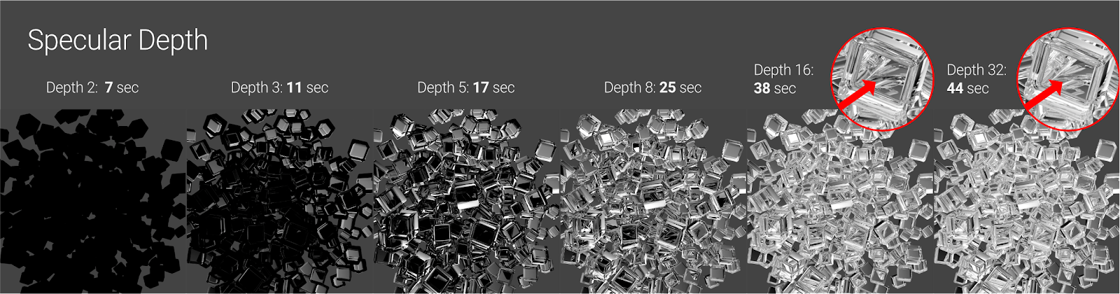

Specular Depth
Specular Depth is found in all kernels. In DL, it only affects transmissive materials (glass, liquids, etc). In the other kernels it affects both reflective (glossy/metallic) and transmissive materials.
Because of the way refraction works, we need at least 3 bounces (default for DL in C4D) to see anything in a transmissive material, which is ok for very simple scenes, but odds are good we’ll need to go higher to prevent blacked out areas. 5 would be a good place to start for a standard scene, or 8 if we have a lot of refraction.
16 (default for the other kernels) is a good sweet spot for most scenes using PT/PMC/Photon Tracing because this setting also affects reflective materials, but if there’s a lot of overlapping glass and metals, it’s possible we’d have to go as high as 32 to resolve some tricky areas if they’re bothering us. Lots of refraction is hard on the GPU and can really impact the render times, so we’ll want to spend a little time optimizing this setting and making sure each bounce counts.

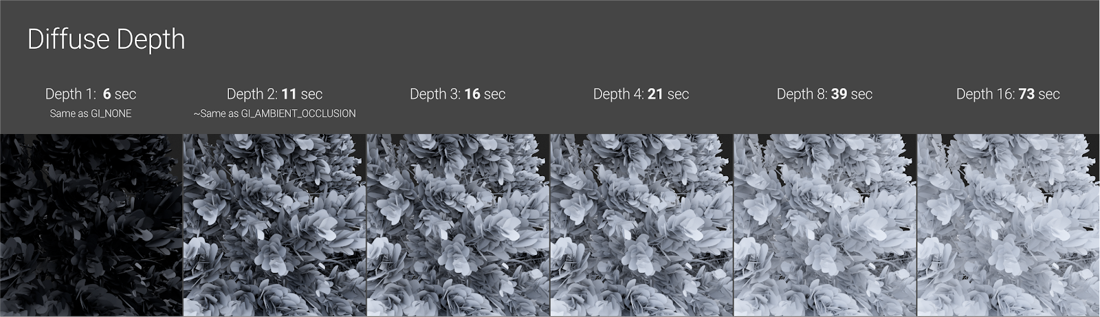

Diffuse Depth
Diffuse Depth is found in all four kernels. This is the number of times rays bounce off materials that have some sort of Diffuse (or Albedo, or Base Layer Color) contribution. These are things like wood, clay, brick, plaster, or anything else that tends to be matte in appearance. Diffuse depth is a little more complicated than Glossy or Specular because it has a lot more to do with indirect rays (secondary bounces) than direct ones.
Unlike the mirror or refraction examples in the other sections, we’re never going to run into an issue where parts of the render are fully blacked out because there aren’t enough primary diffuse rays. What we DO see is our diffuse geometry brightening and softening more as we increase the slider, and that’s because more light is bouncing off the diffuse objects. The brightness of the material plays a large role in how much the light will bounce - the darker the Albedo/Diffuse color, the more it will absorb light and the less impact this setting will have.
This is where it gets a little confusing.
Path Tracing, PMC, and Photon Tracing all use this setting in the same way - the higher the number, essentially the more paths are calculated and the more evenly and naturally lit it looks. All three of these kernels default to 16 which is a good compromise between quality and speed. For some scenes, it might look better when higher and be worth the speed hit, and for others we can reduce it and save some render time.
The Direct Light kernel also has this setting, but whether or not it does anything depends on the GI mode.
DL has three GI modes: Ambient Occlusion (default), None, and Diffuse. GI_None means there are no secondary diffuse bounces, and GI_Ambient Occlusion uses AO and the environment to sort of “fake” indirect lighting without considering secondary diffuse bounces. The Diffuse Depth slider doesn’t do anything in these modes.
GI_Diffuse does what GI_Ambient Occlusion does, but also factors in primary diffuse bounces, so the Diffuse Depth slider does become relevant and affects the scene similarly to the other three kernels.
Octane (in C4D) defaults to 2 diffuse bounces with Direct Lighting, but tops out at 8, which may not be enough. The other three kernels default to 16 bounces which is pretty high, and top out at 1024 bounces, which is ridiculously high, but since this does affect the look of the render, it’s actually better to overestimate first and then dial it back down once the scene is closer to completion and see if it impacts the render time too much.
Scenes where we’ll see the biggest difference with Diffuse Depth are ones that have either a lot of objects with diffuse materials that are pretty close together and have bright materials (like leaves or sand particles), a matte object with complicated geometry with tons of nooks and crannies for light to bounce around inside of, or materials with a scattering medium that uses Diffuse Transmission.
Roughness is also affected by Diffuse depth, so even if the scene has no diffuse materials at all, if it has any reflective/refractive materials with Roughness, we’ll need to make sure we have enough diffuse bounces.

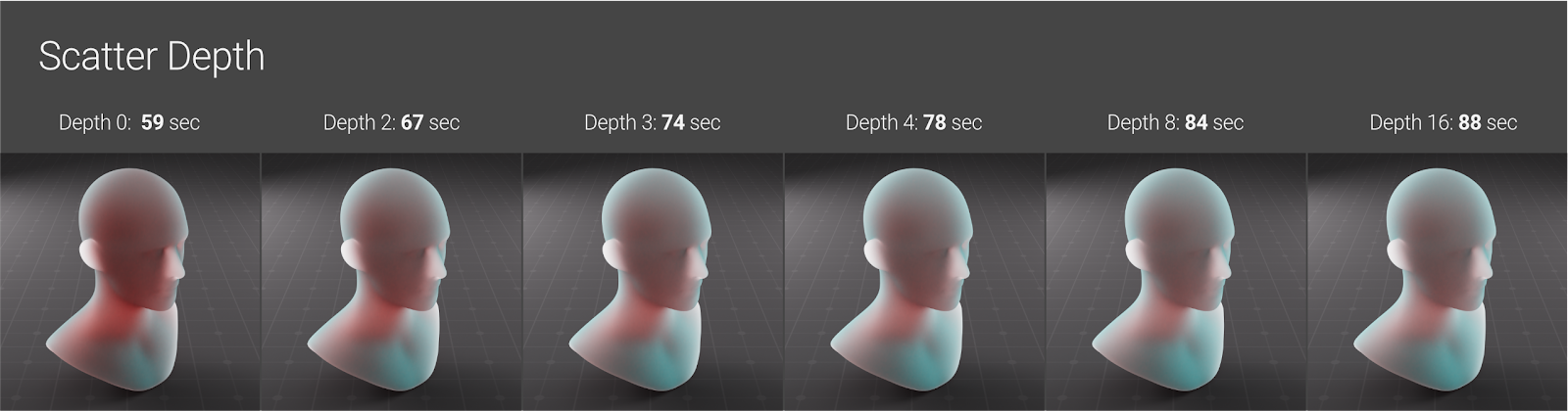

Scatter depth is found in the PT, PMC, and Photon Tracing kernels. Some types of scattering (diffuse transmission-based) actually ARE possible with the Direct Lighting kernel (GI_DIFFUSE mode only, and Diffuse Depth controls the look). Because DL doesn’t have a scatter depth setting, it’s often better to use one of the other kernels for SSS/fog/etc.
Scatter Depth controls the amount of bounces that occur in a scattering medium. It’s only one part of the equation though - getting SSS, fog, and volumes looking good is a delicate dance between Scatter Depth, Max Samples, Medium Density, Volume Step Length, scene lighting, and at least three or four other things. This guide has quite a bit more detail on this.
The difference can be massive or minor depending on all of the other factors. In the example above, the difference between 0, 2, and 3 bounces is pretty apparent, but between 3 and 16 bounces is fairly minor (still there though), and it adds 14 seconds to the render. Depending on how many frames there are, that can add up.

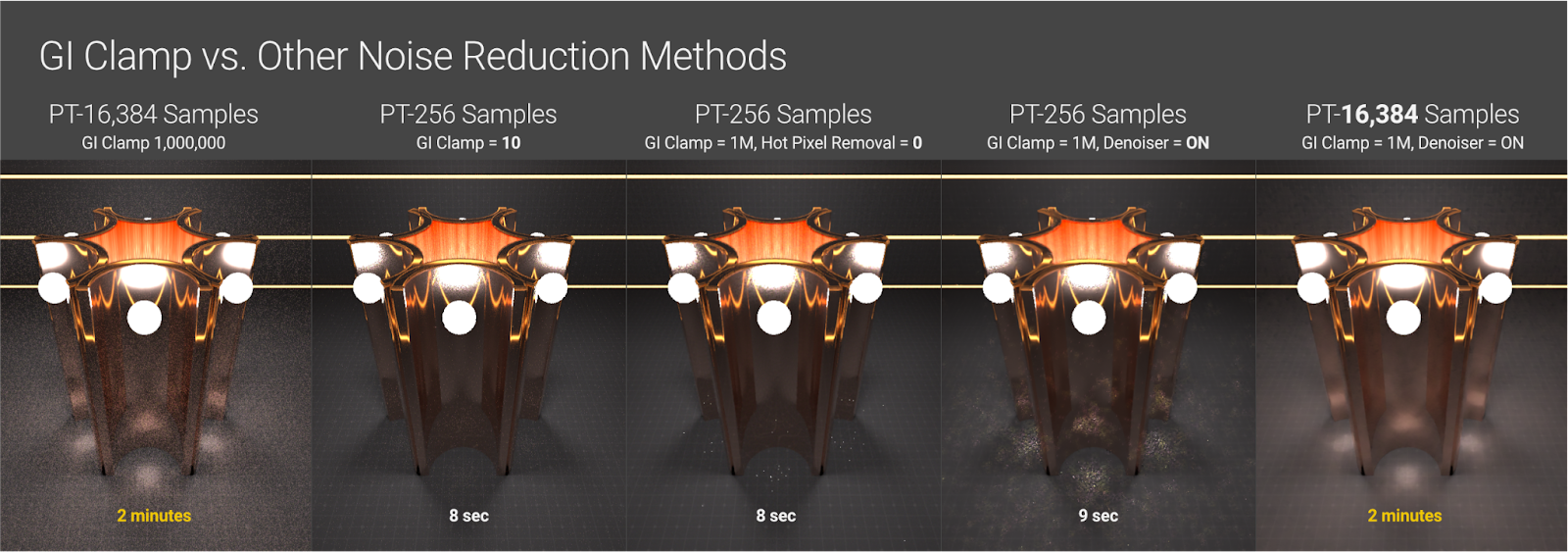

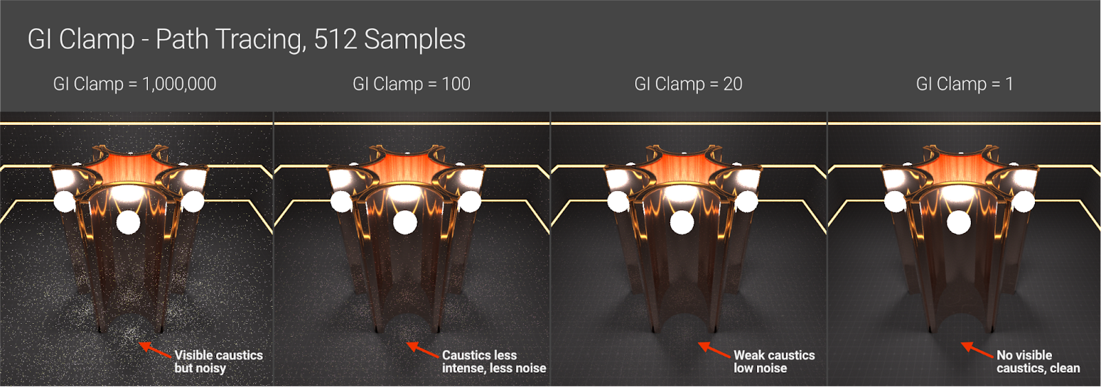

GI Clamp
This setting is a notorious hot button issue, so we’re going to spend a bit of time breaking it down.
Path Tracing, Photon Tracing, and PMC all use a different, more realistic type of indirect lighting than DL. The rays that these other three produce take into account caustics, which is the effect of light bouncing off a reflective surface, or through a refractive one, and settling on a diffuse surface.
Caustics and secondary bounce calculations are hard on the GPU, but they also add a ton of realism to the scene. In the real world, there are unlimited secondary light bounces that go everywhere and illuminate the environment. In a render engine, we have limited resources, so if we try to simulate that and don’t give the simulation enough time to resolve, we get artifacts. These manifest visually as noise and hot pixels (sometimes called ‘fireflies’).
GI clamp is one of the tools that helps mitigate these artifacts. It compresses the contribution of indirect rays. GI clamp acts like a filter to limit really strong, independent rays that end up creating the hotspots earlier on in the progressive sampling process. Limiting the rays limits the realism of the scene (sometimes a little, sometimes a lot), but cleans up hot pixels and caustics-related noise in the Path Tracing and PMC kernels.
GI Clamp defaults to 1,000,000 which is pretty much unlimited for all intents and purposes. If we set the GI clamp to 1, the result looks very similar (and sometimes exactly the same) as Direct Lighting with GI_Diffuse. For scenes without much in the way of interior lighting or caustics, we can actually get away with very low values like 100 or even 10. Just like the rest of the clamps and caps, we’ll want to start high and work our way down until we hit the balance between speed and quality.
Increasing the Max Samples will resolve some of the noise by brute force iterating on the rays, but usually not enough to get a clean result. Denoiser in the AI Denoiser tab and the Hot pixel removal tool in the Imager tab are both post effects that can help reduce hot pixels. We can’t rely too heavily on them (especially with an animated piece) because they can only use the information they’re given and guess at what they’re supposed to do, so they can leave other artifacts behind like blurry/splotchy areas or removing/altering areas we didn’t want altered.
Ideally we want the GI clamp to remain as high as possible. If our noise and hot pixels are caused by caustics, switching to the Photon Tracing engine should resolve most of that. If the problem is our lights, we can use the techniques found in the Lighting and Emission Guide (better placement of lights, limiting the emissive surface through distribution, real world values, etc.) to solve these issues. Once we’ve done all we can using other methods, THEN we can start lowering the GI clamp to fix any stubborn areas that just won’t resolve.

If we have a complex light setup with several area lights in our scene (not HDRIs), this one is a no-brainer. Using AI and Analytic lights can speed the lighting calculations up because they analyze the scene and help put light rays where they’re needed rather than just randomly smatter them. In simpler scenes with a few lights and no tricky bounces, it may not yield any improvements (and in some cases may actually increase render time because of the overhead). The Lighting and Emission Guide goes further into detail on this (search for “Primitives” or “Spectron” - it’s toward the end).

As mentioned before, Hot pixel removal in the Imager tab can reduce hot pixels (or fireflies) after the render is complete if that continues to be an issue.

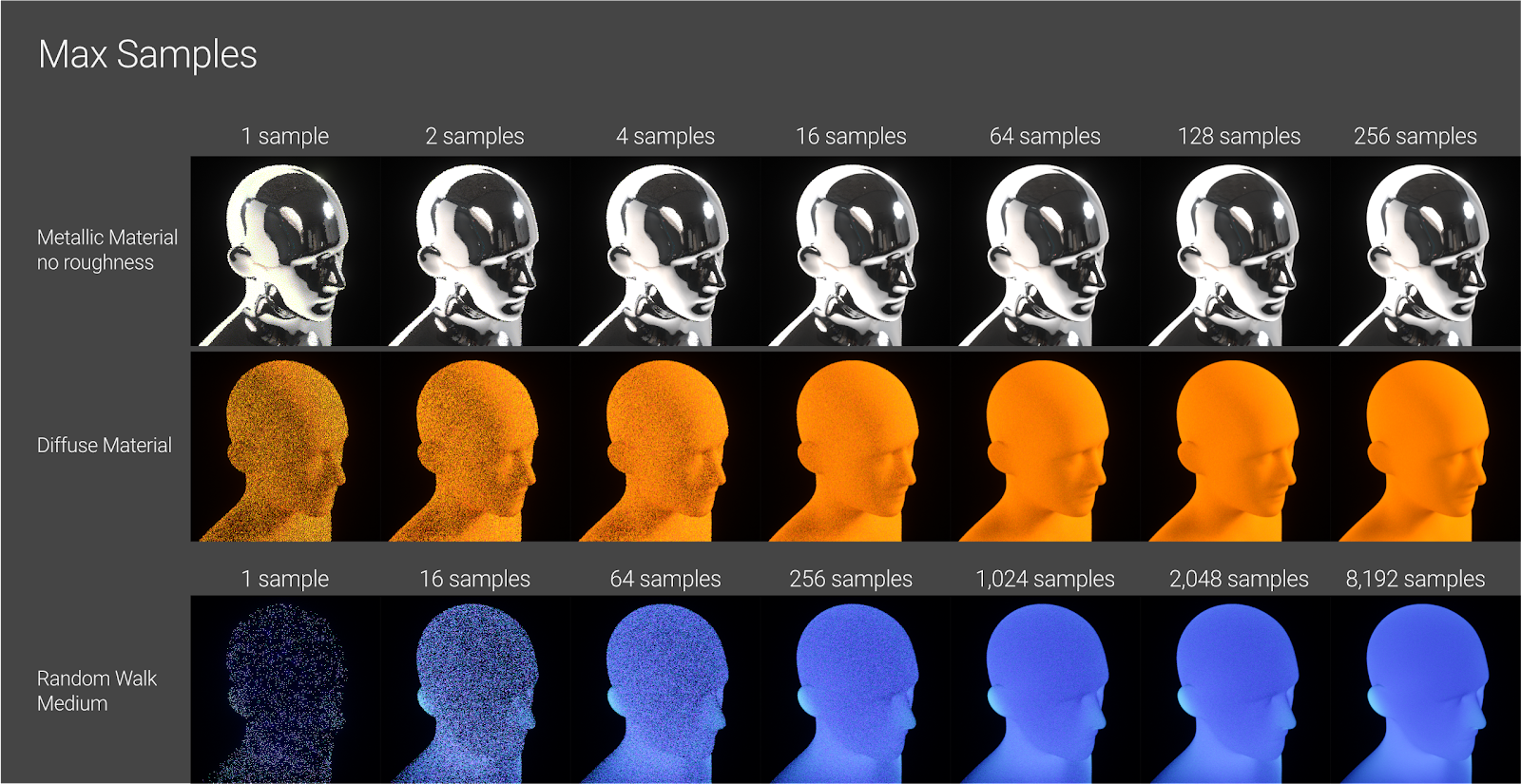

Max Samples
All four kernels in Octane use progressive passes (called samples). This means when we hit render, Octane shoots out a bunch of rays, does some quick and dirty calculations based on light, geo, and materials, and returns a really crunchy, low-fi image so we can at least see something. This is the first pass, or first sample. It then does the same thing again and returns another version that’s slightly better - the second sample. It continues to refine and refine until it hits the maximum number of samples that we set in the Max Samples field.
Direct Lighting often needs FAR fewer samples than the other kernels because it’s not capable of advanced effects like caustics that beat on the GPU and require more time to resolve all the finer details, especially if we’re using GI_AO or GI_None. That’s why the default for that kernel (in C4D) is 128. That said, we can still cause it grief by throwing something like Random Walk SSS at it (see the # of samples required above).
The other three kernels do have to deal with caustics and real secondary bounces, and since Octane doesn’t know exactly what we’re doing, it sets the default to 16,000 max samples (C4D does, at any rate - YMMV with Standalone and the other plugins, but it’s typically pretty high). This usually is enough to resolve nearly anything (eventually), regardless of how much we fail to optimize the other settings.
16,000 samples takes a long time, and on simple scenes that resolve quickly, it’s wasted work because the incremental differences between samples aren’t worth the extra render time. Regardless of the kernel, or makeup of the scene, the strategy is to get close to the fewest samples possible while still producing the quality we need. It’s “get close to” and not “find exactly” because we can waste a ton of time doing A/B testing between small increments (does 1020 samples or 1040 samples look better? Does it matter?) that we could have better used to improve other parts of the render, or spend more time with our families.

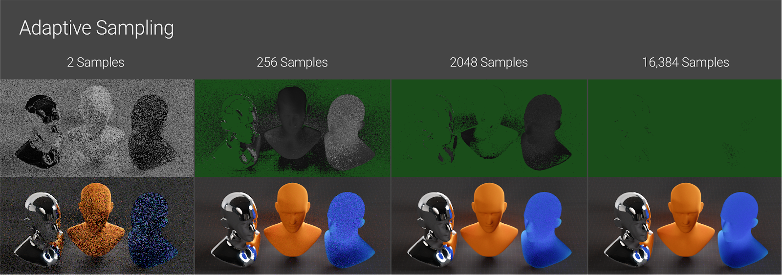

Max samples can be thought of as a brute force way of reducing noise. Adaptive Sampling optimizes this by stopping sampling from happening in the parts of the render that it sees as fully resolved and then turns the firehose on the more difficult areas that are still noisy. By focusing efforts on the areas of the render that need it most, this can greatly speed things up.
Important: PMC does not support Adaptive Sampling, but the other three kernels do.
Scenes that have a lot of noise issues in particular areas may see a pretty large speed increase in overall render time. Ones that have a pretty even amount of difficulty across the frame may not be affected at all. The scene in the illustration above is a great candidate for Adaptive Sampling.
The top row shows the noise over time - the portions that light up green are fully resolved and no more attention is given to them. The metal on the left took almost no time to render, the diffuse material in the middle needed about 1000 samples, and the SSS on the right was extremely hard on the GPU and needed the full 16k samples to clean up.
The whole scene still took 16,384 samples to fully resolve both with and without Adaptive Sampling, but with it on, it took 1:07, vs. 3:30 with it off because toward the end, Octane only had to worry about the SSS head, so it was able to burn through those remaining samples much faster.
The noise threshold controls the speed-to-quality ratio. 0.02 gives a clean result and most of the time doesn’t come with enough of a speed hit to worry about. 0.03 (default) is a little faster, but a little noisier. 0.04+ is noisier still, but may be considerably faster if we’re after speed over quality during the lookdev phase.

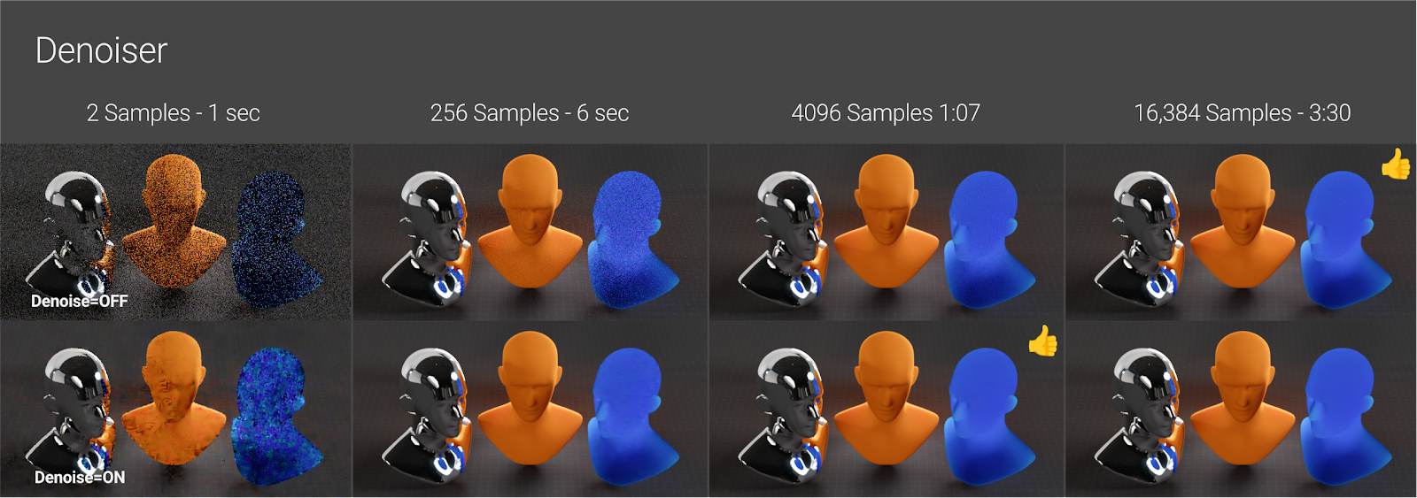

AI Denoiser
Once we’ve got everything else settled, we can look into whether we can get away with denoising to help the render times. Denoising is a post effect in the Imager tab of the Octane Settings that waits until the render is done and then does some magic algorithm stuff to analyze portions of the image and remove what it considers “noise”.
What this allows us to do is stop the render earlier and cheat our way to the final product. In the example above, we can see that even at 2 samples, Denoiser does a bang up job on the metal (since it was mostly there anyway), a poor job on the diffuse material, and an abysmal job on the SSS because, to be fair, it really didn’t have much to work with. By 256 samples (6 sec), the metal and diffuse are pretty much there, and the SSS is getting there. Somewhere between 3072 (50 sec) and 4096 (1:07), we can stop the render and call the denoised version final. Without, the SSS still has a bunch of noise that only goes away after 16k samples and another 2+ minutes.
Sometimes, in the case of large flat, smooth, organic areas, this can mean we only need a fraction of the samples to get a clean render. In other cases, it could mean all the intricate patterns we spent so much time on get wiped out or blotchy because the denoiser thought they were noise, and we only shave off a few seconds by the time we get enough samples that it looks ok. This is entirely scene-dependent.
A good rule of thumb is to get the render as close to clean as possible WITHOUT denoiser, and then apply the denoiser and incrementally reduce the max samples to see how low we can go while still maintaining the integrity of the render. This may mean reducing the min samples and noise threshold if we’re combining this with adaptive sampling.
There are also a few denoiser settings like min samples and interval that affect how often the denoiser is applied throughout the sampling process (so we can see it re-denoise every x samples). These settings only apply if “denoise on completion” is turned off. Turning it off can cause things to slow down depending on the scene and hardware, so usually it’s advisable to just wait until the render is complete unless we’re trying to ballpark how few samples we can get away and still get a decent denoised result.
Important: Denoising can have undesired effects like jitter or moving blobs in an animation if we lean too heavily on it. It’s always a good idea to render out either a smaller set of frames or a render region for an animation to make sure we don’t waste time on 900 frames that end up being unusable.

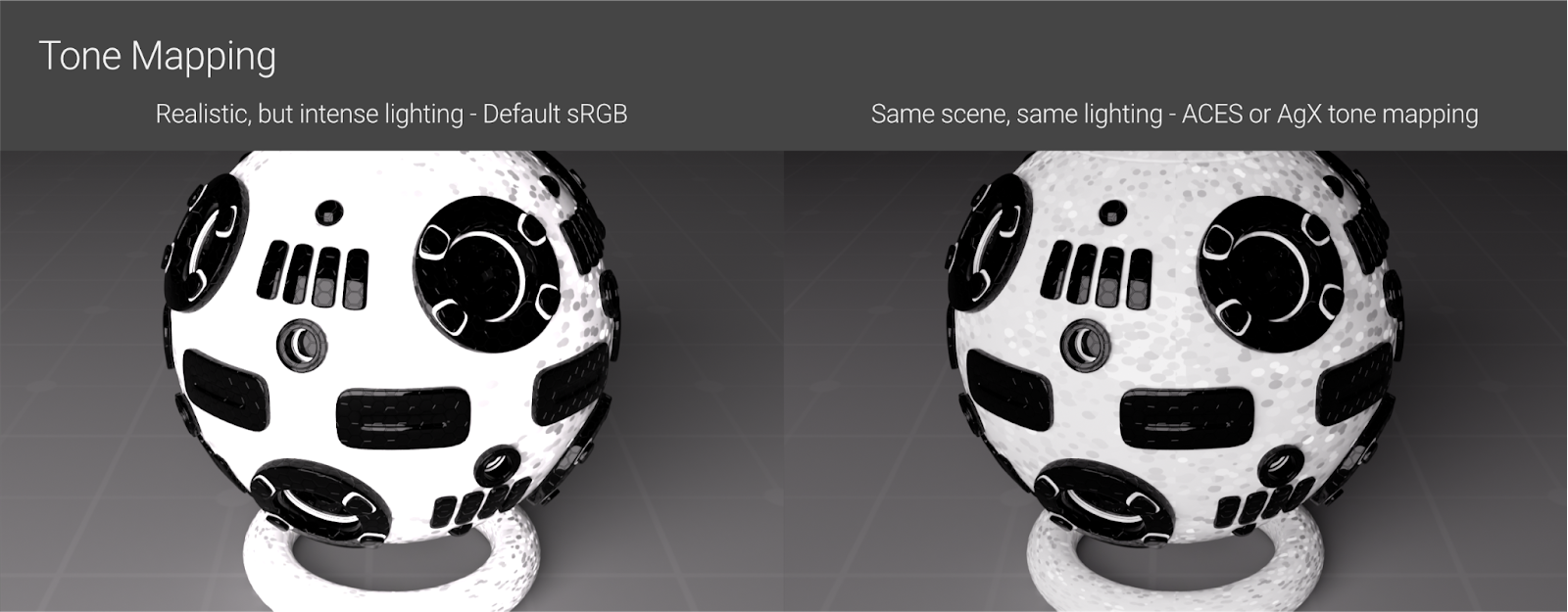

Tone Mapping
While Tone Mapping isn’t really an “optimization” thing per se, it still affects how we set up our lights and materials, and if we’re using the default un-tonemapped method, it may lead us to make certain decisions which can cause problems with other parts of the render.
Except for a few very specific cases (we need to match an sRGB hex value EXACTLY, for instance, or we’re going for a very particular non-photoreal style), the default method of tone mapping (which is basically just clipping out-of-gamut values) is never as good as an alternative type like ACES or AgX.
Fortunately Octane has a one-click solution to allow us to use ACES tone mapping, and while it takes a little doing to set up OCIO to use AgX, once we get it going, it’s easy to implement for all our projects.
Tone mapping and color spaces in general is a tricky topic to fully understand. There’s a whole guide on the hows and whys of color management in general, and another one that shows how it applies to Octane.
