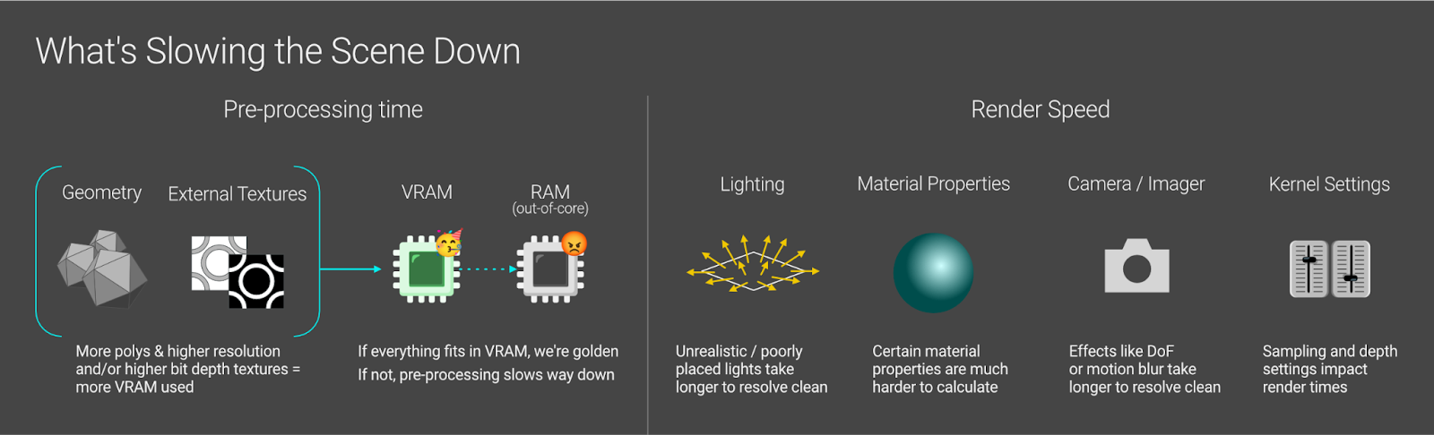

Octane works by taking geometry, adding materials, lights, and other objects like volumes and instances, and sending the whole lot off to the GPU where it loads the data into VRAM, processes it, and renders out a frame.
Memory is a very important part of this: If everything fits in VRAM, Octane runs at full speed. If not, it has to use out-of-core memory (RAM) which makes the whole process a lot slower. Even if it all fits, the more stuff (mainly textures and geo) that has to be loaded into VRAM, the more pre-processing time is needed before a render can even begin.
An added bonus to optimizing the memory is that if we have left over VRAM, we can use it to speed up the render process in the form of parallel samples (discussed more in the render settings optimization guide).
Once memory is under control, optimizing the materials, lighting, and other objects is the next step - that will help the renders themselves go faster, regardless of the settings we use.
THEN we can move on to the render settings optimization process to really dial in the final render speed.

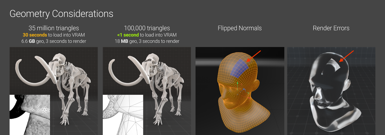

Reduce the amount of VRAM used as much as possible - the biggest offenders are geometry (number of polygons) and image textures (PNG/JPG/EXR/etc). Retopo/poly reduce where possible, and also use the fewest and smallest (lowest resolution/bit depth) image files we can get away with for our scene.
Make sure geo is good (no reversed normals or messed up/overlapping polys).

Mammoth model (both the high res and low res versions) from The Smithsonian’s 3D Digitization Project.
Remember: Always. Use. Real. World. Scale! Making a 20 meter tall person or a 5 cm building will mess up the calcs and cause us to have to adjust the lighting to unrealistic values which worsens the problem.
The geometry itself also matters quite a bit when rendering. This is true for both the number of polygons and the quality of the meshes. More polygons = more load and processing time prior to rendering and more VRAM usage, sometimes significantly like the case of 3D scans or tons of instances. Issues like flipped normals, or overlapping / malformed / nonplanar polygons can cause render errors and noise that doesn’t seem to resolve no matter how many samples are thrown at it. This guide series has more on this topic.

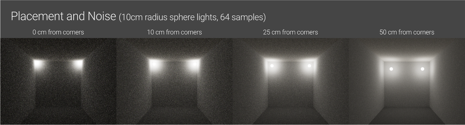

The lighting setup can also greatly contribute to noise and artifacts if not set up properly. In general the two biggest things to look out for are unrealistic lights (both size and intensity), and geometry getting too close to an emissive surface and blocking the rays. Both of these will add extra noise to the scene and cause artifacts like hot pixels. These things can be cleaned up to some extent in the render settings, but at the cost of realism. It’s FAR better to fix them by using IES textures and/or spotlight distribution, or just placing lights in better locations before they become a problem.

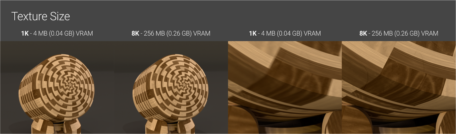

Textures
Textures use VRAM, and sometimes a whole lot of it. Loading a lot of textures and/or maxing out our VRAM will slow us down. We want to use the smallest, lowest bit depth image textures we can get away with. We also want to limit the amount of textures used, and use procedural textures whenever possible. More on that in this guide

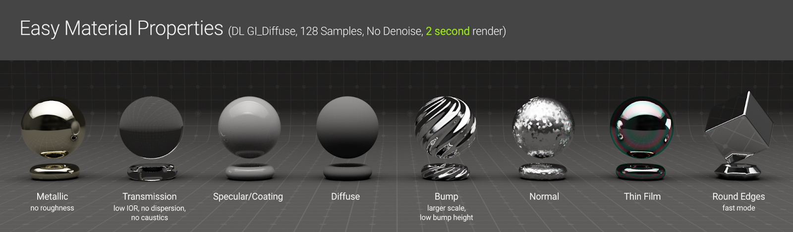

Material properties that are easy on the GPU
Probably the easiest thing for an engine to render is the Reflection in a metallic or glossy surface with no roughness or diffuse contribution. Those calculations happen so fast that they barely register on a modern GPU, and resolve cleanly with even 1-4 samples sometimes.
Fairly low IOR Transmission calculations (realistic glass or water without roughness or dispersion, for example) also aren’t that bad if it’s just in one single object. If the IOR gets unrealistically high, or there’s lots of overlapping refraction, it can start impacting the render times and noise. This applies to Specular and Coating as well.
Anything with Diffuse contribution (Albedo, Diffuse, Basecolor) in a material takes a bit more time to calculate than reflection or even refraction. Diffuse surfaces usually need 32 samples at a bare minimum to resolve cleanly (without denoise, of course). This applies to Sheen (low roughness) as well. This still is pretty low impact overall.
Bump and normal maps by themselves add very little impact to a render. If bump maps have a tight pattern and high bump scale, it can start adding noise and hot pixels, but lower values and smoother bump maps resolve very quickly compared to displacement.
Thin Film and Round Edges (fast mode) are virtually free. Accurate Round Edges can add a little time depending on the scene and settings.

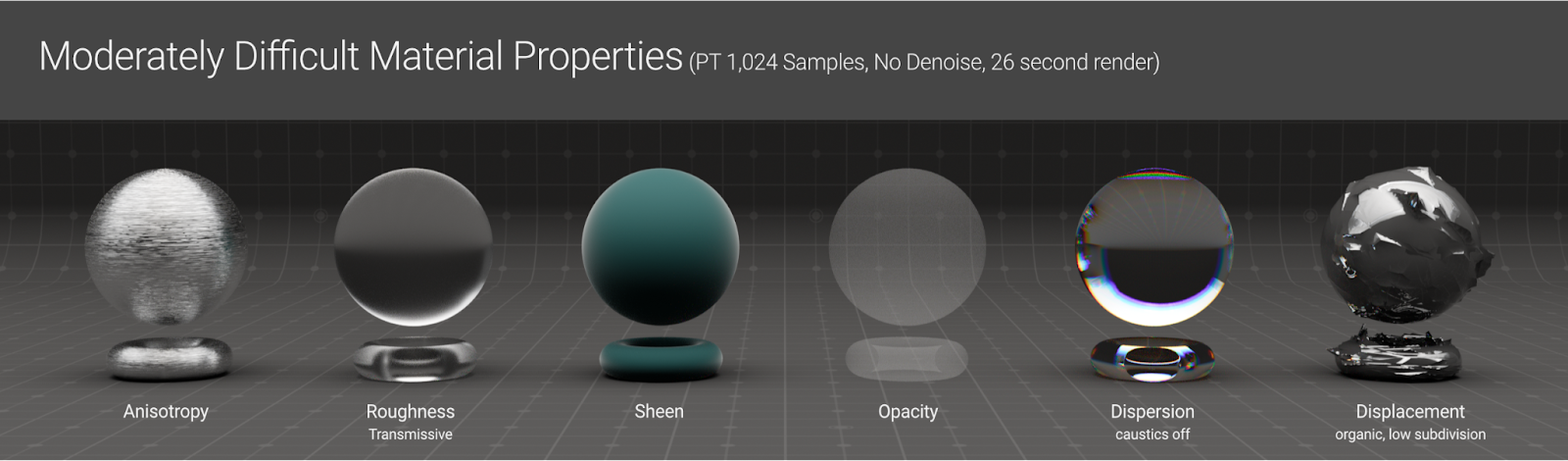

Material properties with moderate impact on the GPU
Anisotropy - especially with tight patterns like brushed steel - can take a while to resolve.
Roughness breaks up light and scatters it out, which takes time to calculate. It’s especially hard with refraction, but there’s a noticeable impact when high amounts are applied to reflection as well. This applies to Sheen too.
Opacity can take a little bit longer to resolve cleanly, depending on the rest of the material
Dispersion splits light into its component wavelengths as it’s traveling through an object making kind of a rainbowy effect. This is tough to calculate due to splitting light into its component wavelengths and can create noise and raise the render time pretty considerably, especially for lower Abbe values (stronger effect).
Low Detail Displacement with low resolution textures and/or low subdivision levels adds a little time to calculate, but it’s not too bad. The higher the settings, the more pre-processing and render time it takes.

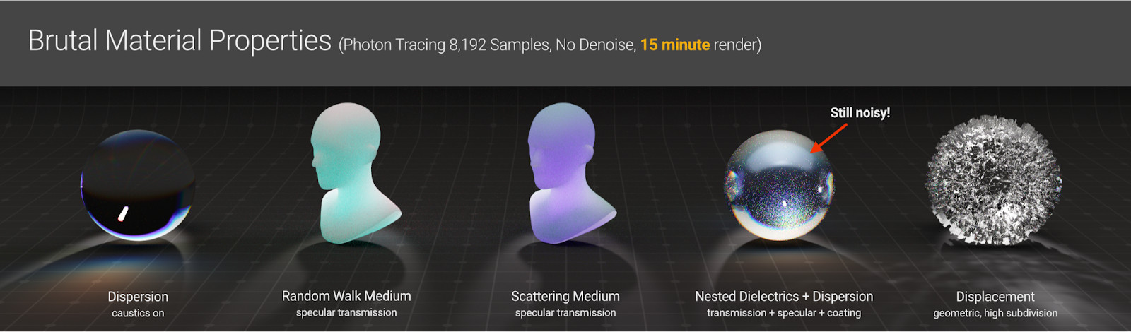

Material properties that are brutal on the GPU
Caustics is the result of light bouncing off/through a reflective or refractive surface onto a diffuse one. This adds significant render time to clean up nicely. Dispersion adds even more calcs to caustics. There’s a Guide here.

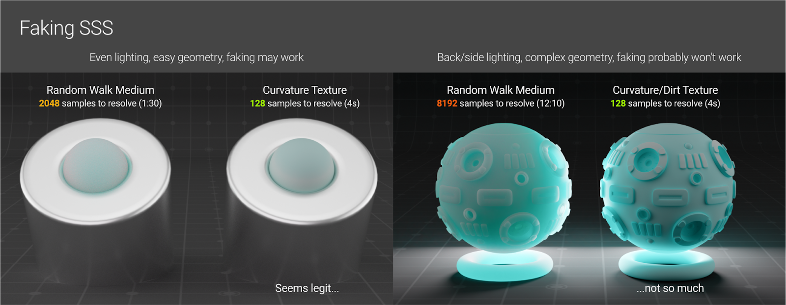

Scattering - All the calculations of light bouncing around inside an object with a Random Walk or Scattering medium (especially with Specular Transmission) take a while to resolve. Guide here.
Nested Specular Properties are very hard on the GPU. This means either stacking a bunch of different reflective or refractive material properties on top of one another within one material (like specular and/or coating on top of transmission), or nesting objects in our scene with these properties (like ice cubes in water). Add dispersion or scattering and we’re in for a wait.
High Detail Displacement with tight patterns that need high subdivision values can drastically increase render times, mostly because of the massively increased polygon load on the scene. There’s a guide series on this. Unless we’re doing a super tight macro shot, we can and should fake a lot of the smaller details with bump.

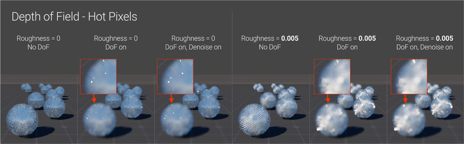

Effects like Depth of Field and Motion Blur are difficult on the GPU and need a whole lot more samples to resolve cleanly.
Small, strong reflections are particularly difficult to calculate and can cause hotspots with DoF on as seen in the example above. This can happen either because of sharp geometry like the spiked ball in the example, or because of tight bump map patterns with high bump depth. Denoiser in this case actually worsens the problem. Applying just the tiniest bit of roughness (0.005 in this case) is enough to negate it and give us nice bokeh circles.
