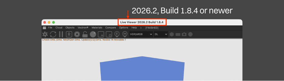

Before we even go any further, we need to make sure we’re on build 1.8.4 (or newer) of the Octane plugin. Prior to 1.8.4, color management was total hell. Now it’s partial hell. We can check this by undocking the Live Viewer and looking in its titlebar.
If we’re not on Octane 2026.2, Build 1.8.4 or newer, we can head over to the Otoy Downloads page and remedy this.

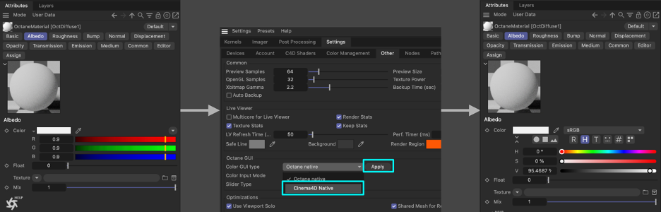

When we go to the Albedo channel (used to be called the Color channel, but all the channel names were recently aligned - 🙏 devs!!), we’ll see something unexpected if this is a brand new install - the color picker will only have R, G, and B sliders with a 0-1 range.
This is Octane’s linear RGB model. It’s great for some things, but confusing to longer term C4D users coming from other engines. In this exercise, we’re going to change it.
If we go into the Octane Settings (gear icon in the Live Viewer), into the Settings tab and Other subtab, we’ll see the option about halfway down to change the Color GUI type from Octane Native to Cinema 4D native. Let’s do this and hit apply.
Now when we click away from the material and click back in to refresh the Attributes manager, we’ll see the C4D picker we’ve been using.
Let’s add in our color (#6495ED ) in Albedo using the hex model, and replacing the standard blue material we were using with this new Diffuse material.

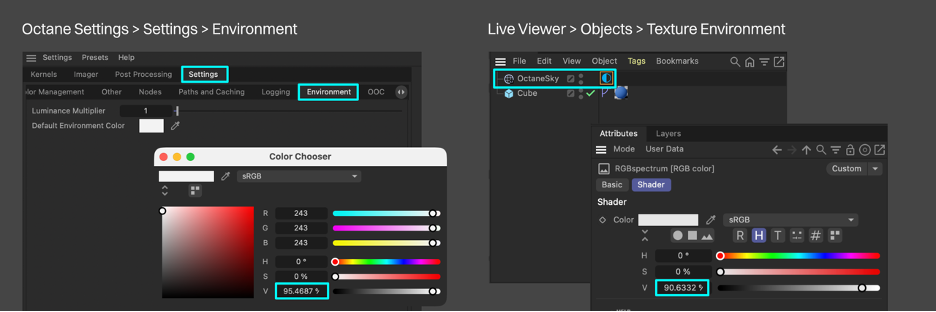

Turns out it’s because Octane has a default environment lighting the scene, and it’s not 100% white by default (it’s 95ish%). This means we’re shining a slightly dim light on it, so when it renders, it’s rendering slightly dim.
We can remedy this temporarily by making a new Texture Environment and changing change the color to H:0, S:0, V:100, or #FFFFFF if we’re using hex.
Excellent, now our cube can come out of the shadows and once again shine in all its #6495EDglory in the Live Viewer! woo :)

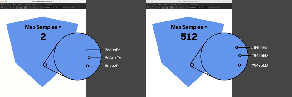

Max samples
Octane progressively renders each pixel. When it first starts, it very quickly sketches out an estimation of the final state of each pixel. These first few samples are really rough and inaccurate by themselves.
As we can see above (after zooming way in), at 2 samples, few if any pixels are actually #6495ED. When zoomed out, they visually munge together and average out and look about right, though.
After Octane progressively goes over the whole image several times, each pixel resolves more and more until either we or the engine decide that that particular pixel is “done”.
In this case, it took about 512 samples to fully resolve every pixel in the cube, and nearly all of them are now #6495ED. There may be a stray here and there, but the bulk of the field will be correct.

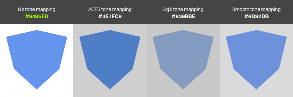

Tone Mapping in Octane
As we just saw, the Live Viewer matched the C4D un-tone-mapped Display Transform in the viewport. That’s because Octane defaults to no tone mapping (straight sRGB transfer function).
If we want, we can go into the settings and apply ACES Tone Mapping which would shift all our colors (because that’s what tone mapping does), and this would match the ACES 1.0-video Display Transform in C4D’s viewport if we had it set that way. Octane also has AgX and its own “Smooth” tone mapping options in the AOVs, or we can set up OCIO for other more advanced color space workflows.
Why would we want to do this if it shifts our colors? Well, if we’re just making a solid no-shading icon like this cube for a brand or a particularly fussy cube that really loves its color, we wouldn’t.
If we were rendering something more photographic with a ton of dynamic range that goes out beyond the bounds of sRGB, then we’d use it to wrangle in the values to get a better representation of all the data we generated, and avoid issues like blown highlights and banding.
Important: Any and all tone mapping would require fixing the final render in post somehow to maintain our Cornflower Blue color (#6495ED) exactly.

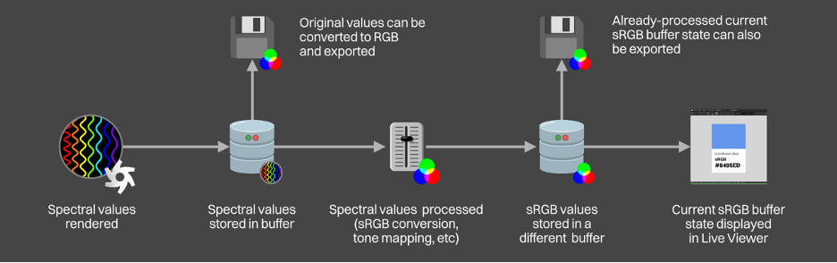

Octane gathers all the scene data, does a bunch of internal calculations and prep work, and then starts progressively rendering.
Once it builds up enough data, it stores the values it created in a buffer (designated area in memory). As it completes more of the render and refines the image more, it overwrites the buffer with the new values. It keeps doing this until the max samples limit defined in the kernel settings has been reached.
Every so often, it transforms the current state of the buffer to sRGB using whatever tone mapping and other processing we decided on and displays that in the Live Viewer. As it renders, we see the image resolve and get better and better until we hit the max samples we set in the kernel settings.
At any point in this process, we can grab the current state from either buffer and export it. This can either be the transformed state we see in the Live Viewer, or we can convert the original spectral values to working color space values (Linear sRGB / ACEScg / ACES2065-1, OCIO), and export that.

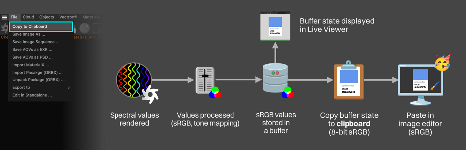

In the Live Viewer, the first command down in the File menu is Copy to Clipboard This takes the current state of the render as seen in the Live Viewer and copies it to the system clipboard as 8-bit sRGB values only. We can then paste it in an image editor or email or wherever.
Current state means:
- If there’s nothing in the buffer (like if we hit the [R] button to clear it or just never rendered anything in this scene), even if something is showing in the Live Viewer, nothing will copy to the clipboard. It won’t throw an error or anything, it just won’t work.
- If we had set our scene to use 5000 max samples, but got impatient and used this command while it was in the process of rendering and it was only up to 250 samples, the data in the clipboard will only be at 250 samples.
- The image will use whatever tone mapping we have applied (either none, or ACES tone mapping in the imager, or an OCIO one in the color space dropdown in the Live Viewer).
- If we have several AOVs, copy to clipboard will take the current AOV shown in the Live Viewer instead of just the beauty pass.
- If the Live Viewer’s resolution is not locked (using the lock icon in the UI), then the image will copy over in whatever size/aspect ratio the actual LV window is set to in C4D.
- If the resolution is locked and the first scale multiplier field is set to anything other than 1, it will copy whatever resolution it’s multiplied by. So if the render is 1000x1000px and that first multiplier is set to 2, the copied image will be 2000x2000px).
- If the resolution is locked, the second (zoom) multiplier will not affect what’s copied. So if the resolution is set to 1000x1000px, the first multiplier is set to 1 so it’s true to scale, the second zoom multiplier can be set to anything we want and the copied image will always be 1000x1000px.
- If “Alpha Channel” is selected in the Kernel settings and we see the transparency grid in the background of the Live Viewer, that literal transparency grid is going to copy with the image - the Live Viewer doesn’t support alpha.
8-bit sRGB values are going to be pasted into the target application. That application has to be ready to accept sRGB values, meaning either the current project is set to be sRGB, or the program knows that there are sRGB values incoming and can convert them to whatever color space the app uses.
Using all the C4D and Octane settings we’ve already established, using Copy to Clipboard on a 2025 MacBook Pro running C4D 2026.1.3 and Octane 2026.2 ver 1.8.4, our Cornflower Blue (#6495ED) survived the journey through the Mac’s clipboard and into Affinity Designer & Affinity Photo 2 (set to sRGB) and Photoshop 2026 (set to sRGB).

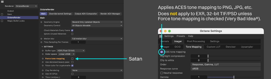

- Force tone mapping only applies to EXR and is a bad idea unless we have a VERY compelling reason to turn it on. It also defeats the point of EXR.

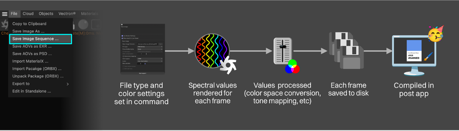

In the Live Viewer, the third command down in the File menu is Save Image Sequence… This pops up a box that lets us set some settings. When we hit “Start export”, it initiates a new render for every selected frame using a combination of the settings we just chose + the current kernel/imager settings and saves a series of files on our hard drive.
This works similar to how Save Image As… works, except:
- The frame range (and ONLY the frame range) is determined by a checkbox in the popup called “Use Render Settings”. If it’s off, every frame in our scene renders. If it’s on, it takes the frame range from the C4D render settings in the Output section. This does not affect other render settings like resolution, etc.
- Our only file type options are PNG and EXR.
- Weirdly, we can choose different color spaces for PNG - don’t do this. Leave it at sRGB. Also weirdly we can still choose sRGB as our color space for EXR. Again, never do this (even though it’s the default in this scenario). EXR should always either be Linear sRGB or ACEScg (or ACES2065-1 if we absolutely need that for some reason).
- Again, avoid force tone mapping unless you really need to do this for some reason (it only affects EXR)
- Resolution settings are taken from the C4D output. They are not affected by the “Use Render Settings” checkbox or the lock/unlock resolution or multipliers in the Live Viewer. If the frame is set to 1000x1000px in the C4D output settings, it will always render at 1000x1000px.
Like Save Image As, our sRGB PNG files will open fine in our post app when we go to compile our frames and our Cornflower Blue color will be preserved.
Also like Save Image As, our EXR files will open fine in our post app, but it needs to be told which color space we rendered as, and which transfer function to use. If it’s straight sRGB with no tonemapping or additional processing, our Cornflower Blue will be preserved.

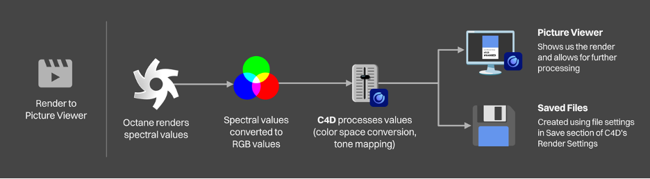

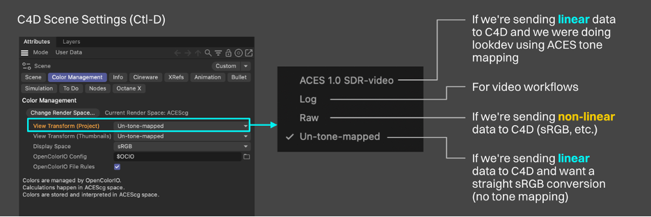

What we’re looking at here is using C4D rather than Octane to initiate and process a render. C4D has a few ways of doing this including render to picture viewer, add to render queue, make preview, and takes. All of the concepts we’re going to look at here are valid for all of those things, but we’re going to focus on Render to Picture Viewer here to keep things as simple as we can.
In a nutshell, what happens when we use one of these commands is that C4D tells Octane “hey, the user just asked for a render”. Octane is all “coming right up” and generates spectral values and puts them in a buffer. C4D can’t process spectral values, so Octane needs to convert them to RGB ones.
It then passes those RGB values over to C4D which stores them in its own buffer, and then processes them (converts to a display color space, applies tone mapping, and whatever else we told it to do). Finally it saves the image to a file and/or sends it to the Picture Viewer.
Let’s look at the save functionality here - the Picture Viewer and its settings is a whole other beast that will feature predominantly in Book III of this series.

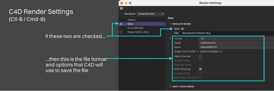

C4D’s Save Section
C4D users who have used Standard, Physical, Redshift, or some other engine should be somewhat familiar with the Save section. If we’re using one of these other engines, this is where we set the file format and path where the files are going to be saved to.

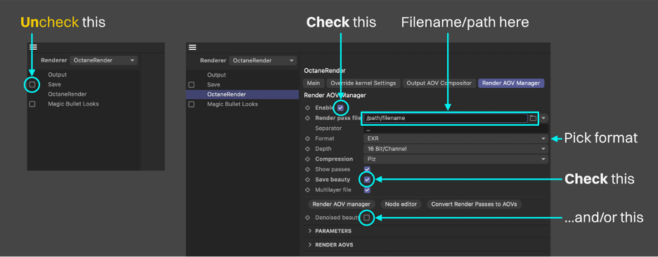

The entire section can be turned on or off, and within it, there are also individual Save checkboxes for the Regular Image, Multi-Pass, and Compositing Project File that can also be turned on or off individually. We’re going to ignore multi-pass and the compositing sections and just focus on Regular image.
Important: This entire save area in C4D’s render settings is not necessary for us Octane users, even if we’re using Render to Picture Viewer. We can use it, but there’s another way that we’ll look at later that avoids some of the issues we’re going to run into here.
When Render to Picture viewer is run, if both the Save section is checked and the Regular Image’s Save checkbox is checked, then all of the file format settings will be applied before C4D saves files in the path specified in this section. If either or both of them are not checked, Octane will still render and C4D will still process the data, but it’ll only send it to the Picture Viewer and not also save files.

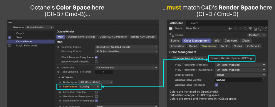

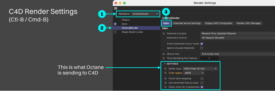

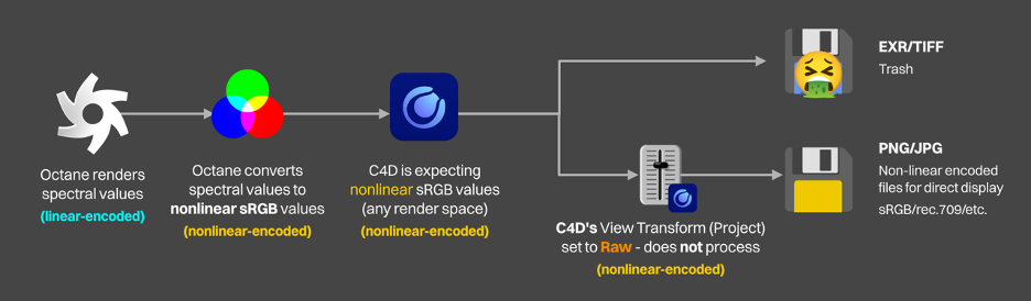

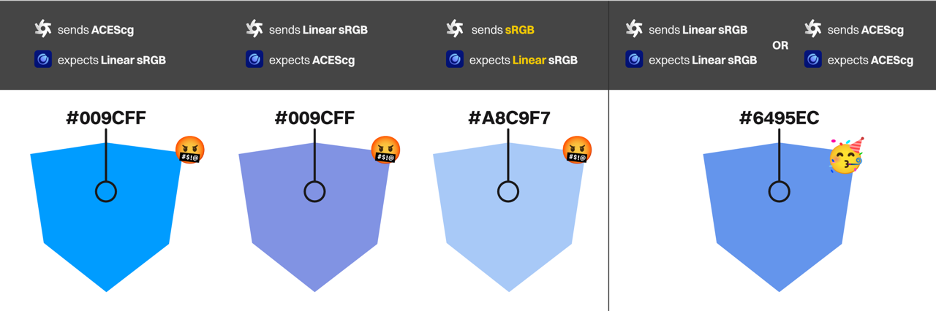

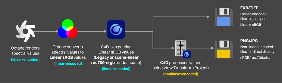

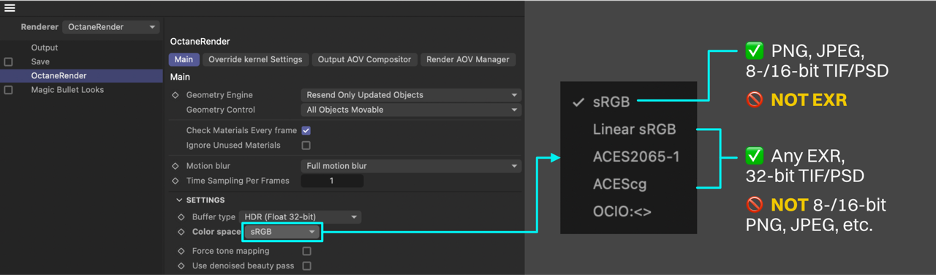

It’s been beaten into our heads already, but why not say it again: Octane renders spectral values. C4D does not understand spectral values. Octane needs to convert them to RGB values before it can pass them off to C4D.
But how does it know which color space to use?
This is found in the Color space section in the Main tab of the OctaneRender portion of the Render settings (Ctl-B / Cmd-B) when the Renderer is set to OctaneRender.
Working Color Space Matching
Important: This is the biggest pitfall in the whole process. The key takeaway here is that the Color space setting in the Main tab of the Octane Render area of the C4D Render settings MUST match C4D’s Render Space settings in the Color Management tab of C4D’s Scene settings. If it doesn’t, we’re in for a world of hurt when we go to save files.
The reason these need to match is that C4D isn’t actually aware of what color space Octane is sending data in. It just sees it as garden variety “linear” data. It knows what it’s expecting though, and that’s the working color space in the current Render Space.
This is what it looks like if they don’t match:
ACES <-> sRGB makes sense, but the big gotcha here is going to be when we want to export either Linear sRGB source files or regular old non-linear sRGB display files. These two color spaces are going to require very different settings, and as we can see above, getting that wrong means our cube will go 🤬, and we don’t want 🤬, we want 🥳.

The last step of the process is where C4D does any transforms or other processing, bundles up the data into the file format we picked and bakes it into the saved file. It also passes this setting to the Picture Viewer, but it can be changed there after the fact.
This is going to be different depending on whether we’re exporting source files for post (linear-encoded ones using ACEScg, Linear sRGB, or some other working color space), or display files (non-linear encoded ones using sRGB or some other display color space).
Source files
If we’re sending linear-encoded data (ACEScg, Linear sRGB, etc) to C4D, and saving EXRs or other formats that support 16- or 32-bit linear-encoded float data, C4D will not do any processing or tone mapping. It’ll just send the data straight through to EXR without even checking to see if it’s in the right color space (that’s why it’s so important for us to set it right).
In this case, it does not matter what the View Transform is set to here - it won’t affect the saved file. It’ll be up to the post app to apply the processing, and only then will we see if Cornflower Blue was maintained.
Display files
When saving lower bit depth non-linear data, C4D will process whatever data it gets from Octane before shoving it into a JPEG or PNG or some other integer-encoded format. This processing includes a color space conversion and tone mapping.
The settings for how C4D will do the color space conversion and apply tone mapping are found in the C4D Scene Settings (Ctl-D / Cmd-D) under the Color Management tab in the View Transform (Project) settings.
Our options here are:
ACES 1.0 SDR-video, which is equivalent to ACES Tone Mapping in Octane if we were using that for lookdev. If we’re sending linear-encoded data from Octane, ACES tone mapping won’t be included in this (by default - we can override this, but shouldn’t). Instead, C4D takes the unprocessed linear values, uses the ACES RRT+ODT (what we call tone mapping), and creates lower bit depth data to put into a PNG, JPEG, or something like that.
Log is for video workflows. We’re not going to cover that here.
Raw doesn’t process the values and sticks them into a PNG/JPG as-is. This means we need to send already-processed values from Octane (sRGB). There are cases where we’d want to do this, but usually we’d rather have Octane send linear-encoded data and have C4D process it if we’re using its pipeline anyway.
Un-tone-mapped, which is a straight sRGB conversion without tone mapping. If we are sending linear-encoded data from Octane (Linear sRGB, ACEScg, etc), and want to see our Cornflower Blue unchanged throughout the process, this is what we pick.

ACES Workflow
If we have C4D’s Render Space set to ACEScg, we need to tell Octane to convert its spectral values to ACEScg in the Color space setting in the Main tab.
Octane will pass ACEScg values to C4D which is expecting ACEScg values, and C4D will then do the transforms based on ACEScg.
If we’re saving an EXR, it will save it in the ACEScg color space - our post app will have to know to use that, and then when it does all the tone mapping and other processing, our colors will come out as expected.
If we’re saving a PNG/JPEG/etc, it will save in the sRGB color space using the tone mapping set in the View Transform (Project) settings. If it’s Un-tone-mapped, Cornflower Blue will be preserved. If it’s anything else, it’ll shift (as expected).
Linear sRGB Workflow
If we have C4D’s Render Space set to either Legacy or scene-linear rec.709-sRGB, then we want Octane’s color space to be set to >>Linear sRGB<< . Not. Not. NOT sRGB (HDR or LDR). Octane will send Linear sRGB values to C4D which is expecting Linear sRGB values, and C4D will then do the transforms based on Linear sRGB.
From here, it’s the same deal as ACEScg: EXRs will save as Linear sRGB and the post app will do the rest. PNGs/JPEG/etc. will save using the View Transform (Project) settings for tone mapping and other processing.
Again, un-tone-mapped will preserve the colors, anything else won’t.

Another thing we can do – if we need to – is to bypass C4D’s processing step and force it to just save whatever Octane gives it. The hybrid approach laid out in the next part of this guide is probably a better way if we’re not using C4D to process the images, but this will work if needed.
Any working color space (Render Space) will be fine for this in C4D’s Scene Settings, since we’re not asking it to take linear-encoded values and create non-linear encoded ones. We’re basically saying “just take this data exactly as-is and JPEGify it, thanks, good talk.”
Important: What’s crucial here is that we set Octane’s Color Space to sRGB in the Main tab (HDR or LDR, it doesn’t matter), and then make sure that the View Transform (Project) is set to Raw in the View Transform (Project) area of C4D’s Scene Settings. Raw is what tells it to pass the values through without altering them. It will look wrong in the Picture Viewer on a non-sRGB monitor, but it will save correctly.

We also have an option to use C4D to initiate the render, but do all the processing and saving through Octane.
Why would we want to do this?
One good use case is if we’re doing a multi-frame render for EXR and want Octane to save the files directly, but we want to keep an eye on a preview of each frame as it gets created.
We can tell Octane’s sequence exporter to send the current frame to Octane’s Live Viewer, but it doesn’t store past frames, so if we go away for a coffee and come back, we can’t look at an earlier section of the render. The Live Viewer allows us to store frames manually for A/B comparison, but we’re not going to sit there and wait for every frame to render and quickly mash that button before the next frame starts.
By having C4D initiate the render with Render to Picture Viewer, each frame will be stored in C4D’s buffer and fed into the Picture Viewer and we can easily scroll through them to check different parts of the render. The final exports will still be Octane’s job, but we’ll be able to keep an eye on what’s happening.
There are probably other workflows that involve takes and C4D’s render queue that would benefit from this, but this guide is already getting long.
Book III will look at the Live Viewer in depth, so we’ll just focus on the save portion of this process here.
Save settings
Both things we need to do here are in the C4D Render Settings (Ctl-B / Cmd-B)
First thing we want to do is turn off the entire C4D Save section by unchecking the whole thing. We do not want C4D writing any files.
Next we need to go to the OctaneRender section, and over to the Render AOV Manager tab. Even though we may not be doing anything that we’d probably consider “AOVs”, this is where these settings live for now.
Important: The “Enable” checkbox is OFF by default - we want this ON. If it’s off, Octane is not going to create any files. Since we unchecked C4D’s save section as well, this means no files will be written at all (they’ll all still be cached and go to the Picture Viewer though)
Next we can put our path in. This goes in the Render pass file box.
After that, we’ll need to choose our file type. It’s EXR by default since this tab is mostly about AOVs, but we can set it to PNG, JPEG, TIFF, or a few others, and then that opens up more settings for each format.
Finally we need to decide what to render. We’ll probably either want a beauty render (which is what we see as “Main” in the Live Viewer), or a denoised beauty render (what we see as DeMain in the Live Viewer if we’re using the denoiser). We can choose one or the other or both. There are reasons why we’d want both off, but that’s for another guide.
Important: We need at least Save Beauty on OR Denoised beauty on (both will work too) in order for Octane to write a file to disk.
If we’re rendering EXRs, TIFFs, or anything else that allows for multiple layers, and we have both Save beauty and Denoised beauty on, they’ll come in as two layers in a single file. If we have it off, Octane will generate two files - one for each.

High bit depth “source” files
If we’re saving EXR files (or 32-bit TIF/PSD which are float-encoded): We need to go into the Main tab again and pick ACEScg, ACES2065-1, or Linear sRGB (we’re not covering OCIO here).
VERY Important: What this should NOT be set to for EXR or 32-bit TIF/PSD files is sRGB - that will clip the values , which will destroy the file. Yes, it’s the default, but it’ll wreck our files, so we really want to avoid it.
Once again, Force tone mapping should be off 99.9999% of the time. There may be some point in our careers where we come across a situation where this is needed, but today is not that day.
Lower bit depth “display” files
If we’re saving an 8- or 16-bit integer-encoded file like a PNG, JPEG, etc, THIS is where we’re going to want the color space set to sRGB (or some sort of OCIO setup).

Tone Mapping
Tone mapping will not be baked into high bit depth (float-encoded) file types like EXR or 32-bit TIF/PSD unless “Force Tonemapping” is checked in the Main tab.
AGAIN, DO NOT DO THIS unless you seriously know what you’re doing and have a very good reason why you have to. Forcing tone mapping to a high bit depth file destroys data which defeats the point of having high bit depth files in the first place. These files exist so the tone mapping/transfer function/processing is done in the post app instead.
Force tone mapping only affects EXR (or other 32-bit formats), not PNG, JPEG, etc, since those are getting some form of tone mapping regardless - no need to force anything.
The ACES tone mapping checkbox in the Imager will apply ACES tone mapping to lower bit depth file types like PNG or JPEG, or 8-/16-bit TIF,/TGA/PSD, etc.
For AgX tone mapping we either need to use AOVs or an OCIO setup (both out of scope for this guide). For Octane’s Smooth tone mapping, we have to use AOVs.
In this guide, we’re trying to preserve a color, so we don’t want tone mapping. We want Cornflower Blue, and we’ll get this either by using sRGB and making sure ACES tone mapping is off (and the colors aren’t being altered using the imager or AOVs), or by using ACEScg/Linear sRGB, exporting as EXR, opening in post, and using that to do a hard sRGB conversion without tone mapping.
