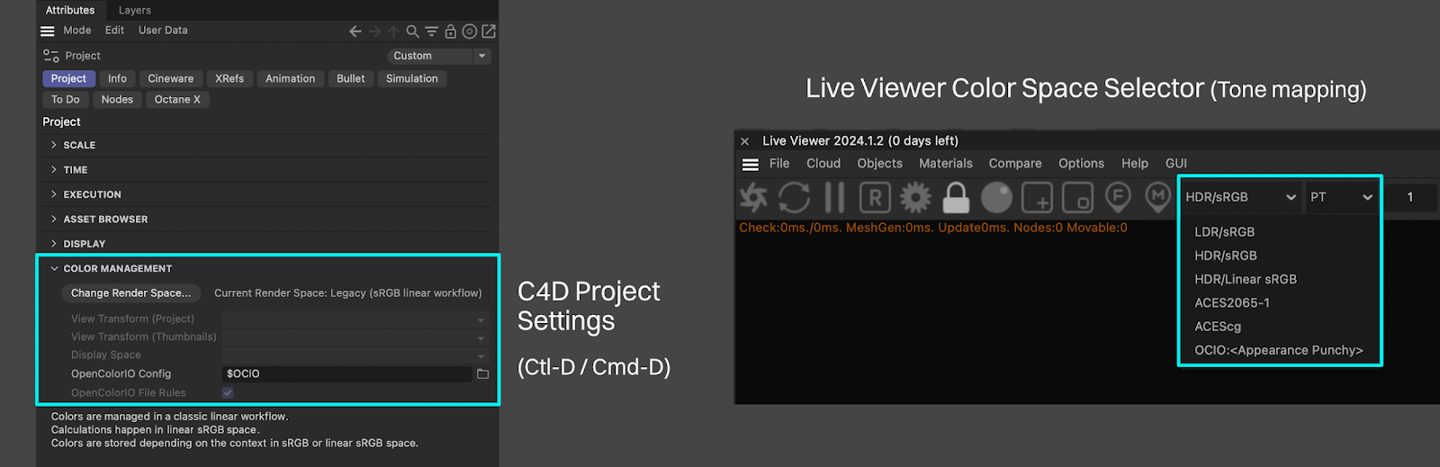

1. Color Management
It’s strongly recommended to read and understand the Color Management in Octane guide.
Octane itself already calculates and renders physically linear values, so there isn’t anything to set here. We can export our high bit depth EXRs as ACEScg or ACES2065-1 or some other OCIO color space if we know our post app needs that, and Octane will export the files correctly and independently of C4D’s color settings.
What we do have make sure of is that we have C4D’s color management settings set right so we don’t have any surprises between what we’re seeing in the Live Viewer and what we see in post. Almost all of the time, when we hit Ctl-D / Cmd-D to get to the Project Settings and look at the Color Management section in the Project tab, we’re going to want to use Legacy (Linear sRGB) unless we really know what we’re doing and have a good reason to change it.
We can then set up the Live Viewer to show us what the tone mapping will look like (ACES/AgX/non tone mapped, etc) when we apply the same transfer function in our post app.
☐ Check the Color Management settings in C4D’s Project Settings > Project tab
☐ Make sure the Live Viewer is set to show the same tone mapping / transfer function used in the post app (un-tonemapped sRGB / ACES / AgX / etc.)

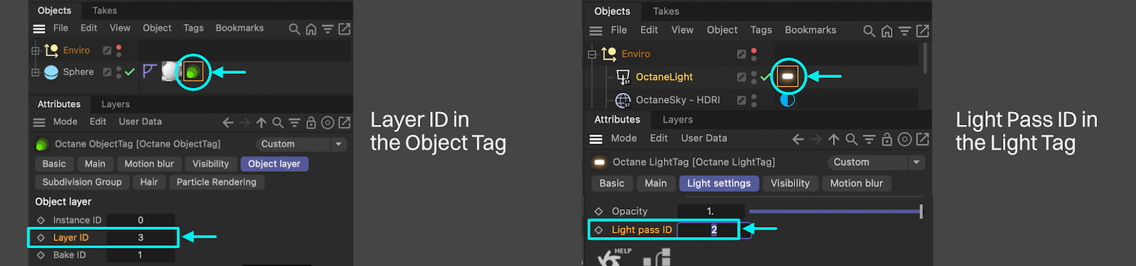

2. Prep the Objects
This is where we want to make sure our objects are set to the right IDs. For lights, this is done in the Octane Light tag. For objects it’s done in the Octane Object Tag.
☐ If exporting lighting AOVs, check each light’s Octane Light Tag and and make sure the Light pass ID is set properly.
☐ If masking objects, make sure each objects or materials is set up properly depending on the cryptomatte or render layer method used (more on that here)

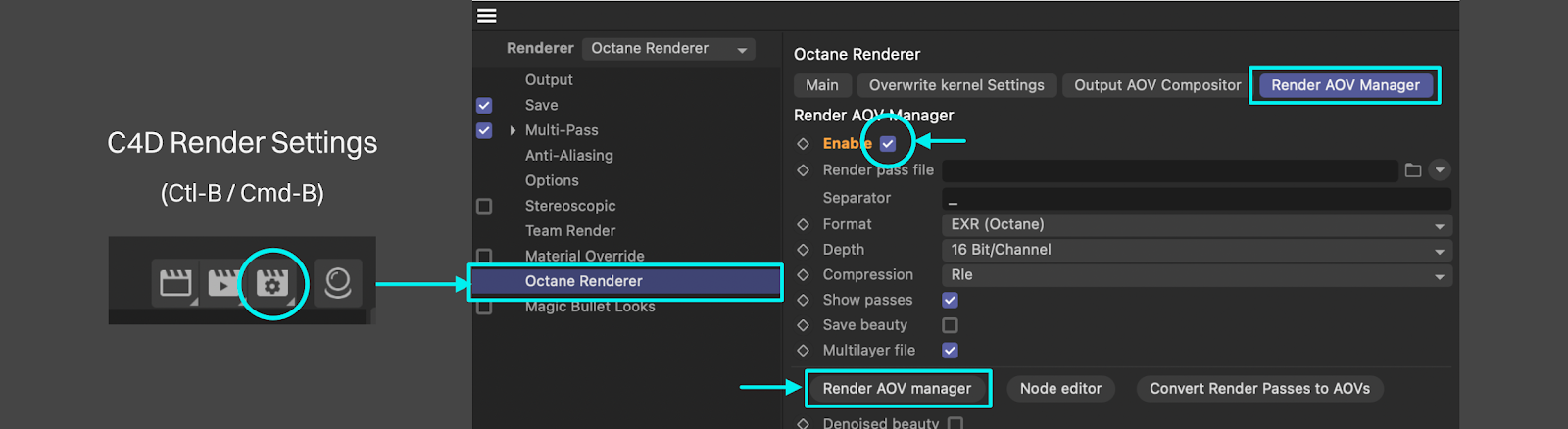

3. Set up the AOVs
All of the settings here are in C4D’s Render Settings > Octane Renderer section on the left > Render AOV Manager tab. The Render AOV manager popup window is accessible via a button in this tab.
More info on the passes themselves here.
General
☐ Important: Make sure Enable is checked. No Enable = No Render AOVs.

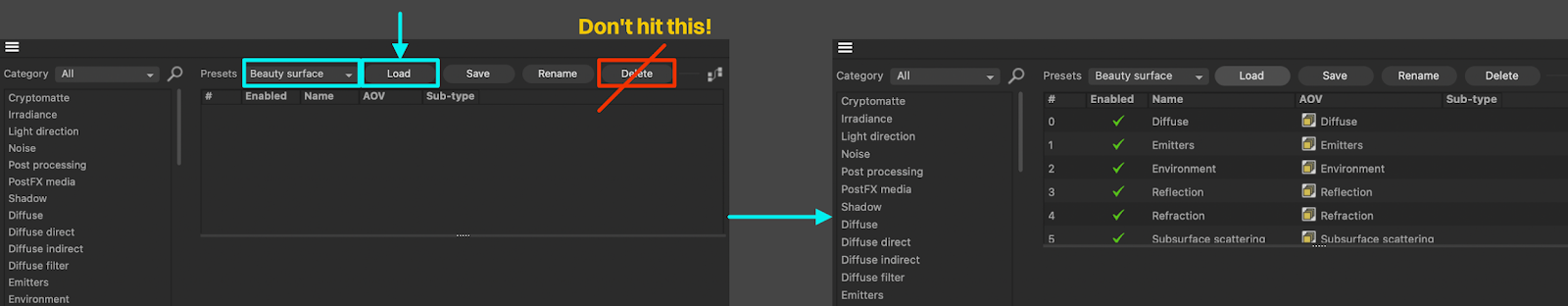

For a beauty stack, we need every pass that has some sort of contribution to the render. We can get a head start on this in the Render AOV Manager popup window by making sure “Presets” at the top is set to Beauty surface, and then hit Load.
Important: Don’t hit the delete button - that deletes the preset, not the selected AOV.
☐ Review all the standard passes in the Live Viewer, delete unneeded ones by selecting them and hitting the delete key on the keyboard, not the UI button.

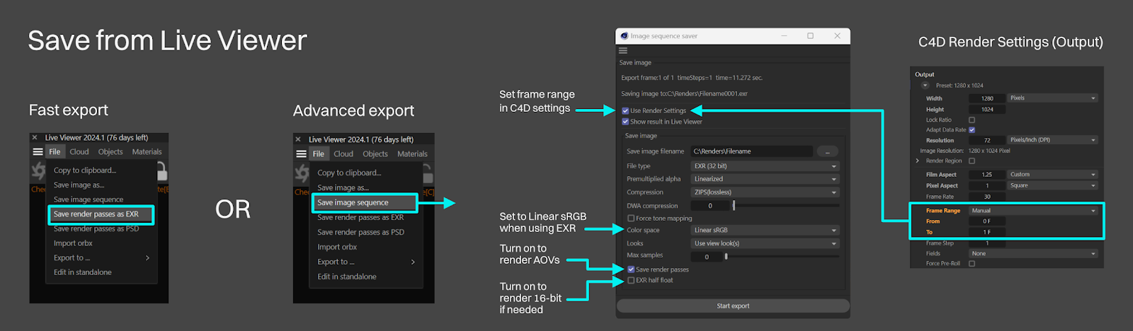

Live Viewer: Quick and dirty
If we pick Save Render Passes as EXR or PSD from the Live Viewer’s File menu, we don’t get options aside from naming the file. It saves a single, layered 32-bit ZIPS-compressed EXR or PSD for the current frame at the point where we stopped the render. If we want all the samples, we need to let the render finish first.
Live Viewer: More options, most stable
If we’re rendering using the Live Viewer’s Save image sequence, then we have some options to set.
☐ Set the frame range in the Output tab of the C4D render settings.
Important: This range must cover at least two frames as of this writing, otherwise Octane will render EVERY frame.
☐ Choose Save image sequence from the File menu in the Live viewer.
☐ Make sure Use Render Settings is checked - that pulls the frame range specified from C4D
☐ Pick a filename
☐ Choose EXR - probably 32-bit, but 16-bit may work for some scenes if drive space is at a premium. If 16-bit is needed, make sure EXR half-float is checked at the bottom.
☐ Choose a compression - PIZ is usually the best option for getting lossless files at the smallest size possible
☐ Choose a color space. Most of the time it should be Linear sRGB (not just sRGB - that will cause color shifting) unless we know for sure that the post app needs ACES or some other OCIO space.
☐ Important: Make sure Save render passes is on. If not, we’ll get a flat image.
☐ Start export

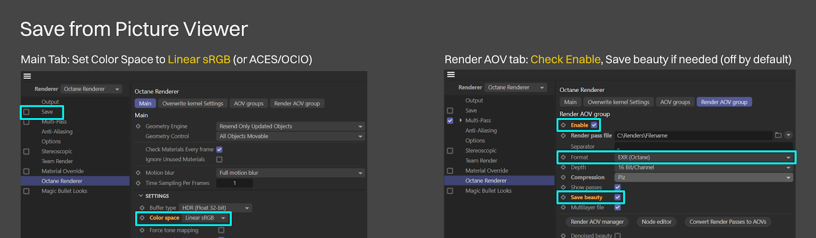

We also have the option to save from the C4D’s Picture Viewer. Most of the time this will work ok if it’s set up right, but there may be issues depending on the ever-changing versions of C4D and Octane.
The main reason to do it this way is that we can render each pass as its own file series rather than all the passes in a single EXR. The Picture Viewer also supports tokens.
☐ Make sure the Save section in C4D’s render settings is turned OFF
☐ In C4D render settings > Octane Renderer > Main tab, set the Color space to Linear sRGB (or ACES/OCIO if we know we need that for sure) - regular sRGB will cause unwanted color shifting.
Go to C4D Render Settings > Octane Renderer > Render AOV group for the rest
☐ Choose the path and filename
☐ Make sure Format is set to EXR (Octane), not just regular EXR
☐ Set the bit depth - 32-bit will give the best results, 16-bit may work in some cases
☐ Set the compression - PIZ is probably the best option
☐ Decide whether Multilayer File should be on or off - on means one multi-layer EXR per frame with each pass as a layer, off means one single-layer EXR per pass per frame. If off, a new setting appears to put each pass sequence in its own folder.
☐ Turn Save Beauty on or off depending on whether a full beauty render is also needed
☐ Turn on Denoised Beauty if desired
☐ Render to Picture Viewer
