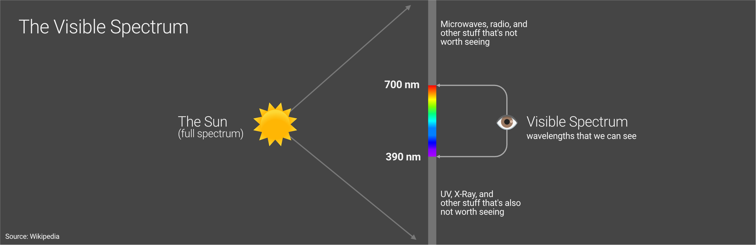

Light, scientifically speaking, is radiation that falls into a particular range of wavelengths that our brains and eyes can perceive. We call this range the visible spectrum. Radiation wavelengths are measured in nanometers. The visible spectrum starts around 700 nanometers and tops out around 390 nanometers (not exactly, but what we perceive at the very ends of the spectrum falls off pretty fast, so these are good values to peg it at).
Wavelengths toward the 700nm end of the spectrum appear to us as reds and oranges, and ones toward the 390 end as blues and violets. Greens are in the middle of the visible spectrum in the ~500nm range.

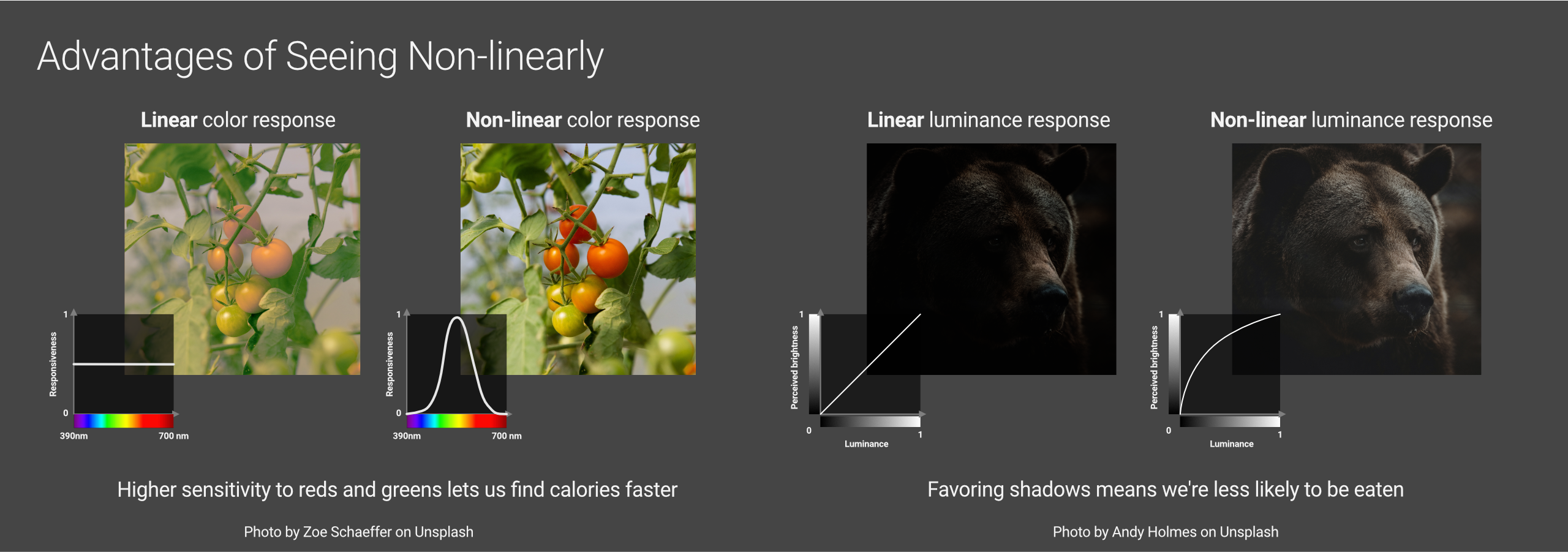

Non-linear Seeing
Our eyes and brains are NOT set up to perceive the world in a linear fashion.
This is going to be one of the biggest points of contention with color management as we go forward. Our eyes and brains don’t treat all wavelengths the same, and play favorites with light and shadow as well.
Why?
It typically boils down to two reasons - hunger and fear (also a little lust, but this is a family-friendly guide). Most of the things we either want to eat or avoid have traditionally been red, yellow, and green against a mostly green backdrop. A slightly more green or red thing might taste better, or a certain green, yellow, or red might be part of something that could poison us. The better we got at discerning reds, yellow, and greens, the more calories we grabbed and held onto in our intact, non-poisoned or mauled bodies so we could keep on living. Blue and purple stuff mostly just hangs around in the sky where we can’t eat it and it won’t kill us, so there’s no point wasting extra brain cycles processing subtle variations there.
Same thing goes for light and shadow. Dark things in dark places are far more likely to kill us than brighter things in broad daylight, so we can detect subtle changes in shadows far better than we can in brighter tones. Even more important for our survival, when it gets dark out, our sensitivity to these subtle changes in the shadows ramps way up. All this comes into play when setting up color management systems.

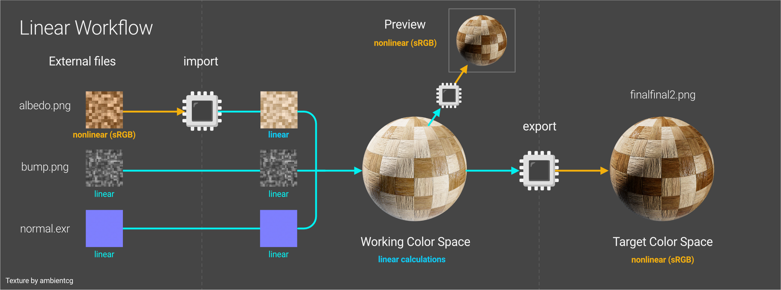

Linear workflow is a production workflow that allows us to import data created in a number of different color spaces (often non-linear), convert it to the editing app’s linear working space using the transfer function, edit it, and then encode the final output to the target color space using the appropriate transfer function.

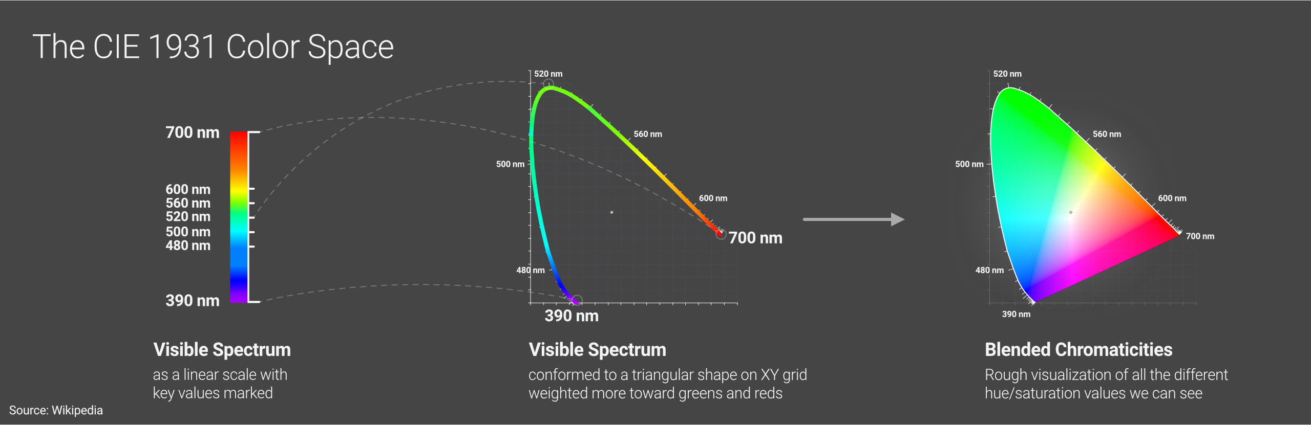

CIE Color Chromaticity Diagram
So, how do we represent a large gamut that we have no hope of displaying in its entirety in a meaningful way? In an ideal world, we’d have a three-dimensional diagram that shows all the possible hues and saturations on the X/Y axis, and all the luminance values in Z. That way, using a set of X, Y, and Z coordinates, we can find any color in the diagram. This has been tried, and it’s always confusing - Google Image Search “3D color space diagram” to see.
It’s much easier to see and compare gamuts in a standardized 2D diagram, even if it means massively simplifying it. In 1931, CIE created a diagram that we still use today to do just this. It gets around the difficulty of 3D by ignoring luminance values and only displaying hues and saturations (awkwardly called “chromaticities”). When we’re visualizing and comparing, we don’t really need to see the luminance values as much as the chromaticities, so the tradeoff is worth it.
Here’s how it works:
The visible spectrum is a linear range of wavelengths. It goes from ~390 nm to ~700 nm. 390 appears to us as violet, 700 appears to us as red. The CIE diagram takes that line and bends it into a triangular-ish horseshoe-looking curve with reds being in the lower right, greens being in the upper left, and blues being in the bottom left. This conveniently maps to the red, green, and blue receptors in our eyes that we use to determine color. It’s not a perfect triangle because - as we remember from part I of this guide - biology is nonlinear. There’s no “reddest red” or “greenest green” we can see - these are arbitrary points, so it makes sense to give it a little bend so there’s a range that we can map our digital color space gamuts to which do have these exact boundaries (we’ll see this soon). The shape is not an equilateral triangle for the same reason - we can discern a lot more greens and yellows than we can blues and violets, so it’s distorted in this way to let us plot more points in areas we can see better.
The inside of the horseshoe is then blended together to represent all the possible chromaticities visible to the eye. In additive color science, the more evenly R, G, and B contributions are added, the more desaturated the chromaticity gets until it becomes something approaching white.
So now we have an XY grid and an overlay of hues and saturations that we can plot points on. The scale goes from 0 to 1 on both X and Y, which allows us to choose values like 0.3388223, 0.2883357 and get extremely precise so we can individually define colors within the gamut at any level of accuracy we need.

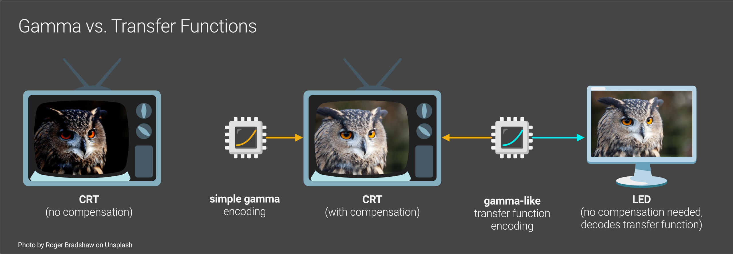

As promised, let’s talk about gamma. Back in ye olden dayes, the standard technology for a TV - and eventually a PC monitor - was a CRT display. CRTs do not reproduce light signals in a linear fashion because that’s how the tech works (Wikipedia for more on this).
We learned fairly quickly that If we just sent a linear signal, the CRT would produce a dark, muddy image due to limitations of the technology. To compensate, the analog signals we sent out were encoded using a simple gamma curve. This curve boosted the signal in the darker areas to compensate for the CRTs shortcomings - it was correcting the tech, not our eyes - and produced a more linear image that better mimicked reality and looked ‘right’ to us.
For a long time all the signals sent over the air, through cable, and eventually through VGA cables were encoded like this. Eventually we got better tech, though. Newer LCD/LED monitors no longer needed this compensation, but we couldn’t very well switch mid-stream and suddenly start sending signals encoded linearly, so we had to put something in place to make the two types of technology compatible.
The color management standards we developed to transfer nonlinear signals back to linear had to be based on these gamma curves. They weren’t exact because newer tech had some other challenges that had to be worked around, so we tweaked the transfer functions to cater to that, while leaving it close enough for backwards compatibility.
These particular gamma curves (and the transfer functions based on them) - by sheer coincidence - loosely follow the non-linear way our eyes see. We realized that because of this, we could ALSO use it as a form of data optimization. If we used these curves while encoding the digital signals to trash some highlight data to allow for the storage of more shadow data, we wouldn’t be wasting any of our precious (and very limited) bits on stuff we couldn’t really see well anyway. This led to better image quality and less data to store and sling around over our archaic modems and spinny disks, and it would still work if someone plugged in an old CRT. Win-win!
In the digital color management world, each color space has to define a transfer function. We ended up settling on one linear and three nonlinear ones.

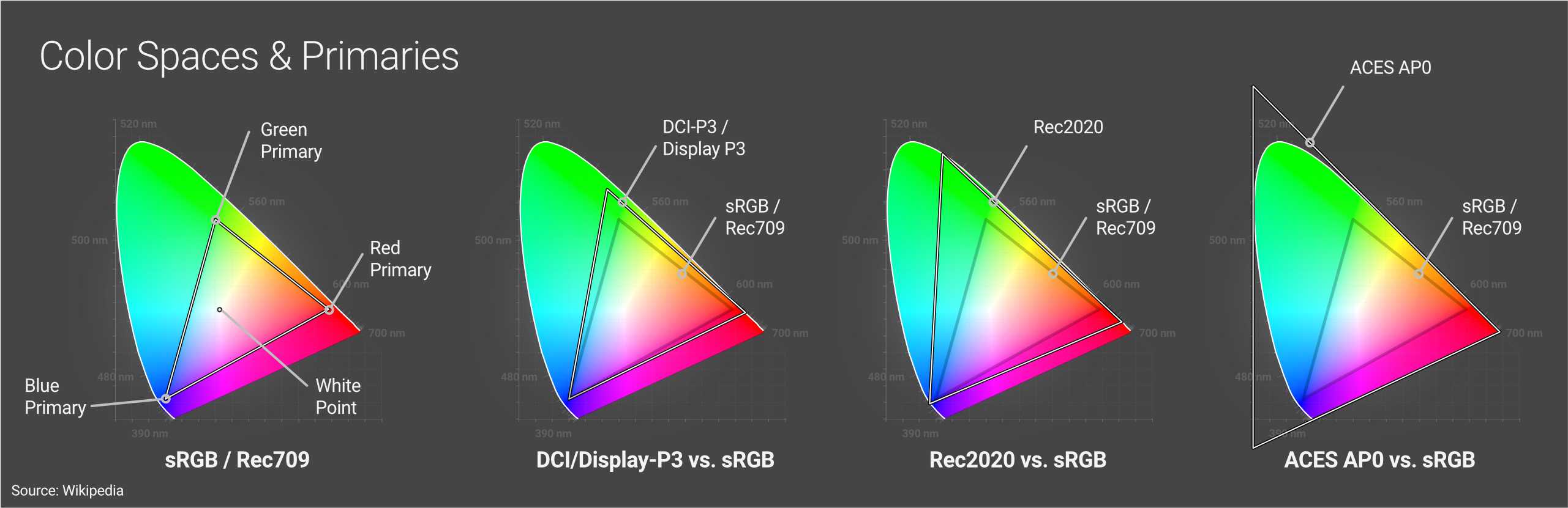

In order to convert between color spaces, all three of main components of a color space need to be addressed - the gamut, the transfer function, and the white point.
The white point is kind of its own topic, but if it hasn’t been changed around for creative purposes and the standard one for a color space is used (D65, for instance), then conversion to a different color space is fairly straightforward.
Linear Workflow
[Note on the illustration above: the color values don’t actually get brighter when converting to a linear space, it’s just that our tech is limited and our eyes are nonlinear, so sometimes it appears that way depending on how the app handles it. That’s why we need a preview window like a Live Viewer or Renderview to convert the values to the target display space while we’re working in the working space so we can see what we’re going to get on export.]
Most of the color spaces meant specifically as working spaces for content capture or creation use a linear transfer function. Linear transfer functions do not remap or alter the data - they store every value that the bit depth allows for. This is ideal for a working color space because the integrity of the data is maintained and it’s easier for the app to do proper light calculations.
Most (all?) of the color spaces meant for display use a non-linear transfer function for efficiency.
When using graphics tools, a linear workflow involves:
1. Importing source images or footage encoded in a non-linear color space and reversing (decoding) the transfer functions so they become linear...
2. Working with linear data in our working color space to produce correct calculations…
3. Previewing the data non-linearly in the final target space while working so we know what to expect…
4. Exporting to a target color space by encoding the data with the proper transfer function.
In the 3D space, this means:
- Making sure that our app knows what color space the imported images/footage is using - this ensures it uses the right transfer function. Sometimes automatic detection works, sometimes the files come with metadata that say what the color space is, but most of the time we should really manually set this.
- Setting up our tools so the Working Space is linear, but we can still view it in the way it’s meant to finally be consumed (also called a display transform).
- Picking the right color space when we go to export (also called an output transform). Most of the time this is sRGB if we’re directly outputting, or linear sRGB or ACES if we’re pushing to post, but sometimes we want to target something else.
