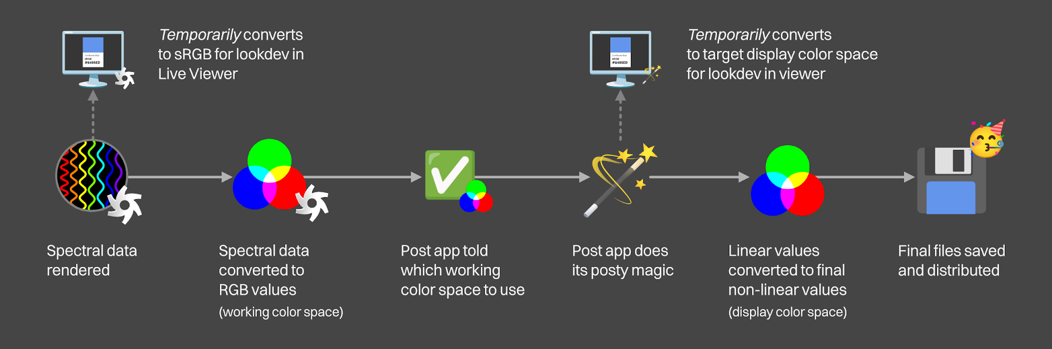

We make our 3D scene in our DCC (C4D in this case) and get Octane to render it.
Octane renders spectral data, and then temporarily converts it to (non-linear) sRGB values on the fly to preview in the Live Viewer so we can see what we’re doing. Tone mapping is applied just to the preview (not the final exported data) as part of this process to give a better idea of what we can expect later on.
Looks amazing, time to export to post.
Octane converts the spectral data to RGB values encoded in a standard working color space like ACEScg or Linear sRGB. Again, tone mapping is not applied here - that will happen in the post app.
Octane packages the converted RGB source files up and sends them to the post app (usually via EXR or TIFF files).
The post app is told which working color space Octane used when exporting the files (ACEScg, Linear sRGB, etc). It now has the right basis to work from so that everything down the rest of the pipeline is correct.
The post app then combines, composites, color grades, and applies delicious posty voodoo to make everything look polished, magically fix everyone’s problems, and save the day.
While it’s doing this, it temporarily converts the values on the fly to whatever our final target display color space is (sRGB, Rec.709, DCI-P3, etc.) so we can see what we’re doing. Our monitor is set to whatever our target color space is, and is calibrated properly - no surprises.
Post is done, time to ship it.
- The post app does its final conversion from the source working space values we were using for editing into the final display space values we’re going to use for distribution, applying whatever tone mapping scheme we were using throughout the process so they match the preview.
The final files are exported in the desired format, and we send them to the client on time and within budget. Everyone’s happy with the results, we immediately get paid, the work’s done, and we don’t need another round or two of “tiny” tweaks minutes before the deadline to make it pop more (idealized, remember?).

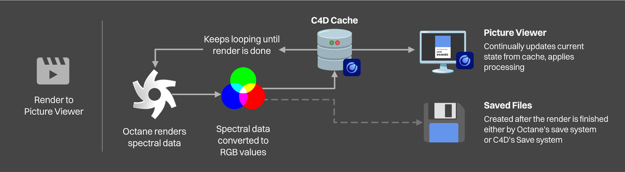

When we hit the Render to Picture Viewer button, Octane starts rendering and sends a stream of updated render states to C4D after every x number of samples are finished.
C4D stores the first state of a frame in a cache somewhere on disk, and overwrites it with a new version every time Octane sends one. This keeps happening until Octane hits the max samples and finishes rendering. Once a frame is completed, it moves on to the next one (if there is one).
Every time C4D receives one of these new states, it processes it. This involves doing any compositing/color work we have set up, and then applying a transfer function and tone mapping to preview our final output.
Important: Sometimes C4D can’t keep up with the processing, and we may encounter situations where we’re seeing the image appear either too washed out, too dark, or just plain wrong, but then suddenly it’s fine when C4D catches up. It’s important that we wait for this to happen before making any judgments about whether it’s working properly or not.
Independently of this whole caching/viewing process, the Render to Picture Viewer command can also trigger a save process when the render is complete and processed, which we saw in the previous book in this series. Again, we don’t need to save files when we Render to Picture Viewer - we can turn off saving from both Octane and C4D and just send a stream of data to the cache and it’ll show in the PV just fine.

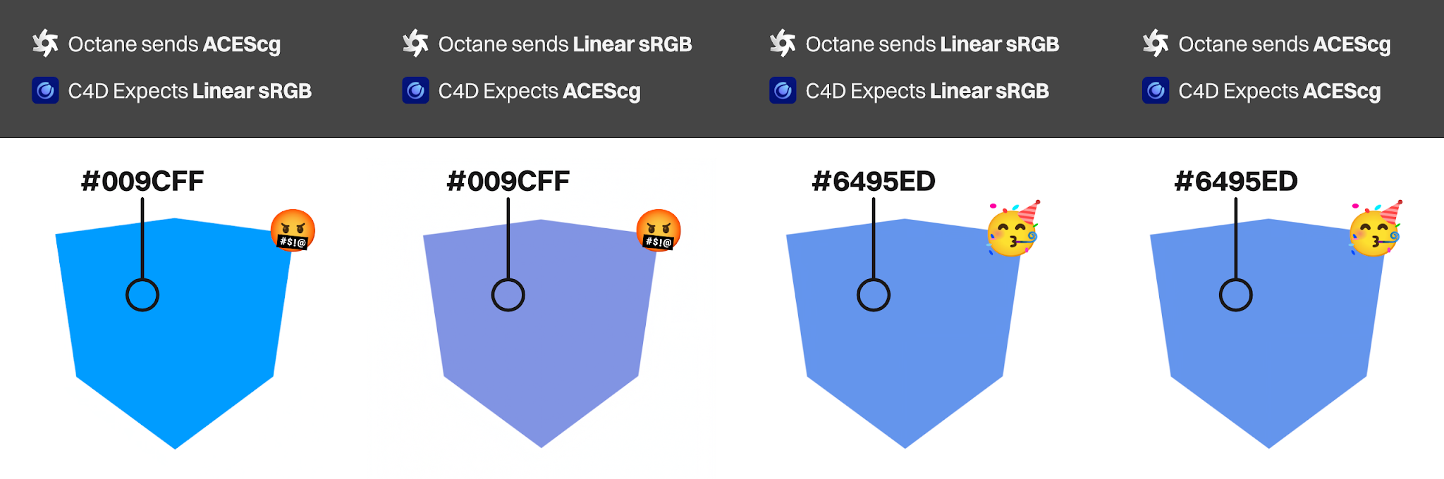

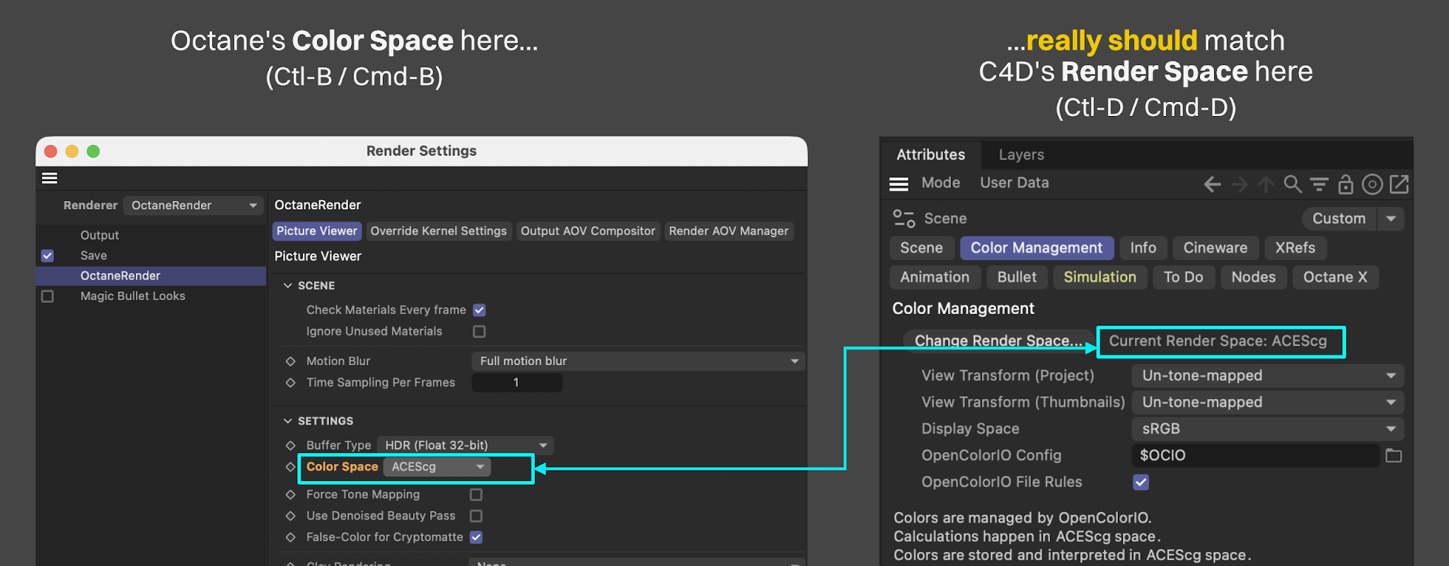

Step 1. Align the working color spaces
Why? We’re doing this so C4D knows what color space we exported from Octane. If they align, the render will stand a chance of looking right. If not, it’s going to be difficult (or impossible) to fix later, and our hero cube will be sad.
C4D
We’ll start with C4D and match Octane to it. If we hit Ctrl-D or Cmd-D to get into the Project Settings and head to the Color Management tab, we’ll see what C4D is using as its working color space. For reasons still unclear, Maxon decided to call this a Render Space. We decided before to use ACEScg for this project, so let’s make sure this is set to ACEScg.
Octane
If we hit Ctrl-B or Cmd-B, it pops open C4D’s Render Settings window. In the OctaneRender section (assuming we have our Renderer set to OctaneRenderer), in the Picture Viewer tab (which was called “Main” up until mid 2026), we’ll see the Color Space dropdown. This is what Octane will use when it’s sending data to C4D. Since we had ACEScg set in C4D, that’s what we want to pick here as well.
Why this matters
Important: These two really need to match. We will have the option to re-align them later, but it’s more annoying and we have better control over the situation if we just do this now.

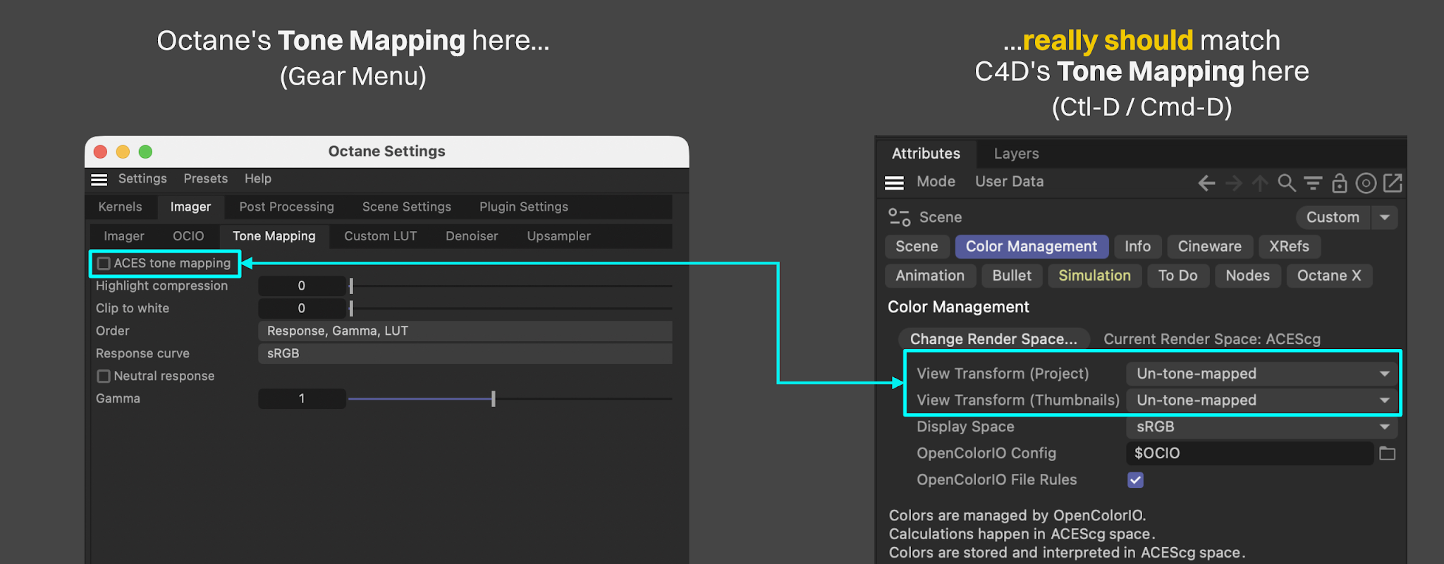

Here, we’re going to start with Octane and match C4D to it. Octane assumes sRGB for the display color space and no tone mapping by default. If we want ACES tone mapping, there’s a checkbox for it. If we want anything else, we need to dig into the Output AOVs or custom OCIO profiles (like for AgX).
In our case, we want to preserve our blue, so we want to go with the defaults.
C4D
The View Transform settings in C4D are in the Project Settings (Ctrl-D / Cmd-D), in the Color Management tab.
C4D also assumes sRGB for the display color space, but it does it in a separate dropdown with one option: sRGB. Presumably this changes if we use a custom OCIO profile, but we’re not, so we don’t worry about it.

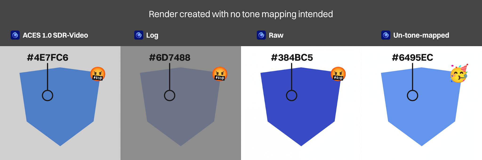

The tone mapping settings are in the View Transform (Project) and View Transform (Thumbnails) dropdowns in the Project Settings.
- ACES 1.0 SDR-video is the same as Octane’s “ACES tone mapping” checkbox
- We’re not going to worry about Log or Raw here.
- Un-tone-mapped is straight sRGB, which is the same as Octane’s defaults (without ACES tone mapping checked)
We want un-tone-mapped to preserve our blue.
Important: This is easier to fix later than a working space mismatch, but we don’t want to start going down a path of editing something only to realize we’re not looking at the same thing and have to redo it.

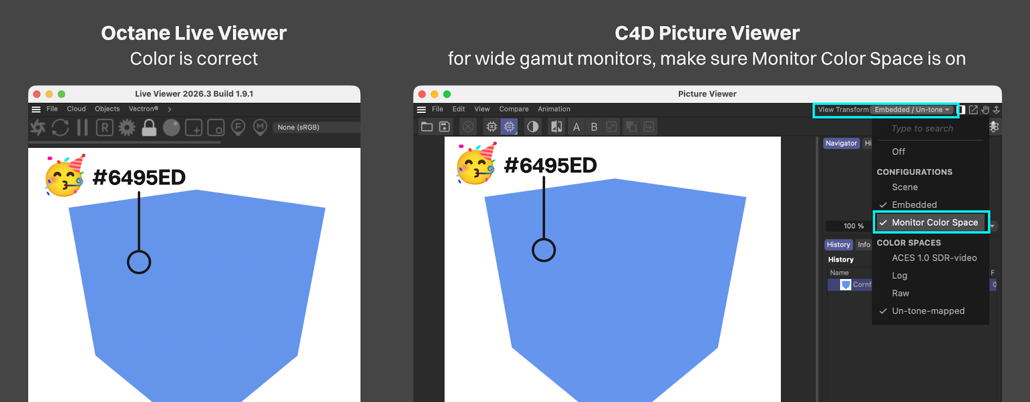

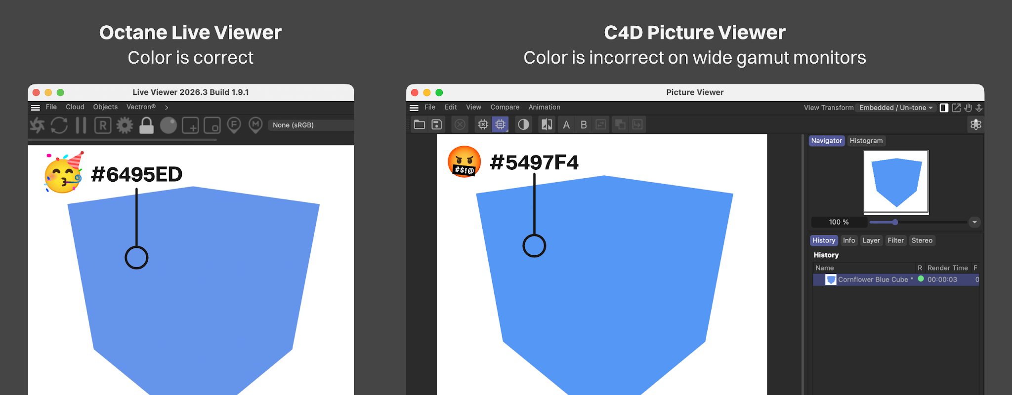

If we fire up the Octane Live Viewer, then we’re met with a #6495ED cube again, as expected.
Now let’s try rendering to the Picture Viewer by hitting the little clapboard icon thing in the upper right of the C4D interface.
At first blush, it may seem that this worked, and on some monitors it may well, but with a wide gamut screen like the one in the MacBook Pro the author is using, it’s once again a little off. A color picker shows that it’s really #5497F4, and that’s going to cause our cube to go into a tizzy.
Why. Oh why.
Step 4. Use Monitor Color Space
Right, because we learned in Book I of this epic crazy journey that C4D gives us the option to take our monitor’s color space into account. Octane automatically does this which is why it looks right in the Live Viewer, but C4D has it turned off by default for… y’know… reasons.
Let’s fix this.
All of the Picture Viewer’s color space settings are in the View Transform dropdown in the upper right corner of its UI.
We can see that it pulled in the correct tone mapping (none) in the astonishingly poorly named “Color Spaces” section of the dropdown. (Maxon, if you’re reading this, please align all your terminology - this is confusing enough as it is).
We can also see that Configurations is set to Embedded. We’re going to untangle this mess in a later guide, but for now we just need to know that it means that it’s using the settings we set in steps 1 and 2 of this section.
Finally, we can see that Monitor Color Space is off. Even if we somehow remembered that we could set this in the viewport settings (we probably didn’t), that setting doesn’t carry through to the Picture Viewer - we need to check it every time we use the Picture Viewer.
If our monitor is only capable of sRGB and isn’t wide gamut, then this doesn’t matter. If it is (and that’s most modern displays now), then this needs to be enabled so the colors appear correctly.
Our cube can dance a jig now - it made it all the way through to the end.

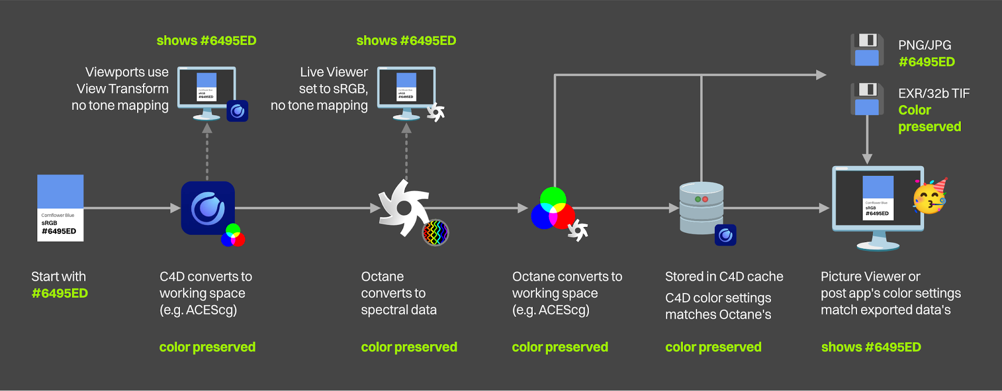

Now let’s look at the whole journey in fast forward:
We start off in C4D by using a color picker to choose our sRGB hex value (#6495ED) in a standard material:
- It gets converted to C4D’s working space (ACEScg by default) which changes its numerical values, but the color itself is still the same.
- It gets processed using C4D’s View Transform (Project) settings so we can see it in the viewport (and eventually for the render). Assuming this is set to un-tone-mapped, it stays intact, otherwise it shifts.
- If we have a wide gamut monitor, we need to tell the viewports to use our monitor’s color space in order for it to appear correctly while we’re working.
- We could render this to the Picture Viewer at this point, but it wouldn’t be an Octane guide if we didn’t use Octane now, would it.
Then we move to Octane where we use one of its native materials:
- Once again we input our sRGB hex value (#6495ED) into a color picker
- The color is once again stored by C4D and converted to its working color space (ACEScg, probably), and kept intact.
- When it comes time to render, C4D passes the ACEScg (or Linear sRGB or whatever) value to Octane which converts it again to spectral data, which still keeps the color intact.
- While rendering, Octane converts it again to sRGB without tone mapping (by default). It shows this to us in the Live Viewer, where it samples correctly as #6495ED. If we turn on ACES in the settings, or want to use AgX, Smooth, or some other tone mapping via OCIO or Output AOVs, the color shifts.
At this point we have a few options to save files out via Octane or C4D’s pipelines.
- We can export directly out to PNG or JPEG for client proofs or web/presentation use. If we keep the display color space at sRGB and don’t apply ACES or some other tone mapping type, our color will be preserved and sample correctly.
- We can export to EXR or sometimes TIFF to send to post. In this case we’ll be using a working color space still (ACEScg, Linear sRGB, maybe ACES2065-1) with no tone mapping. As long as the post app is aware of which space we used, it can process the render further and our color can remain intact.
We can also use the Picture Viewer as a rudimentary post app
- Rather than packaging up the data as an EXR sequence, Octane sends it directly to C4D in a cache.
- Octane needs to convert it to a working color space (ACEScg, Linear sRGB, possibly ACES2065-1) prior to sending it.
- C4D needs to know which color space to expect, since it can’t autodetect it, so we have to tell it in the Project Settings (Color Management > Render Space).
- C4D also needs to know not to apply tone mapping (un-tone-mapped in the View Transform settings).
- C4D also needs to have “Monitor Color Space” checked if we have a wide gamut (not straight sRGB) monitor.
- If all of these things line up, our #6495ED color is preserved and we can see it in the Picture Viewer window.
