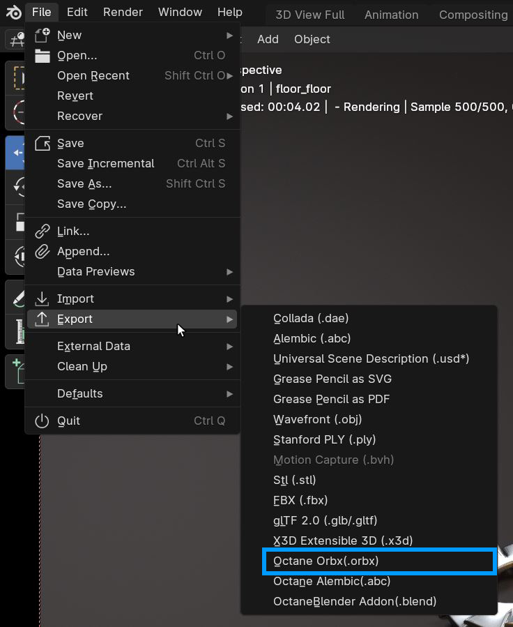

When using the Render Network in conjunction with Blender, the accepted output format is ORBX. A Blender scene can be exported in ORBX format from the File menu (figure 1). Additional tips for preparing Blender files for export as ORBX can be found in the Considerations for Exporting to ORBX section at the end of this document.
Figure 1: Exporting a Blender scene in ORBX format

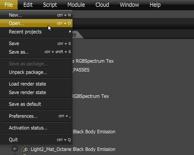

It is good practice to open the ORBX file in Octane Standalone to make sure everything from the Blender scene exported properly (figure 2).
Figure 2: Opening an ORBX file in Octane Standalone

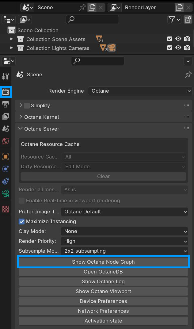

The Octane Node Graph Editor window can be used to select specific scene assets for export (figure 6).
Note: This method only exports a single frame, it does not export animation contained in the scene.
In order to access the Node Graph Editor window, the Blender Viewport must be in Rendered View mode (figure 7).
Figure 6: Accessing the Octane Node Graph window
Figure 7: Activating Rendered mode in the Blender Viewport

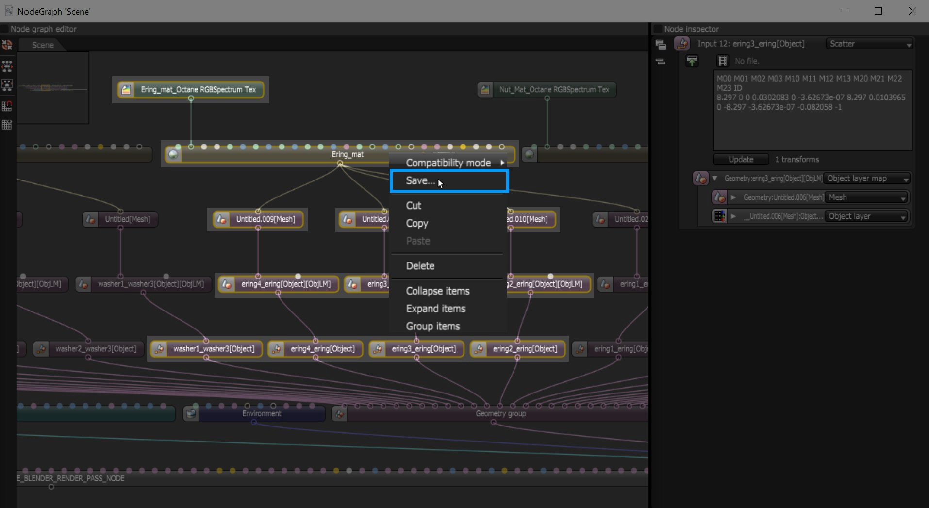

Specific scene asset nodes can be selected in the Octane Node Graph window and exported to ORBX by right-clicking on the nodes and choosing Save (figure 8).
Figure 8: Exporting specific nodes in the Node Graph Editor window

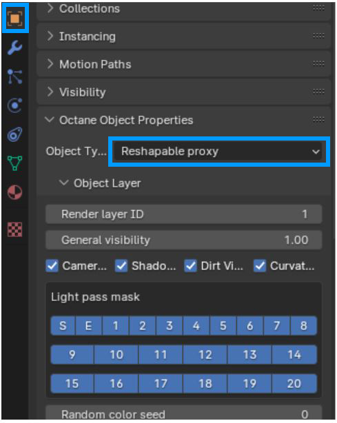

- Deforming mesh elements, for example; items with a modifier or a character rig may need to be set as a Reshapable Proxy (figure 9).
Figure 9: Setting animated objects to Reshapable Proxy
