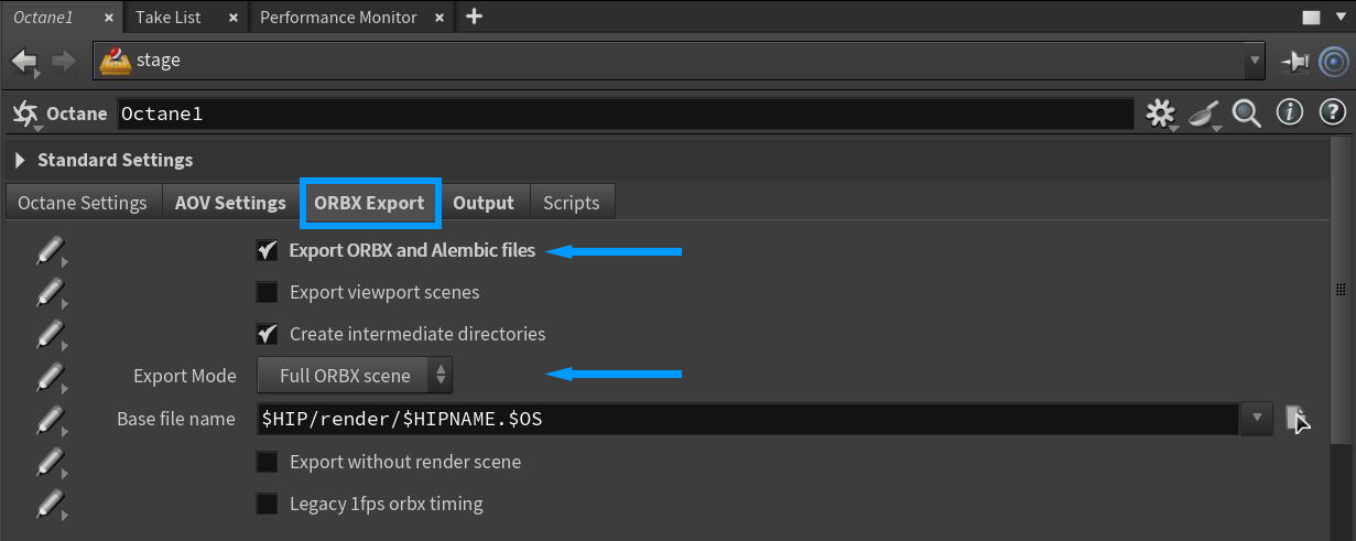

In the Octane Render Settings node, the Export ORBX and Alembic Files checkbox needs to be activated. The Export Mode option provides an option between exporting the entire scene to ORBX or to Alembic only. When preparing files for the Render Network, Full ORBX Scene should be selected (figure 2).
Figure 2: Choosing Full ORBX Scene as the Export mode

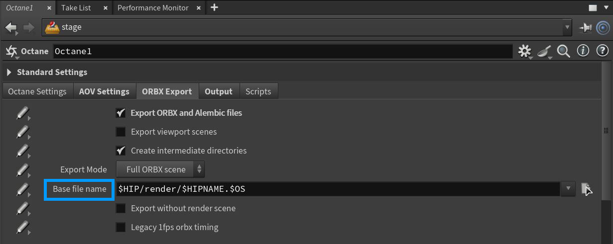

The file name and location for saving the ORBX export can be determined with the Base File Name parameter (figure 3). The .orbx file extension does not need to be added to the file name manually as is the case with typical of Houdini file saving conventions. The .orbx extension will be added automatically.
Figure 3: Naming and determining the save location for the ORBX export

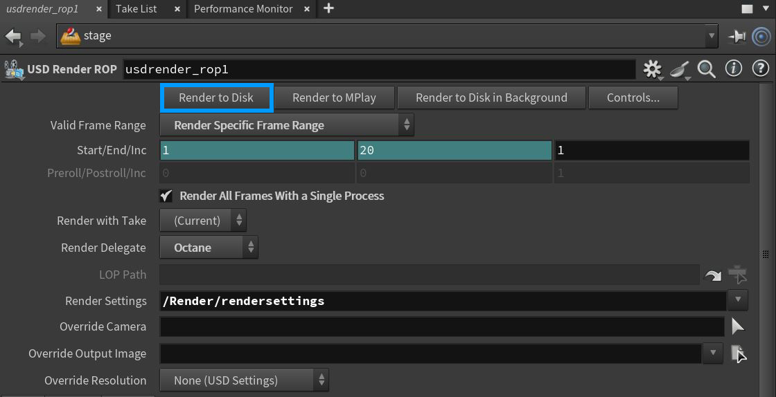

The Render All Frames With a Single Process should be activated in the USD Render ROP node (figure 5). Otherwise, Octane will not render all frames of an animated sequence.
Figure 5: Activating Render All Frames With a Single Process
The exporting of the ORBX file can be started by clicking on the Render to Disk button in the USD Render ROP node (figure 6).
Figure 6: Rendering to disk from the USD Render ROP node

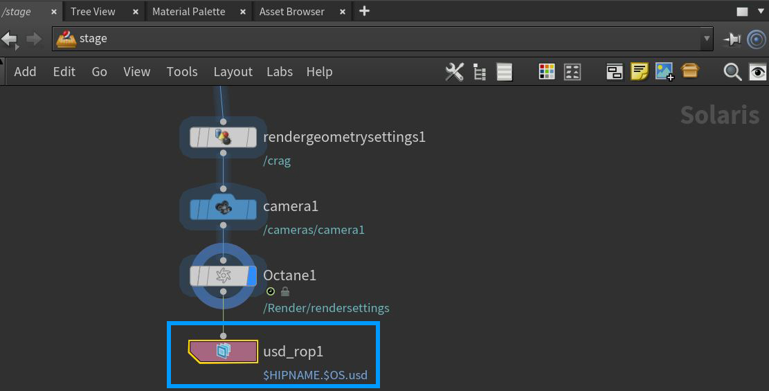

A Solaris scene can also be exported in USD format using the USD ROP node instead of the USD Render ROP node (figure 9).
Figure 9: Exporting to USD

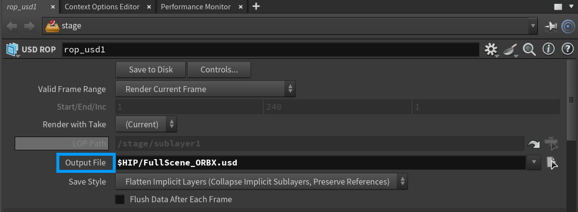

The Output File path in the USD ROP node needs to be set accordingly along with the .usd file extension (figure 10).
Figure 10: Setting the output path and .usd file extension

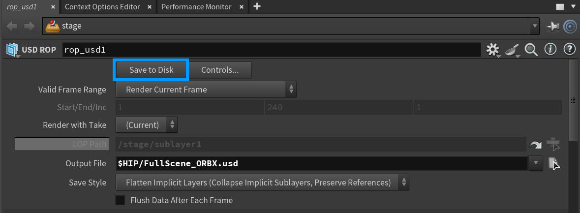

The exporting of the USD file can be started by clicking on the Save to Disk button in the USD ROP node (figure 11).
Figure 11: Saving to disk from the USD ROP node

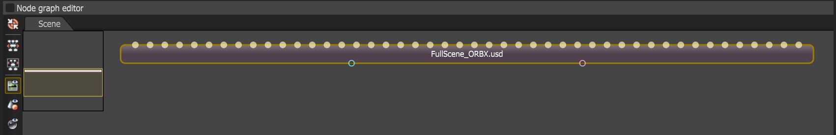

The exported USD scene from Solaris can be imported into Octane Standalone by dragging and dropping the USD file into the Standalone Node Graph Editor window (figure 12).
Figure 12: Adding the USD file to the Node Graph Editor window in Standalone

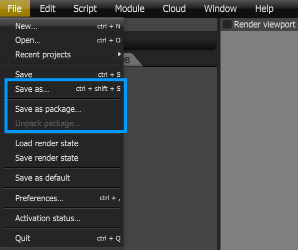

The scene can be saved in ORBX format by choosing Save As or Save as Package from the File menu (figure 14).
Figure 14: Saving ORBX scene from Standalone
