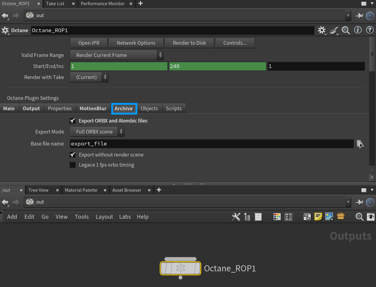

When using Render Network in conjunction with Houdini, the accepted output format is ORBX. A Houdini scene can be exported in ORBX format from an Octane ROP node menu (figure 1). Additional tips for preparing Houdini files for export as ORBX can be found in the Considerations for Exporting to ORBX section at the end of this document.
Figure 1: Exporting a Houdini scene in ORBX format

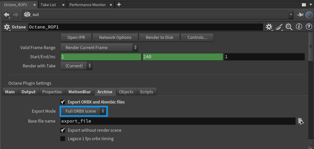

The Export ORBX and Alembic Files checkbox needs to be activated. The Export Mode option provides an option between exporting the entire scene to ORBX or to Alembic only. When preparing files for the Render Network, Full ORBX Scene should be selected (figure 2).
Figure 2: Choosing Full ORBX Scene as the Export mode

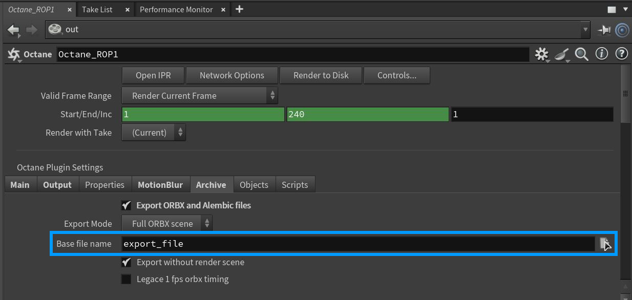

The file name and location for saving the ORBX export can be determined with the Base File Name parameter (figure 3). The .orbx file extension does not need to be added to the file name manually as is the case with typical of Houdini file saving conventions. The .orbx extension will be added automatically.
Figure 3: Naming and determining the save location for the ORBX export

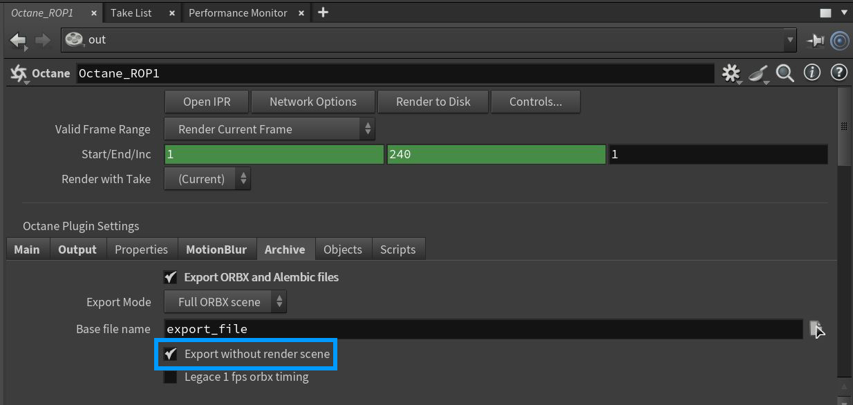

The Export without Render Scene should be activated to disable Octane from rendering the scene (figure 4).
Figure 4: Activating Export without Render Scene

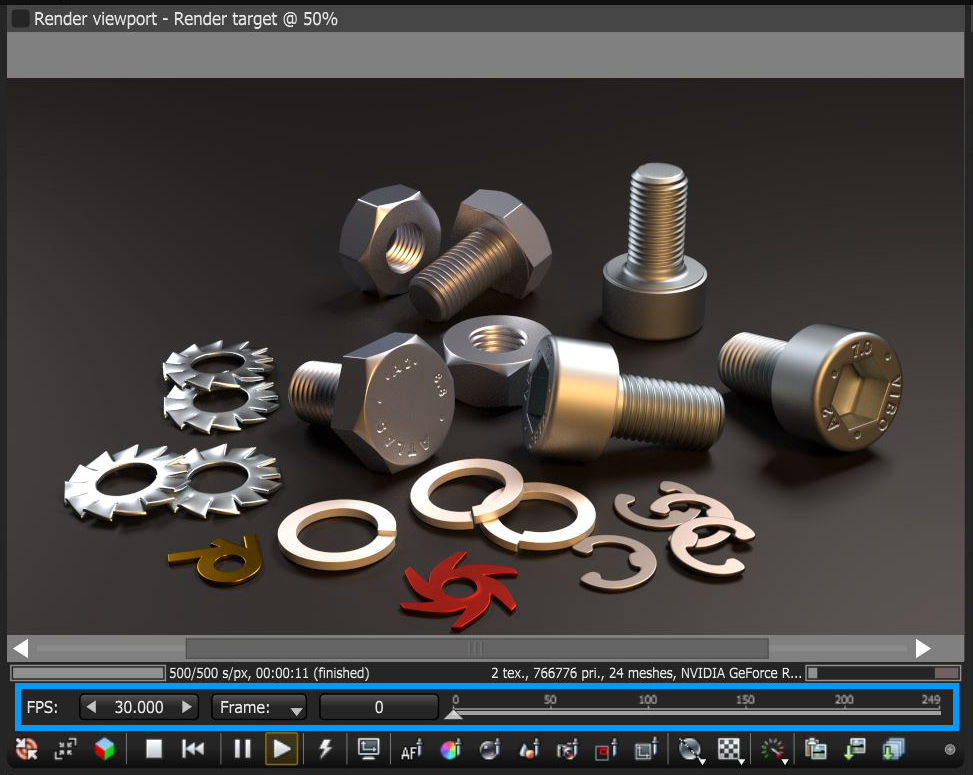

If the exported ORBX file contains animation, the timeline will be visible in the Standalone Render Viewport window (figure 6).
Figure 6: The Render Viewport timeline

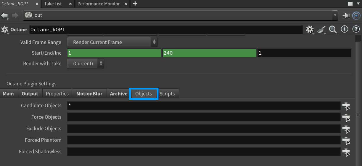

- The various Objects filters in the Octane ROP’s Objects tab can be used to filter what scene objects will be exported (figure 7).
Figure 7: Using the Object filters in the Octane ROP

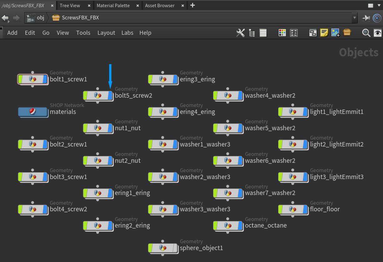

- Geometry nodes in the Objects network can be deactivated by turning off their Display option. Any Geometry nodes not being displayed will not be included in the ORBX export (figure 8).
Figure 8: Deactivating Geometry node Display status
