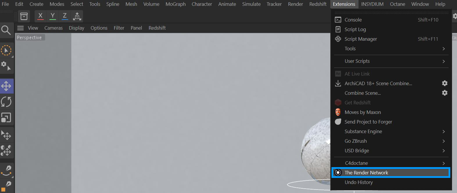

Once installed, the Wizard can be accessed from the Extensions menu (figure 1).
Figure 1: Accessing the Wizard from the Extensions menu

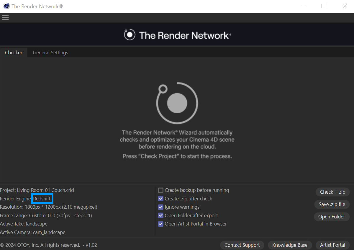

It uses a scene designed with Octane but the process is identical when using Redshift. The only difference is Redshift instead of Octane will be listed under the Render Engine entry in the Wizard window (figure 2).
Figure 2: Redshift is listed as the Render Engine in the Wizard window
