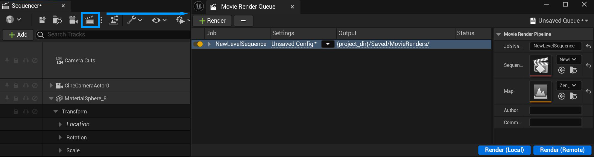

Once there is an active Octane render rendering in the Octane Viewport, the Movie Render Queue (MRQ) can be opened from the Sequencer window (figure 4).
Figure 4: Accessing the MRQ from the Sequencer window

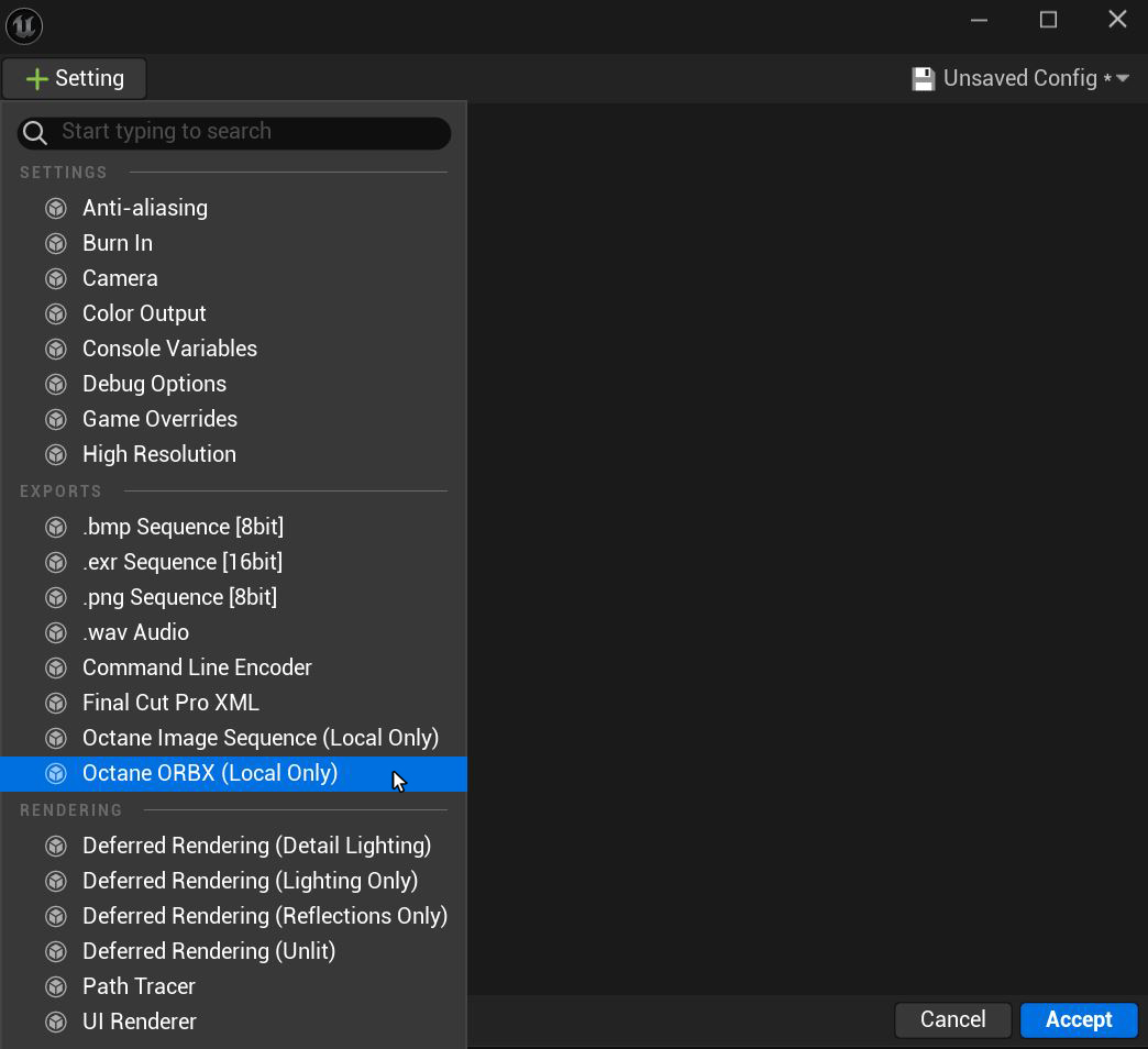

Clicking on Unsaved Configuration will open the render settings. An Octane ORBX (Local Only) export option can be added by clicking on the +Settings button (figure 5).
Figure 5: Adding the Octane ORBX export to the configuration

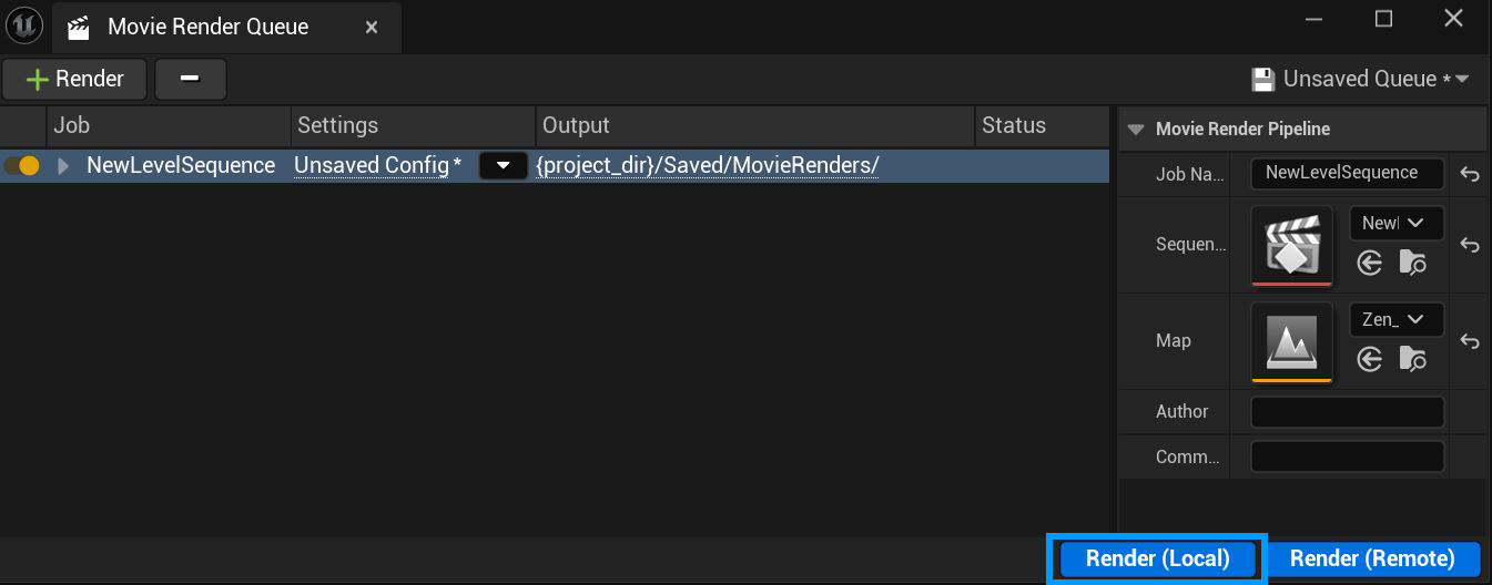

Once this has been added, clicking on the Accept button will close the window and the ORBX export can be executed by clicking on the Render (Local) button in the Movie Render Queue window (figure 6). The exported ORBX file will be located in the location specified under the Output column.
Figure 6: Rendering an animated sequence to ORBX from the MRQ window

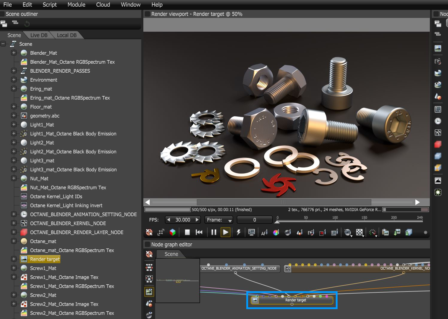

It is good practice to open the ORBX file in Octane Standalone to make sure everything from the Unreal Engine scene is exported properly. To check for rendering issues inside of Octane Standalone, click on the Render Target node in the Node Graph Editor window (figure 7).
Figure 7: Activating a render in Octane Standalone by clicking on the Render Target node
If the exported ORBX file contains animation, the timeline will be visible in the Standalone Render Viewport window (figure 8).
Figure 8: The Render Viewport timeline
